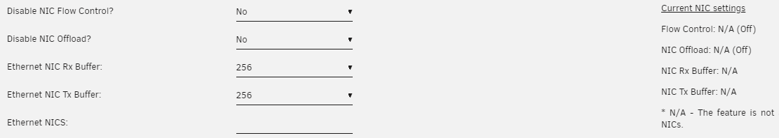

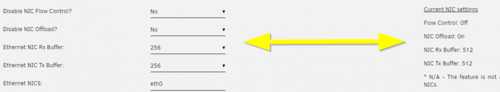

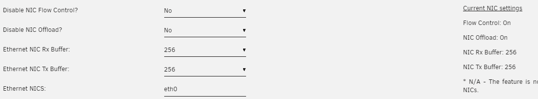

After an update of tips and tweaks and rebooting my machine several days later this bug (?) appeared again (this time my unraid server was not accessible through the local network, too):
My "eth0" is a QNAP 10G RJ45 PCIe card and it seems that it is not compatible with the buffer/flow control setting made by Tips and Tweaks.
I think the plugin should not pre-fill the "Ethernet NICS" field with "eth0".
How could I find/debug the ethernet settings made by Tips and Tweaks? Maybe I can find out which setting causes the "offline problem"?

6 hours ago, dlandon said:
I guess the update filled the field with "eth0" but does not apply the setting as long the server isn't restarted. And it must be this setting as I can reproduce it.
I've added a 'Default' selection in all NIC settings that will not apply the setting to the NIC.  This will keep the plugin from making any changes to the NICs for that selection.

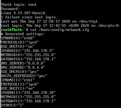

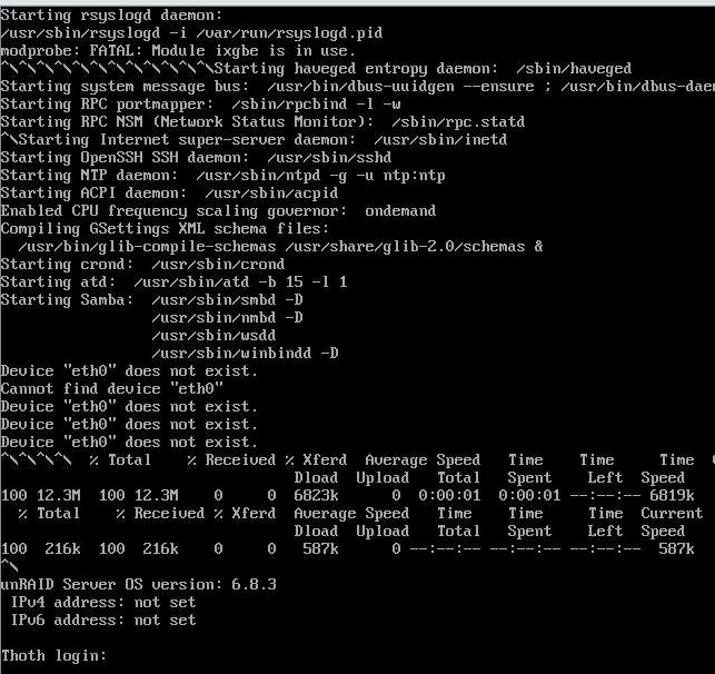

Something is really strange with my NIC settings. I restarted my server and it has connection through one 10G and 1G port. Then I try to apply the following default settings by adding "eth0" to "Ethernet NICS":
After that I'm not able to reach the server anymore. Not through the 10G (eth0) and not through the 1G (eth1) port (both have different static IPs). I mean if my 10G card does not support this setting, why isn't the server reachable anymore through the 1G port (eth1)?!
So I tried it through the server itself. Login with root and entered the following:
Then re-applied the network settings:
Now I'm able to open the WebGUI through both ports again. I opened the Tips and Tweaks NIC settings and it shows the following:
Now I reboot unraid through the GUI. The terminal says "eth0 does not exist":
Checking the GUI. 10G offline, 1G online.
Rebooted again (without making any changes). No errors shown in the terminal. 10G and 1G are both online. So I re-checked the TipsAndTweaks page and now the status is different?!

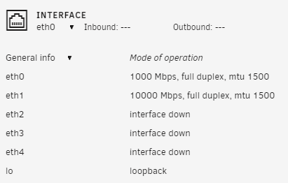

I opened the status page and something reversed my eth-order (usually eth0 was the 10g card):
network.cfg looks as usual:
root@Thoth:~# cat /boot/config/network.cfg

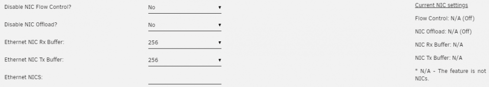

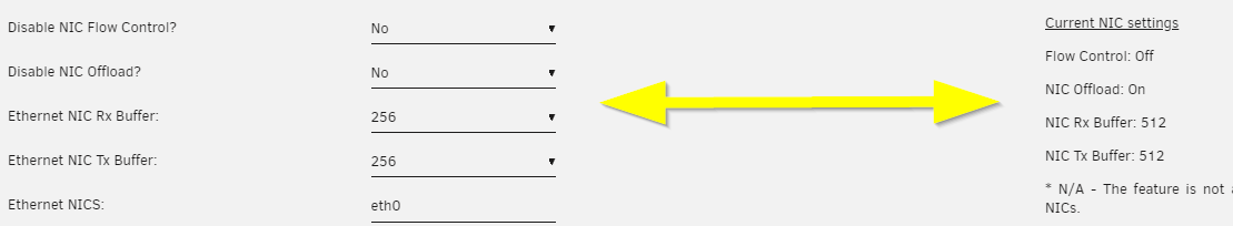

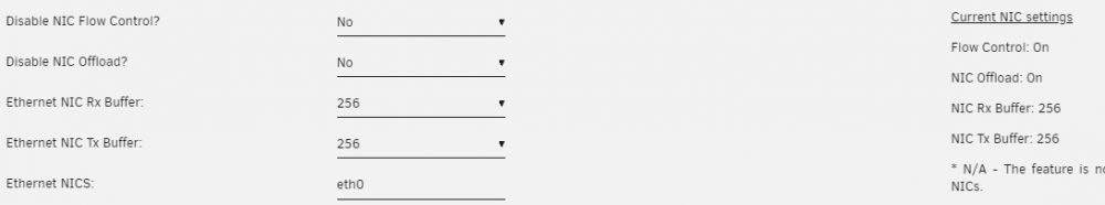

EDIT: After several reboots and re-applying the 10G as eth0:
I never set those values. This is really strange.
Edited by mgutt
You should set the NIC settings to 'Default' so none of the settings are applied.  Leave the default settings.  Tips and Tweaks was designed to work with Intel NICs and other brands might not respond to the NIC parameter settings.
That would be something with Linux.  Tips and Twaeks has nothing to do with the naming of NICs.

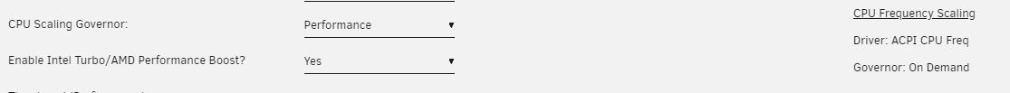

And there is another thing different now. The CPU goverener is not set to "Performance" anymore:
The driver is showing as ACPI.  Performance does not work with the ACPI driver.  What processor do you have?
Looks like a timing issue.  When you apply the settings will it change?
