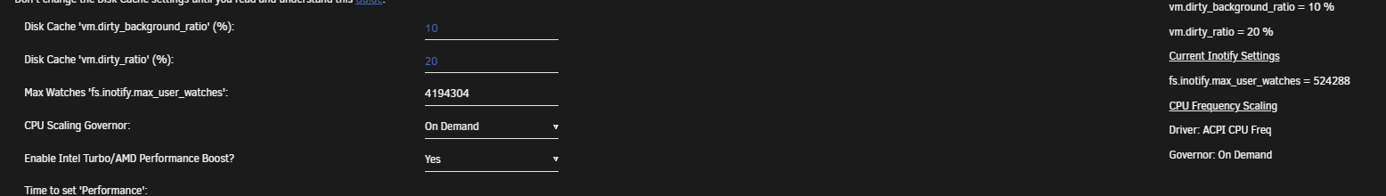

I really hope someone will help me as this is my third post regarding this issue. I have been reading and wrapping my brain trying to to change the Max Watches 'fs.inotify.max_user_watches' variable. I started trying to use the terminal using the following command:
sudo sh
echo  fs.inotify.max_user_watches=4194304  >> /etc/sysctl.conf
sysctl -p
This ended up just adding fs.inotify.max_user_watches=4194304 to the sysctl.conf and did not replace the variable. After reading a bunch of forum posts regarding the issue I was directed towards using the "tips and tweaks" plugin. Setting this variable to 4194304 did not actually change anything. I also tried 999999, 1048576, and 2097152. Realizing I needed to probably restart the server for the changes to take effect I restarted. I am still showing the default value in the terminal and tips and tweaks.
Here is my original post on the Plex Linux Docker:
https://github.com/linuxserver/docker-plex/issues/291
Unraid Forums Post:
Any assistance would be appreciated!
I don't know if you adding the line to sysctl.conf has changed something (of it it would even survive a reboot), but I, too, needed to change the setting and used the Tips n Tweaks plugin to do so. Mine is currently set (in the plugin gui) to 2097152, and it shows on the right side of that page under 'Current inotify settings' as the same number.
Sorry I can't be more helpful.

When I change the setting and hit apply. The setting does change on the right. However, it changes back on reboot. I am not sure if that is by design.
Finally, when set through this GUI how can you confirm it is applied? When I apply the setting, it shows in the GUI on the right side but did not show in the terminal when running sysctl.conf -p.

Yeah vi was a dumb mistake nano was the way. I was able to set the value in both the conf and tips and tweaks. This setting however, does not survive a restart of the system. Not a big deal but I want to ensure the setting is actually working. Does anyone know of a way to do this?
Just checking that you saw my edit above?
System files are moved from the system flash drive to ram at boot and won't persist after reboot, so I think leave the value in sysctl.conf as-is (I'm assuming after a reboot that it reverts to default, so looks like mine, above (with some other stuff below it). If so, reboot, then try setting it in T&T one more time, then once again rebooting to see if it sticks (this time you will be doing it just in the one place, so maybe that's just what it takes - I may be hopelessly optimistic in this case, though).
If not, I'm clean out of ideas.
The only way I know how to check is on the right side of the T&T page.
Here is what I tried doing. After restarting the server, tips and tweaks had it set to 4194304 but on the right it was the default. Opening the file in the terminal also showed the default (and showed a default conf file with no extra parameters - seems to have reset the conf upon restart). After inputting 4194304 again tips and tweaks showed the number on the right. This does not persist when I restart but honestly not a big deal if its working but I do not know a way to confirm this until plex tries to detect intros on an EAC3 audio file. Which was the original reason I went down this rabbit hole.
Edited by ItsRaining
Any changes to sysctl.conf will not persist on reboot.  What Tips and Tweaks does is to issue a sysctl command to apply the 'inotify.max_user_watches' value.  When you change the value in the UI, the value is changed as you've seen.  When the system is rebooted, the value saved in the config file is re-applied.
I've run several tests and it appears to be working fine, even on a reboot.  Confirm you see this line in your log:
Nov 30 11:12:37 BackupServer tips.and.tweaks: Tweaks Applied
That means that the Tips and Tweaks has been applied.  If you don't see that in the log, post your diagnostics and I'll see if there is an issue with Tips and Tweaks on reboot.

Tips and Tweaks applies the saved tweaks in the tips.and.tweaks.cfg on reboot so it does persist when using Tips and Tweaks.
Good to know. I will restart to confirm its persisting then. So far it has not persisted but I was messing with sysctl.conf.
Update: The issue I am having where plex is unable to scan the EAC3 audio files is still persisting and the inotify.max_user_watches stays at 512k. Leading me to believe the value is not setting for Unraid. Going to try and reach out to Unraid support because I have not been able to get this working since day 1 on my server.

I am following up with you on this as requested by Unraid support.  512k is a bit of a strange number.  The default setting for 'fs.inotify.max_user_watches' is actually 524,288.  I suspect something is resetting the value after Tips and Tweaks sets it.
So let's do this:
- Post your diagnostics as they are right now.
- Reboot your server in safe mode.
- Check the value of 'fs.inotify.max_user_watches'.
I am sorry I meant to say 524288. The default value.
I have issued an update to the plugin.  The application of tips and tweaks values will occur now later in the start up process.  What I think might be happening is tips and tweaks applies the settings before Unraid is finished initializing.
Update to the latest release and see if the settings get applied correctly after a reboot.
I noticed the update. Sorry for the late response I have been working overtime before the Holiday. This weekend I am performing server maintenance and will restart the Unraid server a couple times. I will report back if the value persists after restart. Thank you!
I would like to confirm that the value is persisting after restart. I have restarted my server three times during maintenance today. I have another 1 hour maintenance window tomorrow to replace a drive and will do another restart or two to confirm today wasn't a fluke.
