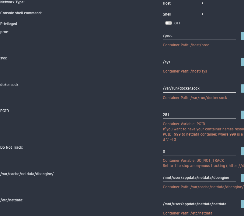

    Following the info in the first post set up a new path in the docker setup page like this:

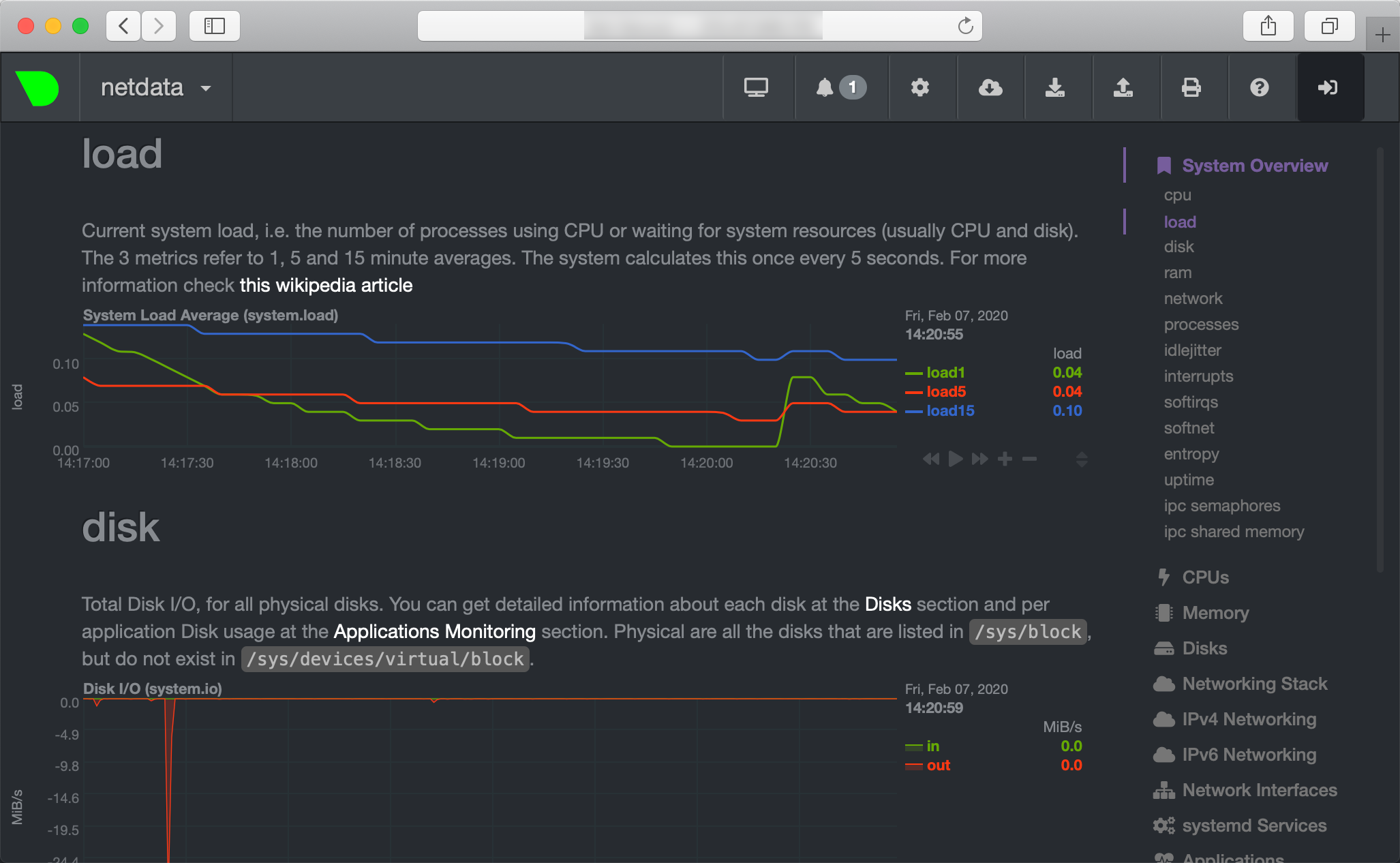

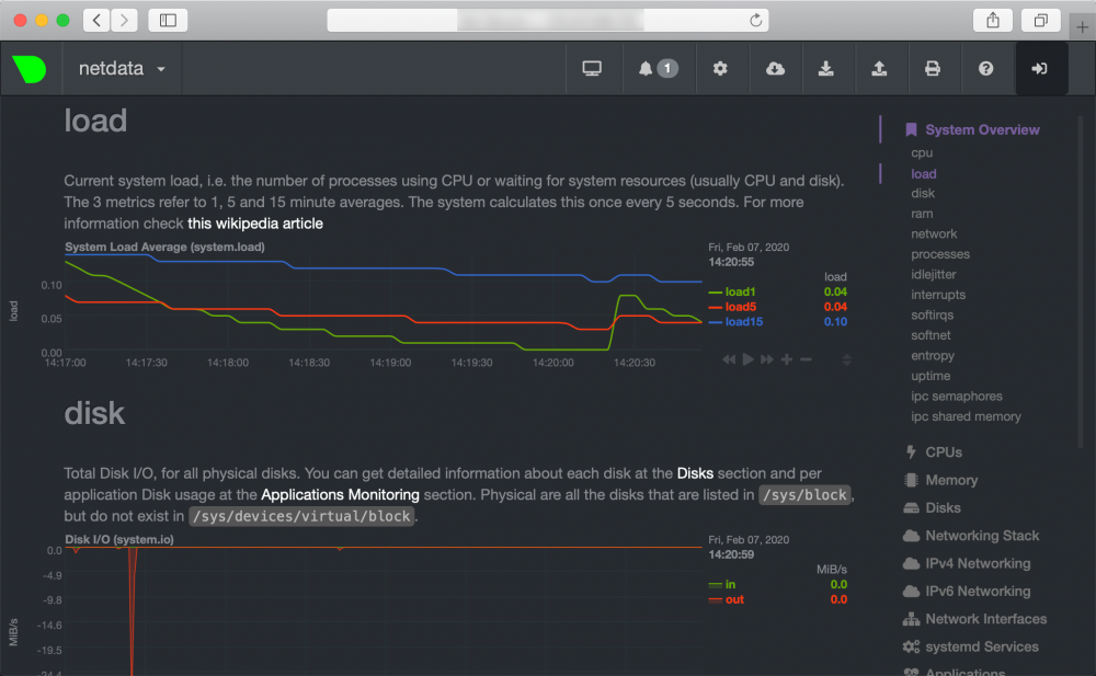

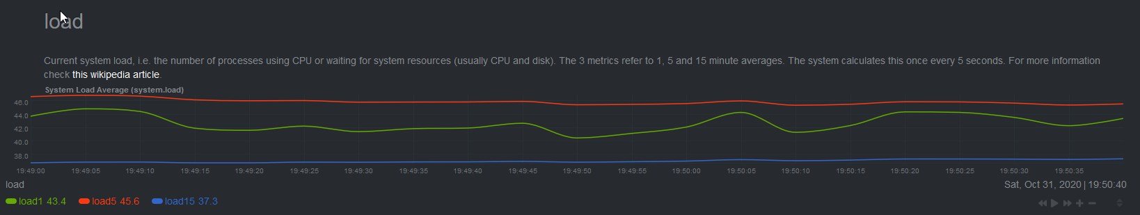

I just updated netdata and now my graphs are messed up. The values for each datapoint are now on the left side under the graph instead of on the right side beside the graph. Making it virtually impossible to see the actual values of the graphs at a glance.
This is what I have now:
This is what it used to be and should be:
How can I change it back?
1 minute ago, Squid said:
By complaining to https://www.netdata.cloud/
So this is how it is supposed to be now? And no way to change the layout? That is silly.
Anyone know what version this changed in? I had not updated in some time so not sure when the change happened. I guess I will just revert to the older version that has the other graph layout, this new setup is useless by comparison.

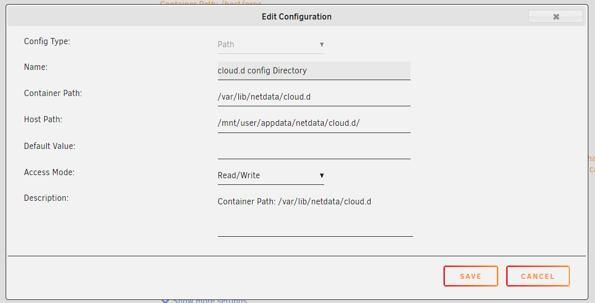

I claimed my unRaid netdata into my netdata cloud to access all data in web.
The config directory of that cloud connection is not mapped into the host so it is lost on every restart.
To repair this you could do the following:
set up a directory under appdata/netddata/cloud.d, then map it to the container path /var/lib/netdata/cloud.d
See the picture for help.
If somebody already mentioned this, nevermind ;-)
