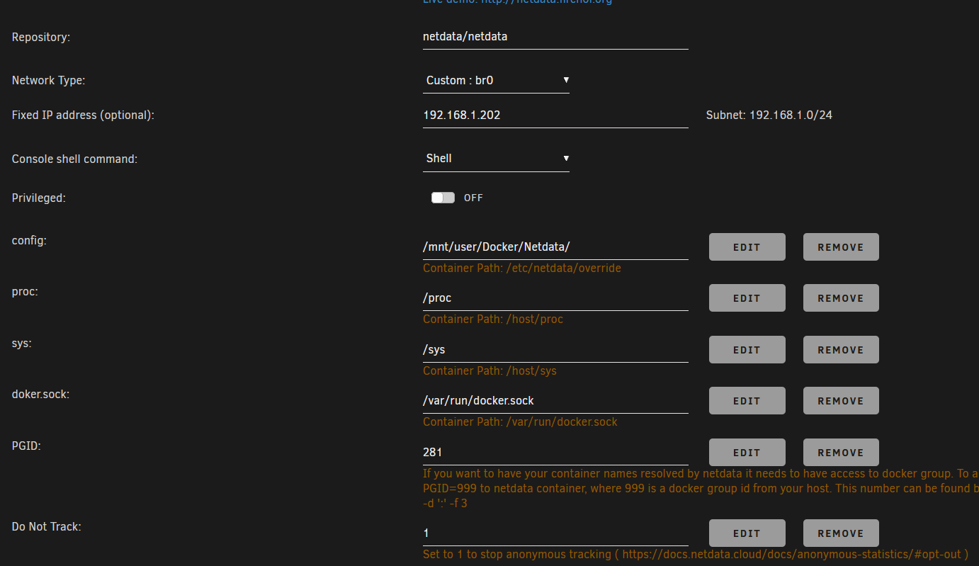

    Following the info in the first post set up a new path in the docker setup page like this:

Hey guys,
Loving the netdata container and having fun playing with it. Currently trying to get the back end configuration for getting data into influxdb, so I can talk myself into out of buying a new CPU by having data to back up my hypothesis I am smashing my CPU.
I have got the netdata.conf file from http://{localhost}:19999/netdata.conf and edited it to contain the following:
[backend]
	# host tags =
	enabled = yes
	data source = average
	type = graphite
	destination = udp:10.0.0.2:8086
	prefix = netdata
	hostname = Tower
	# update every = 10
	# buffer on failures = 10
	# timeout ms = 20000
	# send names instead of ids = yes
	# send charts matching = *
	# send hosts matching = localhost *
I then saved this to /mnt/cache/appdata/netdata/netdata.conf (which is what I have mapped to /etc/netdata/override), and restarted the container.
However it doesn't seem to be picked up, and when I then do http://{localhost}:19999/netdata.conf again, it is set to the defaults.
I have a feeling that I am missing something stupid, but for the life of me I can't work it out. I have tried remapping /etc/netdata/override to a different location, as well as using vim to create the file rather than saving it locally and then dropping it into /mnt/cache/appdata/netdata/ location.
Any help would be greatly appreciated!
A while back this template switched to using the official Netdata Docker Image netdata/netdata. The official image does not have the /etc/netdata/override feature that was present in the old titpetric/netdata image. Try mapping your config folder to /etc/netdata directly (/mnt/cache/appdata/netdata -> /etc/netdata). I believe that is the proper way to do it now, but if it doesnt work or causes other problems try mapping the file into the container instead -v  /mnt/cache/appdata/netdata/netdata.conf:/etc/netdata/netdata.conf
@szymon @Arbadacarba Did you have a config file mapped in to get UPS support? If so see my answer to @AlexB108 above.

OK, I missed it.
The official docker does not support the override folder that the previous version had.
So if we need config files, we need to mount them one-by-one.
To start with the master config file, get the template from your netdata docker:
wget [your_netdata_ip]:19999/netdata.conf
then edit that file and mount it into the docker:
-v '/mnt/cache/appdata/netdata/netadata.conf':'/etc/netdata/netadata.conf':'rw'
'ro' might be good enough
you can repeat that with all other files that you need.
Sorry, this seems to be the only solution they support currently.
I will remove the override mount from the template now.
