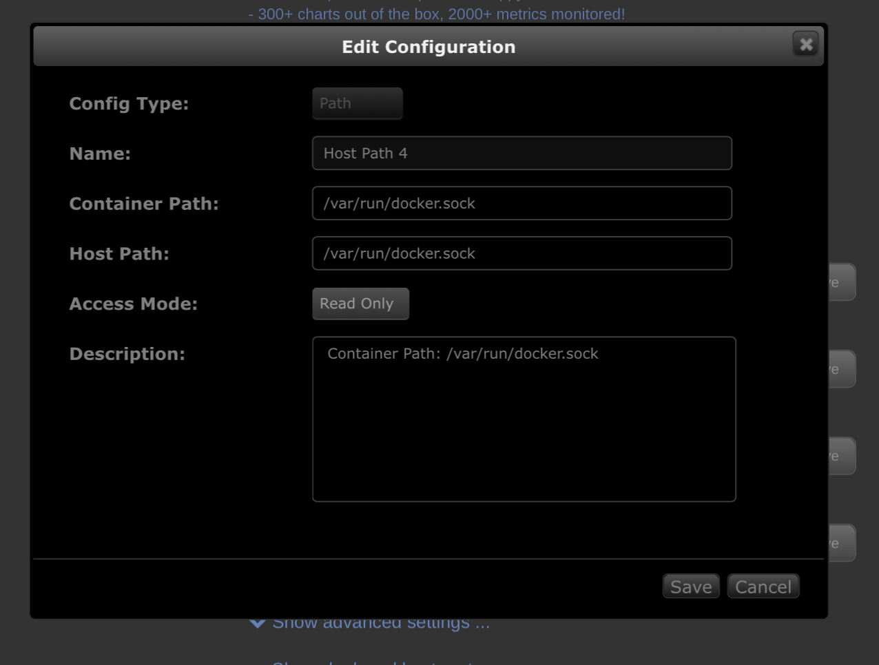

On 2/10/2018 at 9:59 AM, realies said:
Why is `/var/run/docker.sock` suggested to be mounted with write access?
Pretty sure netdata needs write access to request docker container names on the docker socket.
Not true. @L0rdRaiden, map the container `/var/run/docker.sock` file to the host. Read-only would suffice.
Thanks, it works now, I think it just required some time to load, is a pitty that I see the codes but not the name of the application.
You should be able to see the name of the containers.

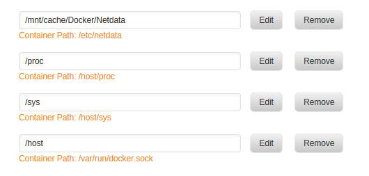

Like this? it doesn't work
Edited by L0rdRaiden

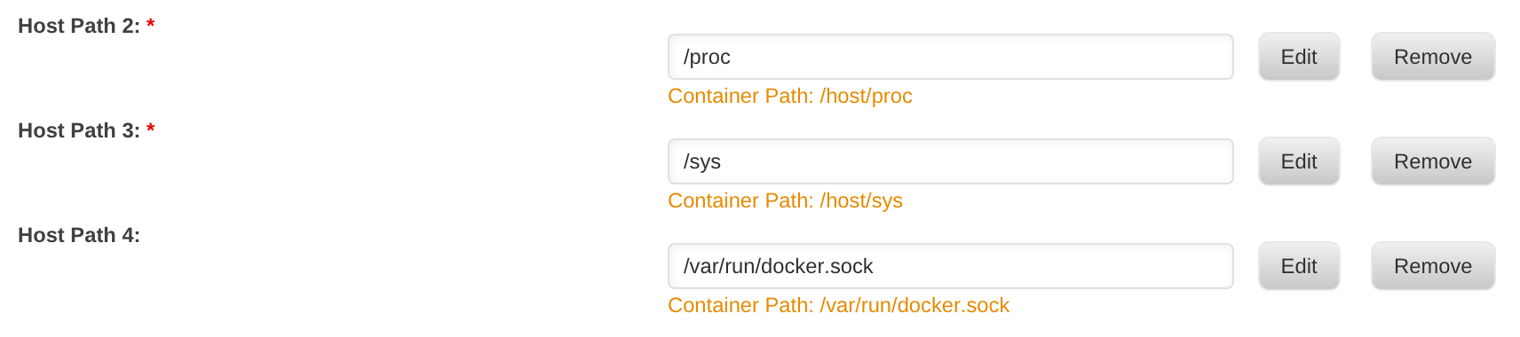

Following the info in the first post set up a new path in the docker setup page like this:
Edited by BillClinton
Added info
I can confirm this works, though it might take a minute or two for the names to appear.

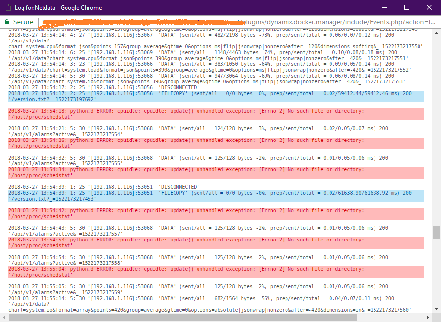

My log is spammed with this error:
2018-03-27 13:53:50: python.d ERROR: cpuidle: cpuidle: update() unhandled exception: [Errno 2] No such file or directory: '/host/proc/schedstat'
Any ideas?
Edited by SirBindy
added picture

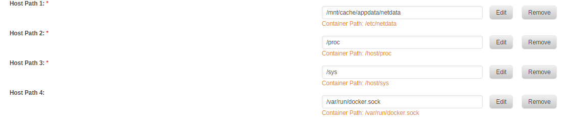

@roland, can we have the `/var/run/docker.sock` read-only mapping in the XML template please?
@SirBindy, your folder mapping is bad. Make it
5abb365c25d83_ScreenShot2018-03-28at07_29_17.thumb.png.6b3b048ba533b5a0b43e720c2e63c669.png

@realies my mappings match your suggestions exactly...
Edited by SirBindy

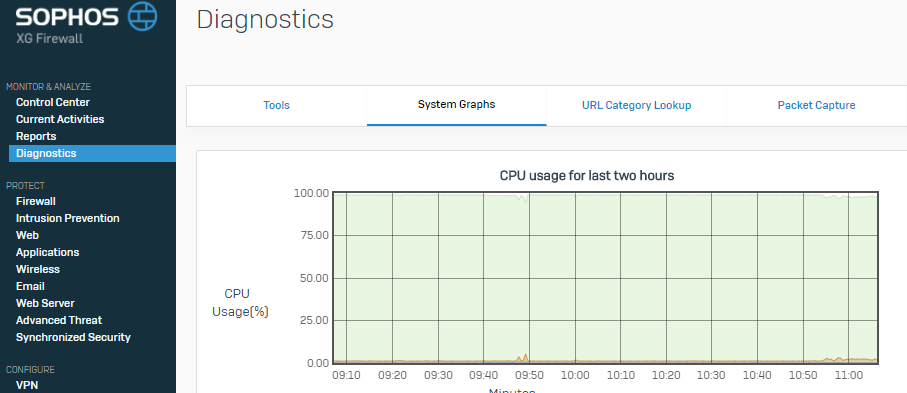

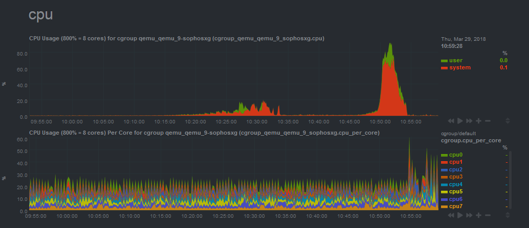

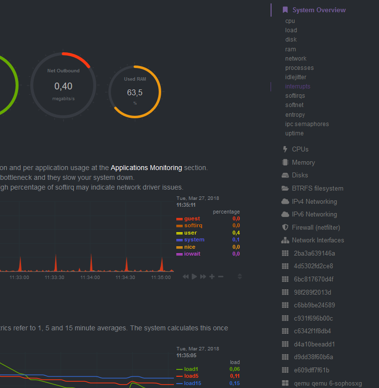

In the docker containers, this 2 graphs produces a perfect match (talking about the netdata screeshot), which makes sense, but in the VM I get what you can see in the picture bellow and it doesn't match with what unraid is reporting (unraid reported and average of 15-20% as much load during the period 10:50 and 10:55, and the CPU report included in the application (SophosXG) running in the VM was reporting almost a iddle load...
Why is this? I don't know what to trust.
I have all the cores assigned to SophosXG and looking at the netdata graphs everything else was mostly idle.

On ‎2018‎-‎03‎-‎27 at 1:57 PM, SirBindy said:
I Have the same errors here. The /host/proc/schedstat file doesnt exist on my system. I was wondering if I need to edit the config file and remove the netdata.runtime_cpuidle to get ride of this spamming message. Any suggestion ? Thx

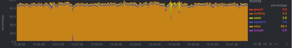

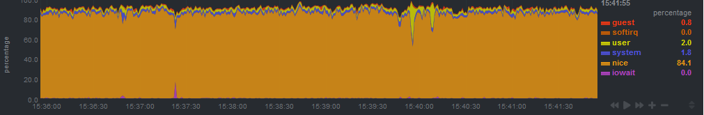

Hey... So I love netdata.  But I have a question about one of the stats it gives.
As per the picture below you can see that "nice" is eating up a lot of my CPU usage.  What is nice?
