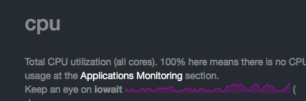

How do I update netdata and setup notifications? webUI says there's an update available but I checked for updates on the unraid gui and t says up-to-date.
Why doesn't Application section work? Nothing happens when I click on it.
And I don't see it on Github to install

hi Lappen71
Do you see the side menu on the right of the screen?
That is where the application monitoring is. It lists the current running dockers. Either with the docker ID string or the name if you have linked up the netdata docker right.
In each application list you'll see how much CPU each application is using.
Hope this helps
Sent from my iPad using Tapatalk

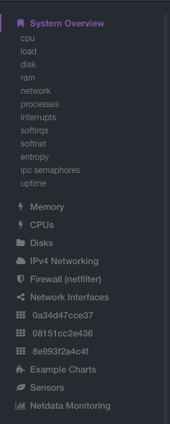

Thanks for the answer but I don't see Application in side meny.
5991a77e718aa_Skrmavbild2017-08-14kl_15_36_30.png.cf5b5fd566b65a37f003d99e0975334f.png
It's those weird numbers. 0a34d...., 08151cc....., 8e993f2.....
Those numbers are shown in your dockers tab in your unraid web GUI
Aha ok ?
