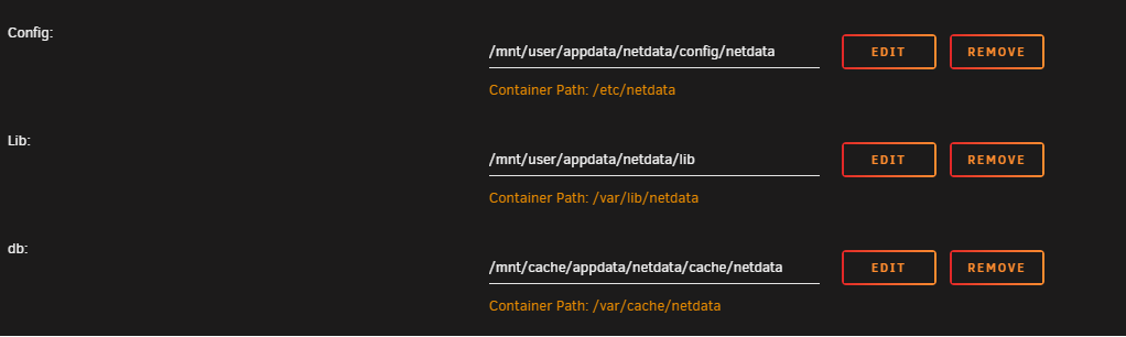

Edit: I changed the permissions on all cache folders(/mnt/user/appdata/netdata/netdatacache/netdata) and now it seems to be working fine. i removed the container and installed it again and the data is still here. i dont know if this will persist through an update or not.
I'll post an update after an update 😁

  • Instructions for fixing data loss after reboot/update edit docker config with these 3 new paths   save the config. stop the container open UNRAID terminal enter the following l

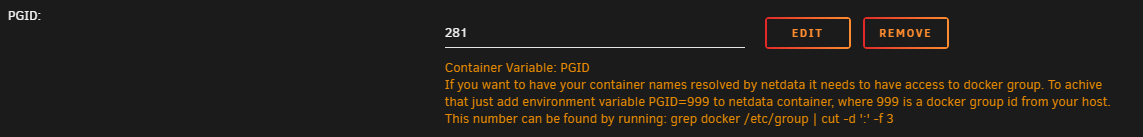

I recently installed NetData, and noticed none of my dockers are showing in the app.  I mainly use a custom br0 for most of my dockers that I expose to NGINX reverse proxy, which I intended to do with Netdata.  If I have Netdata on br0, rather than bridge, is that the reason its not seeing the docker containers?
check your netdata docker config
read the ORANGE words.  dont copy my number 281
save the config.
stop the container
enter the following lines:  (it starts a temp docker of netdata, copies the files to the paths created in the last step, then removes the temp docker)
cd /mnt/cache/appdata/netdata/
mkdir config
mkdir cache
mkdir lib
docker run -d --name netdata_tmp netdata/netdata
docker cp netdata_tmp:/etc/netdata /mnt/user/appdata/netdata/cacheconfig/
docker cp netdata:/var/cache/netdata/netdata-meta.db /mnt/user/appdata/netdata/cache/netdata
docker cp netdata:/var/lib/netdata /mnt/user/appdata/netdata/lib
docker rm -f netdata_tmp
chmod 777 -R /mnt/user/appdata/netdata
you can now start your docker.
Edited by TRusselo

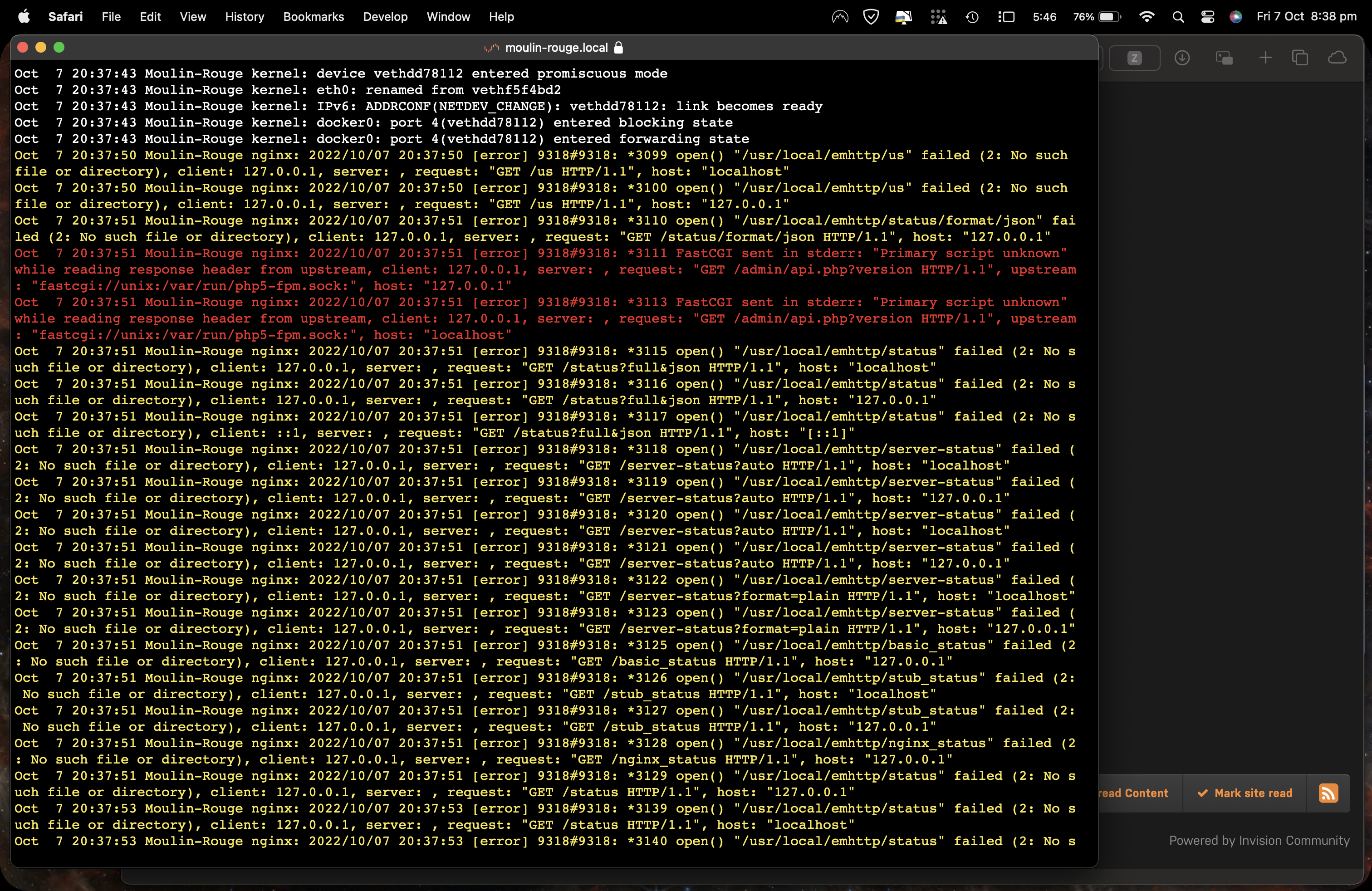

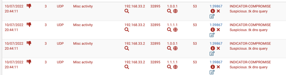

Getting a sh*t-ton of NGINX errors with this docker...
1904760988_Screenshot2022-10-07at20_38_23.thumb.png.6e7fbd1505853f8ea8f95b0ecb0c090a.png

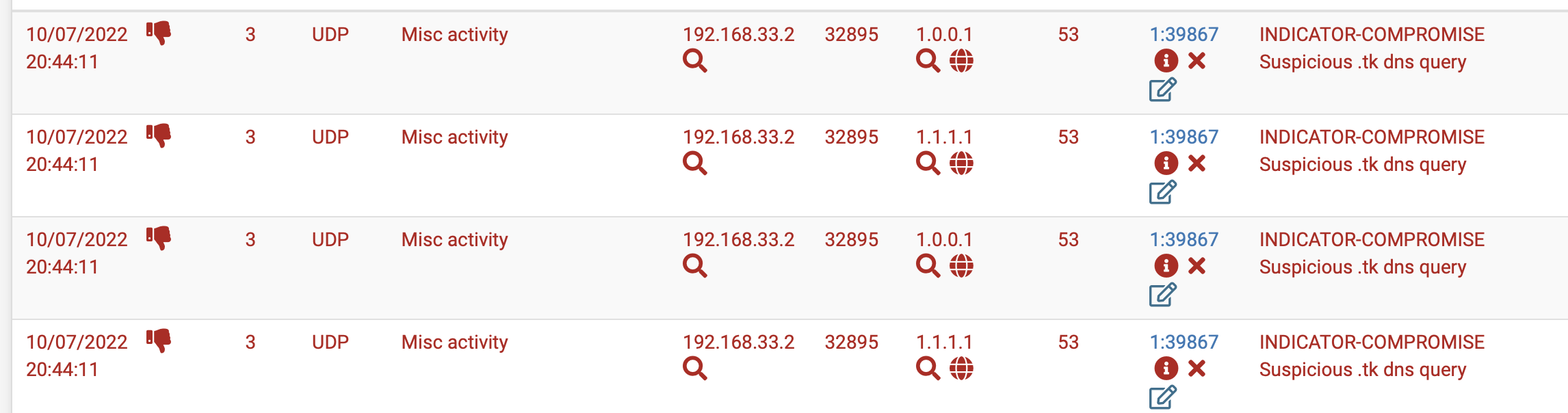

But also suricata packet inspection on PFsence firewall is reporting this docker is trying to connect to a .TK domain name... (can be malware call home) .tk domains can be had for free so are often used for various things.
974047208_Screenshot2022-10-07at21_02_51.thumb.png.f6eccfcb93c2ae1dac3e33d7f1c76c93.png
I have now removed netdata and system is more stable..
It was locking up at night.
Edited by dopeytree
Normal, and probably only show up when starting up the container
@JorgeB indicated the NGNIX Errors weren't normal. They show up through out the day not just at startup. Anyway I have removed Net Data.
Someone else with suricata on PFsence or another packet inspector should monitor the '.tk domains' flags.

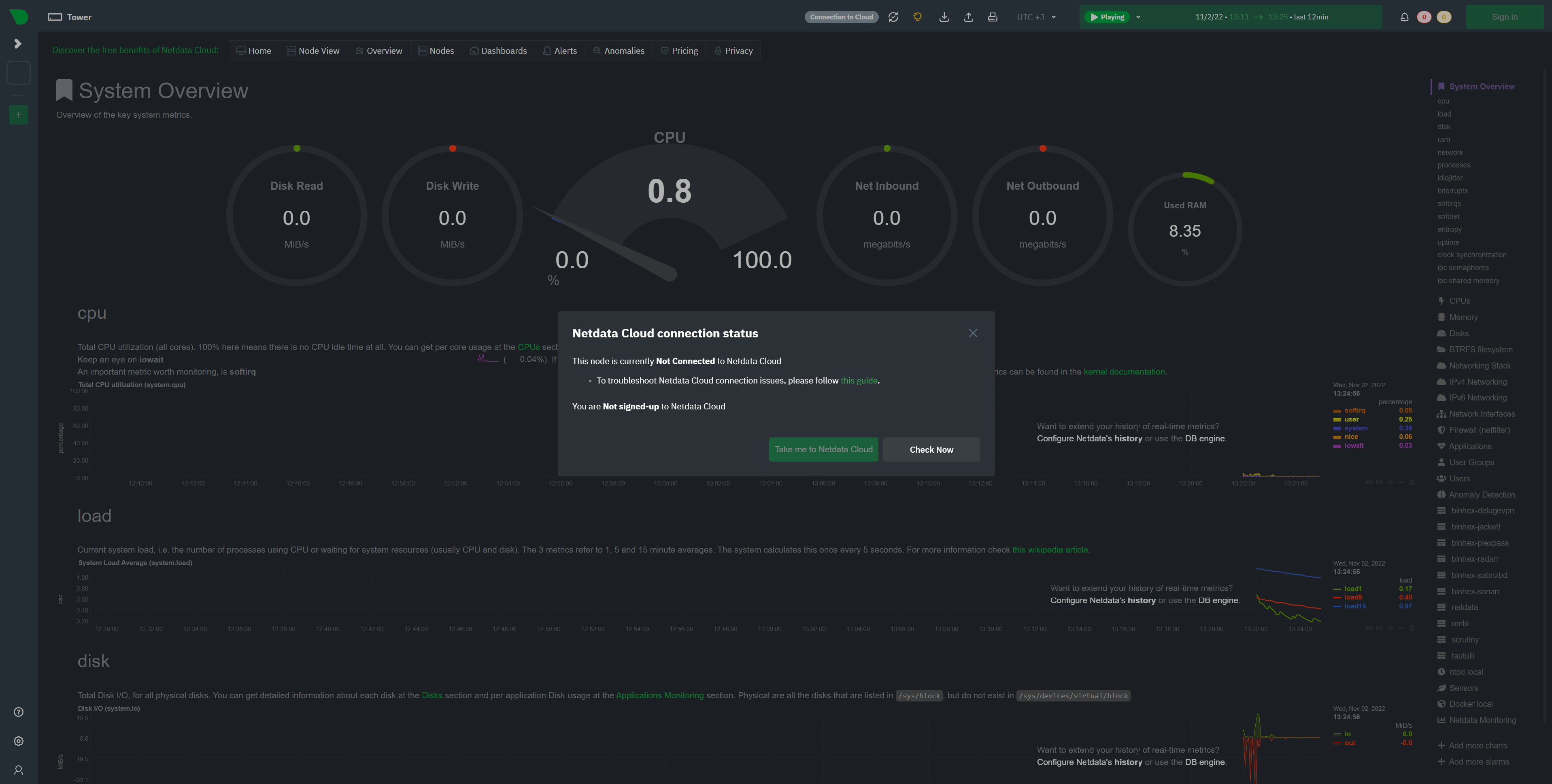

netdata is unable to connect to the netdata cloud. is there a setting i have to change in order for it to get access to the internet?
Hey Mate, did you got it fixed? i tried with creating the new Variables for Claiming but did not work for me.
edit:
i SSH into the docker netapp and entred the script given by Netdata Cloud, and now it seems to work with netdata cloud.
Edited by issabankz
Did someone fix this or know how to fix it? Same problem here, cant connect to cloud with stock netdata install

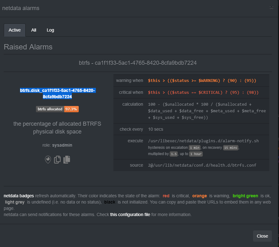

On 5/11/2019 at 10:23 AM, Caldorian said:
Just installed it on a 6.6.7 install, and it's looking good. However, I'm getting an alert in it about my cache drive, saying that the btrfs allocation is 97.3%. However, if I look at my unraid dashboard, it's only around 60% allocated (157GB out of 256GB).
Any clue why this alert is being raised, and how I may clear it?
Did you ever get an answer to this?  I'm getting btrfs 100% on 2/4 servers...?

I'm struggling with the basics here. How to get the node connected to the Could Account? Trying to "Sign in" I get a mail with a link to the Cloud Account, but how to link the node?
Anyone?
