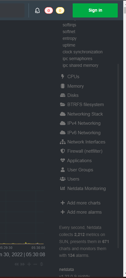

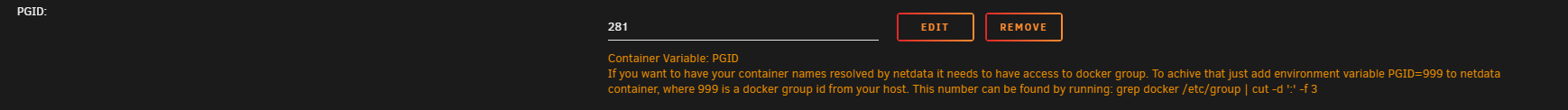

Anyone know why none of my containers are not listed in the right column?
4 minutes ago, opentoe said:
First question. Is this docker in forward development and active?
Yes.  Updates to the container (assuming you're using the official one) are issued on a very regular basis
Make sure your template is current (uninstall / reinstall if necessary) and adjust the number if necessary (shouldn't have to, but you never know)

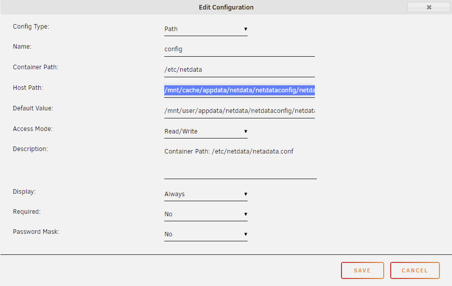

I've got this running well and monitoring my docker containers, but I can't get it to see my customized netdata.conf. In the template I've got:
  • host path: /mnt/cache/appdata/netdata/netdata.conf
  • container path: /etc/netdata/netdata.conf
  • mountain as rw
I've edited the netdata.conf in /mnt/cache, but when I go to ip-address:19999/netdata.conf it shows the default file with everything commented out. What do I have wrong?
22 hours ago, roland said:
There seems to be a different way to do this now.
I have not had the chance to try that yet, but see here:
https://learn.netdata.cloud/docs/agent/packaging/docker/#host-editable-configuration
I guess I'm just too far out of my depth. I followed those instructions, but the netdata.conf I can access on the host is not the netdata.conf that the container is using. If anyone else has or gets this working, I'd greatly appreciate any details on how you did it.
it worked for me.
log on to your unRAID.
keep a copy of your config file.
stop your netdata container
assuming /mnt/cache/appdata/netdata/ is the folder where you store the config.
cd /mnt/cache/appdata/netdata/
mkdir netdataconfig
docker run -d --name netdata_tmp netdata/netdata
docker cp netdata_tmp:/etc/netdata netdataconfig/
docker rm -f netdata_tmp
copy the config file you want to use to
/mnt/cache/appdata/netdata/netdataconfig/netdata
in the docker configuration change the volume that maps the config file to map to the new config directory
restart the container and it should be there.
I only checked the change of the hostname, but that worked fine.
Edited by roland
remove extra picture
18 hours ago, roland said:
it worked for me.
Thank you very much! That worked for me to. I'll have to go back and compare your steps to what I originally did so I can understand what I got wrong.

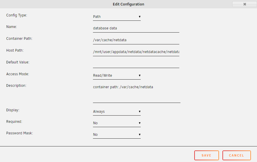

What is the proper way to make my chart data persistent? I already bound the dbengine folder into my appdata. Data persists through a restart of the container, but not an update (and updates are very frequent!).
Also, just a heads up- there is a typo in the OP instructions on mounting netdata.conf (it's misspelled as netAdata.conf on both sides)
I've also been trying to figure this out. Data will persist through restarts, but it's gone after a container update. Do you have to store the data in an external DB to keep it through updates?
fixed now, at least I was consistent
can you please check this and see if that solves it?
I tried that back in April when I first started using Netdata and ran into this issue, and it definitely had no effect. I just changed that setting again and switched back from the stable tag to netdata/netdata to force an update, and lost my history.
I can check to see if history is cleared again for the next pushed update as well, but I'm pretty sure it will be.

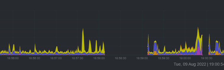

OK, I tried this:
and the result is here:
the first gap was just stop / start and the second was a container update. The history survived an update.
The instructions I had followed were to map the /netdata/dbengine subfolder, not the entire netdata folder -- I will try it the way you show here and let you know if I lose history again tonight. Is this the only change you made from the template defaults?
Also, did you make the "delete obsolete charts files" change or was that not necessary?
Edit - I'm not quite sure how to set this up, the container won't start with this setting ('netdata ERROR : MAIN : Failed to initialize database at /var/cache/netdata/netdata-meta.db, due to "unable to open database file'). Guessing I need to copy the db over manually before starting, but I'm not clear on how to do so
