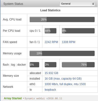

A pretty trivial observation regarding the Dashboard page of the webGUI, but there doesn't seem to be much else to complain about in this release ;) The two rightmost columns in the Load Statistics pane are unbalanced in width, giving odd-numbered CPUs a much longer Per CPU Load scale than even-numbered ones. Also affected is the flash : log : docker percentage used display.
