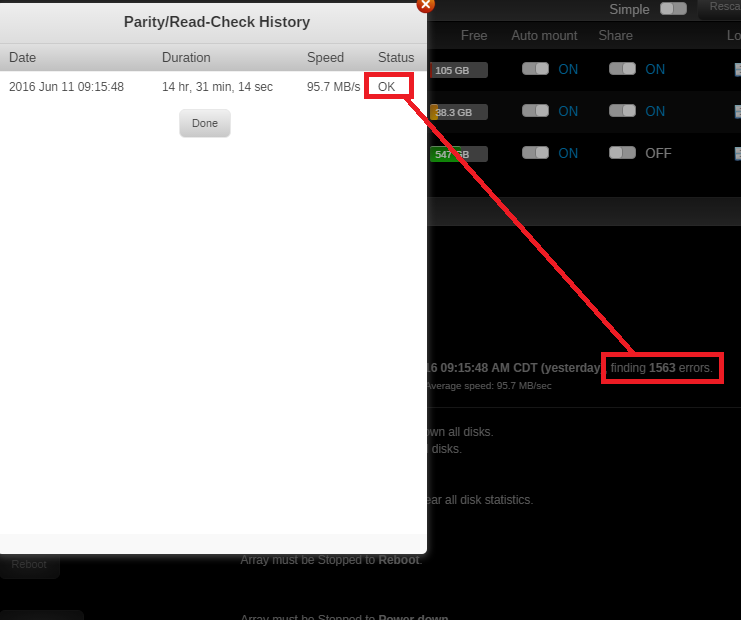

If a parity check finds 1563 errors shouldn't the history status say something other than "OK" in the status?

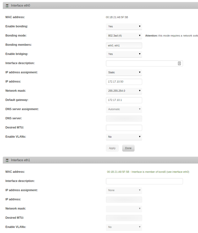

After setting MTU back to default, I am unable to configure a DNS server in the GUI (grayed out, unable to change from Automatic) and still unable to talk to Github or ping google.com
Post a screenshot, sounds like something not set right.
Network attached. Have tried multiple reboots. This configuration worked before upgrading to Beta23 (came from Beta21).
MTU9000 worked before upgrading to 6.2, others have reported it broken. Switch is configured fine (PowerConnect 6248), and I can access WebGUI and SSH no problem.
EDIT: I manually added nameserver 172.17.10.1 to my /etc/resolv.conf and this allows me to ping google, but interesting how I cannot configure this from GUI. I also assume this will not survive a reboot. Have not yet tested with MTU set back to 9000.
Looks like a remnant of your previous configuration.
- Switch the setting for IP assignment to "automatic", this will enable the setting for DNS.
- Now you can change DNS setting to static and enter the desired IP address(es)
- Switch IP assignment back to static
You will found detail in "Tools" -> "Archived Notifications", it will show 0 or XXXX errors.
