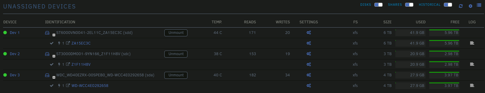

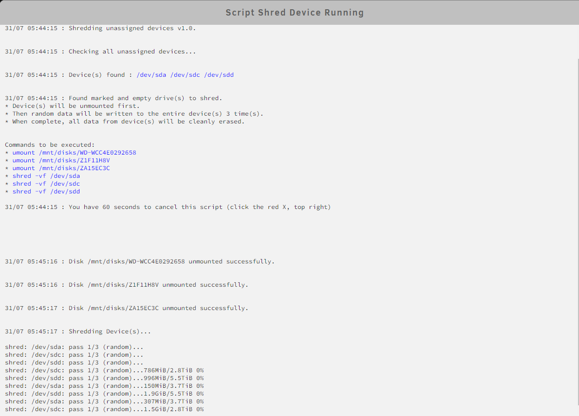

#!/bin/bash
# The purpose of this script is to remove every trace of the data that was once on a device (aka data shredding), so it can be discarded or sold. Multiple devices can be shredded simultaneously (not one after another).
# How the script works :
#     - Using the Unassigned devices plugin, format and mount (if needed) the devices you want to shred.
#     - If any data remains on the devices, remove it completely.
#     - Create a "shred-me" folder on each device you want to shred. Any other device will be ignored.
#     - Launch the script via the "User Scripts" plugin (preferably in background) or via CLI.
#     - A list of the devices correctly prepared for shredding will be displayed.
#     - Devices to shred will be unmounted, and won't be remounted after shredding.
#     - Shredding will then start on all relevant devices simultaneously. Progression will be visible in real time for each device.
#     - A notification will be sent on completion, using Unraid notification system.
# Version 1.0 - This is a script by user Majyk Oyster on forums.unraid.net. Some elements of RobJ's Clear An unRaid Data Drive were used.

funDisplay "Found marked and empty drive(s) to shred.
\t* Device(s) will be unmounted first.
\t* Then random data will be written to the entire device(s) $passes time(s).
\t* When complete, all data from device(s) will be cleanly erased."
echo -e "\n Commands to be executed:"
for diskToShred in $disksToShred; do
	echo -e "\t* $colorStart umount $diskToShred $colorFinish"
done
for deviceToShred in $devicesToShred; do
	echo -e "\t* $colorStart shred -vf $deviceToShred $colorFinish"
done
if [[ "$scriptDir" == "$userscriptstDir"* ]]; then # running in User.Scripts
	funDisplay "You have $wait seconds to cancel this script (click the red X, top right)\n"
	sleep $wait
else #running from CLI
	funDisplay "Press ! to proceed. Any other key aborts, with no changes made. "

Your devices to shred should look something like that before using the script (formated, mounted) :
Here's how the script looks like in User Scripts :
