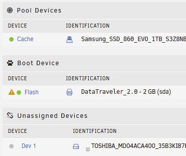

If the Media share uses a pool disk, then there should be a /mnt/myPOOL/Media folder which has the Movies folder in there.
Hi Meles.... in my case, my pool only contains "cache"... I have a single cache drive. What can I change on your script to reflect this?
Thank you.

I think i've worked out what the issue you're having is...
I'm guessing that your array is encrypted?
Therefore your disks are named like this
/dev/mapper/md1                12T  119G   12T   1% /mnt/disk1
/dev/mapper/md2                12T   84G   12T   1% /mnt/disk2
/dev/mapper/md3                12T   84G   12T   1% /mnt/disk3
the script was originally written on my other unRAID server which doesn't have encrypted disks, therefore the disks are like this...
/dev/md1         12T  7.3T  4.8T  61% /mnt/disk1
/dev/md2        8.0T  5.2T  2.9T  64% /mnt/disk2
/dev/md3        8.0T   56G  8.0T   1% /mnt/disk3
/dev/md4        8.0T  5.5T  2.6T  68% /mnt/disk4
/dev/md5         12T  6.4T  5.7T  54% /mnt/disk5
the line in the script which does the "work out what disk has most space on" was just looking for /dev/md originally...
here's a modified version of the script (also tarted up somewhat)

Hello everyone,
I understand that we can get the running status of UserScripts inside Unassigned Device.
But do you now if it is possible to automatically launch a userscript when a device is connected ?
I backup all my NAS with spare hard drives and create a few userscripts to launch some rsync.
Thanks !
