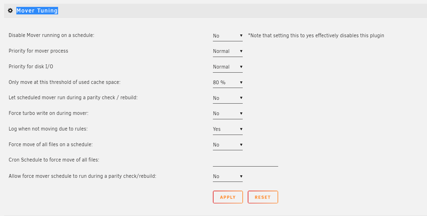

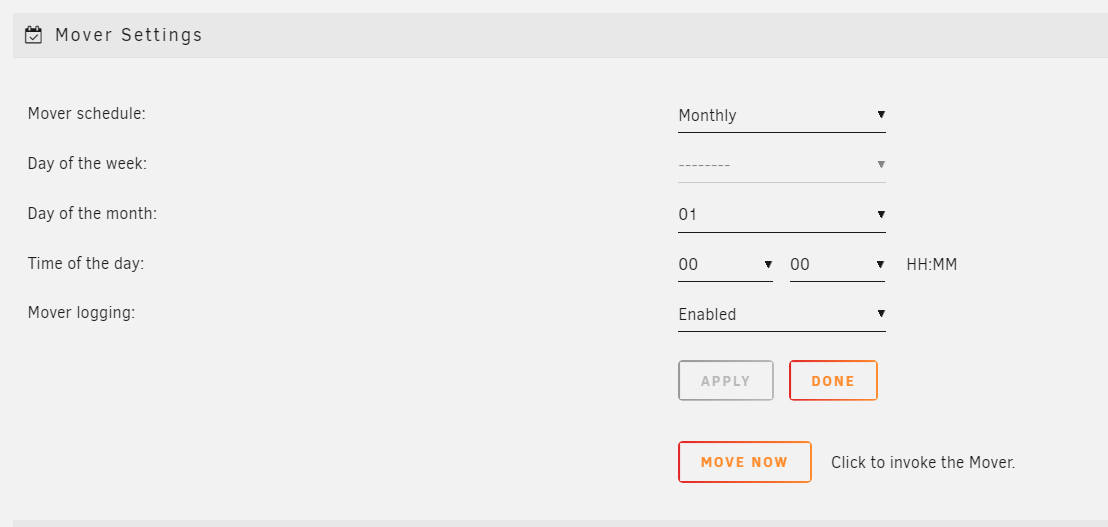

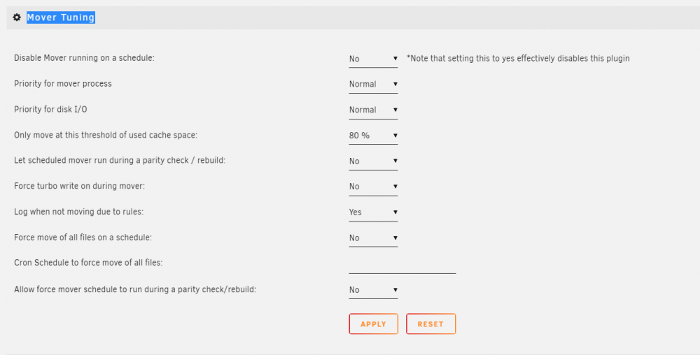

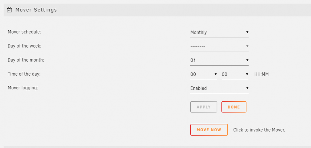

I just added this script and set it to 80% and run hourly. The question I have is what do you set the Mover Settings in http://Server/Settings/Scheduler set to? it looks like it cant be disabled so I assume you max it to monthly maybe?
I would use the mover tuner plugin instead of the script.
Ok, just installed it... looks like the same question still exist for this new plugin right?
You set the mover schedule to be as often as you want the plugin to run and apply it's rules.  If you want at some point mover to move all the files then you set that custom cron schedule down at the bottom of the plugin's settings (or run mover manually)
OK I get it now, thanks. If I set the default settings to run every hour or every day, when it triggers, it won't just start moving, it will check the plug in add on and then only move if the size is greater than 80% of the disk.
