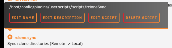

On 4/28/2021 at 4:45 AM, p.wrangles said:
Does anyone know if its possible to remotely execute a user script? Im looking to have Home Assistant remotely (using ssh) call a User script to stop or start docker containers when different things within the system happen (For example when someone begins to watch Plex - shut down my Tdarr Node - or when i have finished gaming on my Unraid Gaming VM - shut down my 3 core plex and start up my 5 core plex etc.
just invoke it like this
bash /boot/config/plugins/user.scripts/scripts/rcloneSync/script
where rcloneSync is the name given to the user script.
However, this name might be different from the current name because renaming a user script doesn't change the directory the script is in in which case you need to mouse over the gear icon in the User Script settings until the settings menu opens

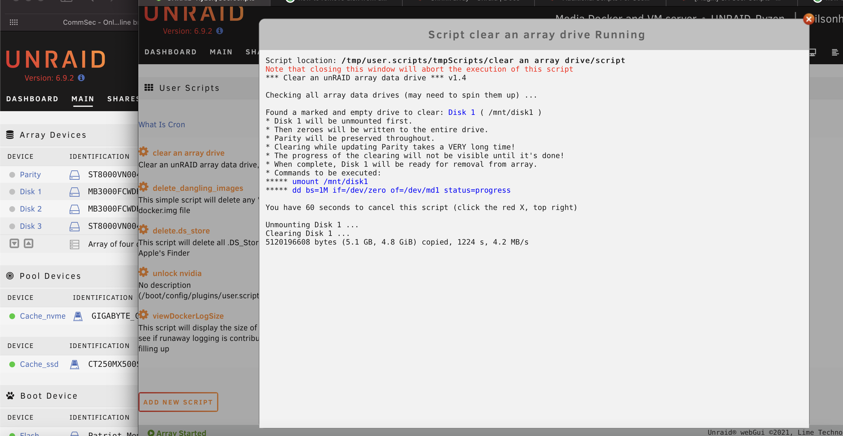

On 12/27/2020 at 11:09 AM, JorgeB said:
That script is very slow with recent Unraid releases, and the author has not been in the forums for a long time, but you can still do the procedure manually.
I have the same problem, the write speed is only 6MB/s, at this rate it will take 34 days to finish clearing the drive...
How do I stop the process? I can't find any `dd` running.
Thanks!
EDIT : looks like there is no way to interrupt the script so I'll just reboot the server.
EDIT2: rebooting makes Unraid waiting for the script to finish.....
EDIT3: it finally timed out

I tried to use "Clear an unRAID array data drive" but I couild not figure out how to put files on the flash drive.
I clicked "Add a new script" so I wa able to give it a name, and I think it automatically created a folder on the flash drive in the config/plugins/user.scripts/scripts folder.
I downloaded the "description" and "script" files to my Windows 10 machine.  But I don't know how to put them in the unraid flash drive in the config/plugins/user.scripts/scripts folder.  When I use Krusader, and go to FLASH it says, "Error: Cannot open the folder /FLASH".  And even if i could open it, how do i move the file from Win10 to unraid flash?
Edited by xrqp
You could shut down, put the flash in your Win10 computer, and work with it there.
or just click edit script, open the file in a editor locally, copy/paste in there ...
or mount the flash drive ... but may rather stick with copy, paste
trurl, Thanks.  What you suggested sounds like something I can do.

On 9/4/2016 at 9:36 AM, RobJ said:
Clear an unRAID array data drive  (for the Shrink array wiki page)
This script is for use in clearing a drive that you want to remove from the array, while maintaining parity protection.  I've added a set of instructions within the Shrink array wiki page for it.  It is designed to be as safe as possible, and will not run unless specific conditions are met -
- The drive must be a data drive that is a part of an unRAID array
- It must be a good drive, mounted in the array, capable of every sector being zeroed (no bad sectors)
- The drive must be completely empty, no data at all left on it.  This is tested for!
- The drive should have a single root folder named clear-me - exactly 8 characters, 7 lowercase and 1 hyphen.  This is tested for!
Because the User.Scripts plugin does not allow interactivity (yet!), some kludges had to be used, one being the clear-me folder, and the other being a 60 second wait before execution to allow the user to abort.  I actually like the clear-me kludge, because it means the user cannot possibly make a mistake and lose data.  The user *has* to empty the drive first, then add this odd folder.

 I was trying to shrink my array. I followed the instructions here. I started "clear_an_array" script, and kept the window open for more than 24hrs now. There is no progress showing anymore, and all disks in the array sprung down already. Am I safe to close the script window and proceed to the next step ("Go to Tools then New Config")?
649624128_ScreenShot2021-09-13at5_23_27pm.thumb.png.76c250e6e617c64e1baa5c4f24d3fcee.png
