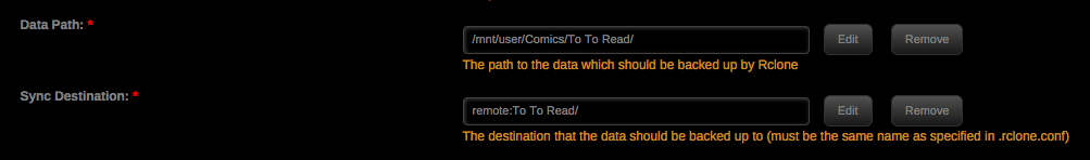

Hi everyone. I've set up Rclone and gotten the authorization token for OneDrive.
I've attached my config below:
index.php?action=dlattach;topic=52033.0;attach=39492;image
Right now there is nothing in the data path, it's a folder I just created on unRAID.
The sync destination "remote:To To Read/"  refers to the "To To Read" folder in the root of my OneDrive.
1) When I run Rclone, what will happen? Will Rclone copy the files from sync destination to data path? Or will it erase everything at sync destination because my data path is currently empty?
2) I don't see a log option when I click on the Rclone docker. How do I see what's going on and if this is working?
The background to what I'm trying to do: I have a OneDrive folder on my laptop and would like to stop using that. I want to have the OneDrive files reside on my unRAID so they don't occupy space on the laptop.

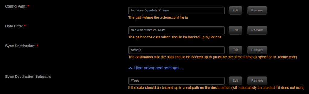

It seems to think /data = /config/ even though I had set it up the data path to be /mnt/user/Comics/Test/ ?
index.php?action=dlattach;topic=52033.0;attach=40836;image
And $SYNC_DESTINATION:/$SYNC_DESTINATION_SUBPATH always appear as :/ in the actual command.
I hope this helps, I'm very confused.

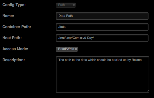

Ok I solved it, it was a silly permissions problem except I didn't know where to look.
I had to edit the settings for the Data Path. Access Mode was set to "Read Only" by default, and I changed it to "Read/Write":
index.php?action=dlattach;topic=52033.0;attach=40890;image
But I had to run it this way: rclone -v sync remote:/Test/ /data which is different from the default format of rclone sync /data $SYNC_DESTINATION:/$SYNC_DESTINATION_SUBPATH
