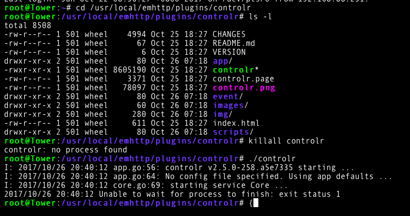

Can you send me the output of
ps aux | grep controlr

It happens on my servers too, but I'm not sure why.
Seems like unRAID is trying to execute the plugin (stop/start?), as part of the startup process?, but the files are still not available.
You could move the stop and start after the bundle remove and install commands.
Method 2 is you could add the emhttp path to the bundle then change the get controlr bundle to this.
This will install it as a Slackware package. It will remove the old and install the new. This will give a warning about makepkg but should work. Then remove these lines
# Remove emhttp files so we can re-install.rm -rf /usr/local/emhttp/plugins/&name;/* 2>/dev/null# Install the 'bundle'.tar -xf /boot/config/plugins/&name;/&bundle; -C /usr/local/emhttp/plugins
Method 3 is you could leave the bundle File section as is, still include the path in the bundle but manually upgradepkg --install-new.
With both methods you can use removepkg to remove the bundle on plugin uninstall.
Also you could use makepkg to create the bundle. This allows you to add install script and package description. If you look at my IPMI-unRAID repo I explain how I make Slackware packages on my laptop. And under Source you can see the layout and the script I use.
