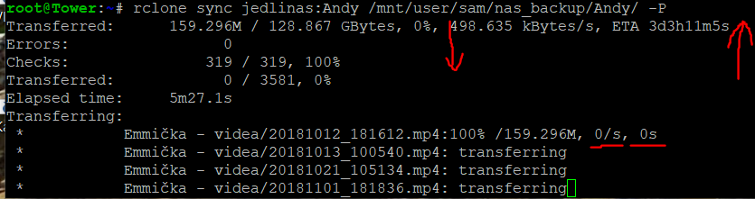

Hello guys. I seem to be facing a strange issue. I tried to search for similar thing in this thread but I failed so I hope I am not repeating the question.
I configured my first ftp remote, set the concurrency limitation to 1 (I need to use strict limitation for one file at once in this case) and when I try to sync content from it to my local share, it always does one random file and it hangs. Like it was waiting fro something. When I run the command with -P switch, I see exactly this - one file looks to be done, rest in the pipeline is not moving, ETA growing, average speed decreasing and current transfer stays 0. Also, Transferred counter is not growing --> thus why I think that it is actually waiting for the previous transfer to be completed while it has been already. Any ideas? Your help would be very much appreciated. Please see the picture below:
This issue is not visible when using SMB - a.k.a. mounting the share and then using sync between two files without any remote.
Thank you.
Thank you.
I'd ask in the official rclone forums. Think you'll get better help to your problem there.

I sorted it out. I ditched the FTP remote approach. Instead I locally mounted SMB share and checking size-only - "rclone sync <smb mount> <local folder> --size-only --transfers 1 --checkers 1" Works like a charm.
