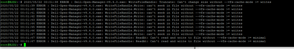

OK so got it installed, configured and setup as a share that can be viewed. When I try and copy something to it tho I get these errors. Any idea what I have done wrong?
Now this is way beyond my programming knowladge - I am a windows server guy 🙂
I have added this command to my mount script --vfs-cache-mode writes
So my mount script looks like
rclone mount --max-read-ahead 1024k --allow-other --vfs-cache-mode writes amazons3:urvault /mnt/disks/amazon &
Does this look right? Files now copy up without any error, but stick on 99% for a few min and then finish. The test file I did with this was 300MB and it stoped on 99% for about 2min.

Research "rclone copy" and/or "rclone sync" commands.
Typically, "rclone mount" is really optimized only for reads, not so much writes.
