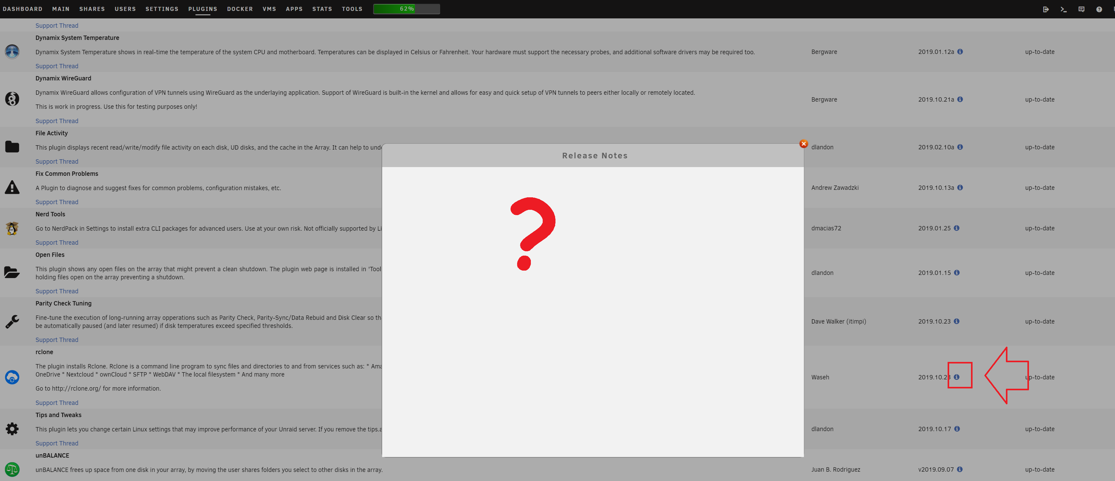

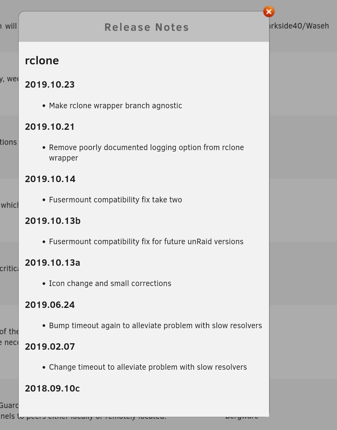

Thanks for this plugin, i saw a few updates over the last weeks... sadly there is no changelog and the name of the update doesnt seem to belong with the official naming... so, i would ask if you could give us a changelog? (or make the naming the same like original?)
e.g. which version belong to 2019.10.23?
v1.49.5 - 2019-10-05?
Edited by nuhll
There is a changelog both present in unraid webgui and on GitHub embedded in the .plg, so I'm not sure how you missed it.
Edited by Waseh
Sorry, i cant see it. Is that the correct way to view the changelog?
Hmm, any idea why that wont work? I just checked other plugins, some work, some not, where does that data get pulled from? Maybe its piholed? (but i dont see any blocks, so no idea)
Edited by nuhll
Okay, i found something out while looking at the source code.
The text you showed is there, but its invisible...??? If i click and drag, i can see it... using latest google chrome.. xD wtf
the code seems to be the same also, (same css, same layout "ul" "li" "h2" and so on...??)
I can see...

<h2>rclone</h2>
<h3>2019.10.23</h3>
<ul>
<li>Make rclone wrapper branch agnostic</li>
</ul>
