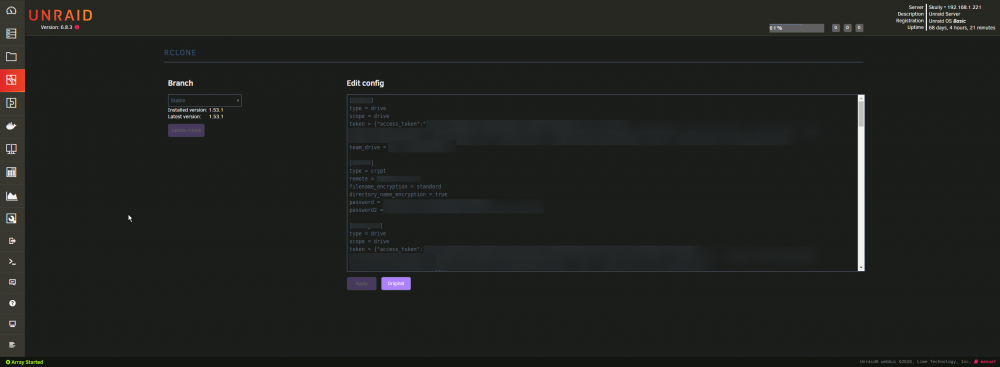

I am trying to add more remotes to my config but after trying to add about a total of 34 drives, i seem to have hit a character limit in the edit config.
When i add remotes via command line process (painfully slow when you have 34 drives) it will pass this character limit. so i know that it isn't a file limitation but a limit with the unraid web interface with this edit config.
Where is the config file located so i can add more remotes and bypass this web interface?
also, can the character limit be increased?

In command line terminal, use "rclone config show file" to find the location of your rclone.conf file and edit it manually.
