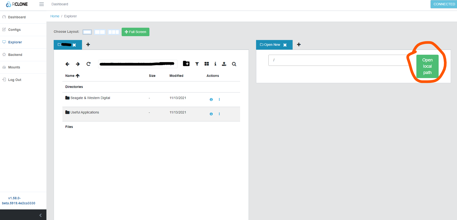

hello - does anyone know how to properly setup local share mounts that can be used within the built-in rclone web UI? I installed the waseh plugin, inserted my config for g-drive mounts (which it correctly sees) but i wasn't sure how i can begin both uploading / downloading files from my rclone g-drive mounts <-> local shares. See screenshot below - when you type "/" it automatically gives a button to open local path, but any combination of /mnt/user/[share] or even /mnt/ doesn't show any folders. I assume I have to give some sort of access but where do i do that?
for reference: i have this script running to access the web UI at http://[LOCALHOST]:5572/#/remoteExplorer
rclone rcd --rc-web-gui --rc-user=admin --rc-pass=admin --rc-serve --rc-addr :5572

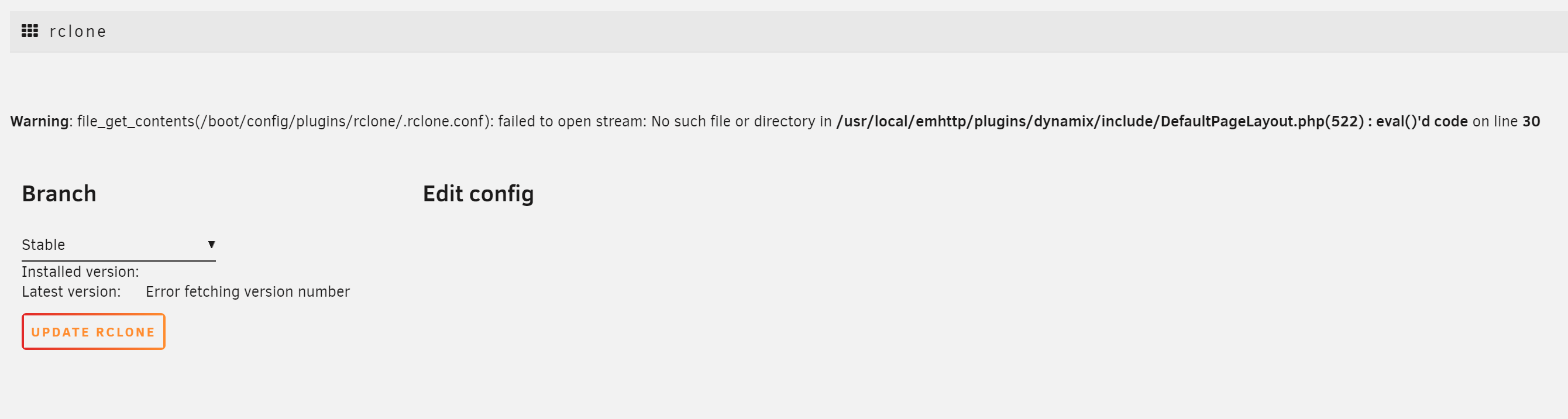

Hey y'all,
After installing rclone plugin on Unraid, I get this message when opening Rclone in settings menu:
Any idea how to fix this? I'm trying to set up a sync for my Google Photos.
@Luciano200x
The plugin probably didn't install correctly. Try removing it and adding it again and check the install popup for errors. Most likely you are blocking the download from the rclone website somewhere (firewall, pihole)
I seem to have introduced an error in the plugin where it doesn't correctly remove all packages on a failed install giving the impression that the plugin installed correctly when in fact it didn't.
I'll fix it first time I get a chance
Edited by Waseh
@Waseh
I've tried removing and reinstalling without succes before.. I'll try adding a rule to the pihole, that might be it.
Tnx so far!
@Waseh
Yeah, I updated the XML script and changed the DNS server to my local Pi-hole address and problem solved after installing. Thanks for heading me in the right direction.
