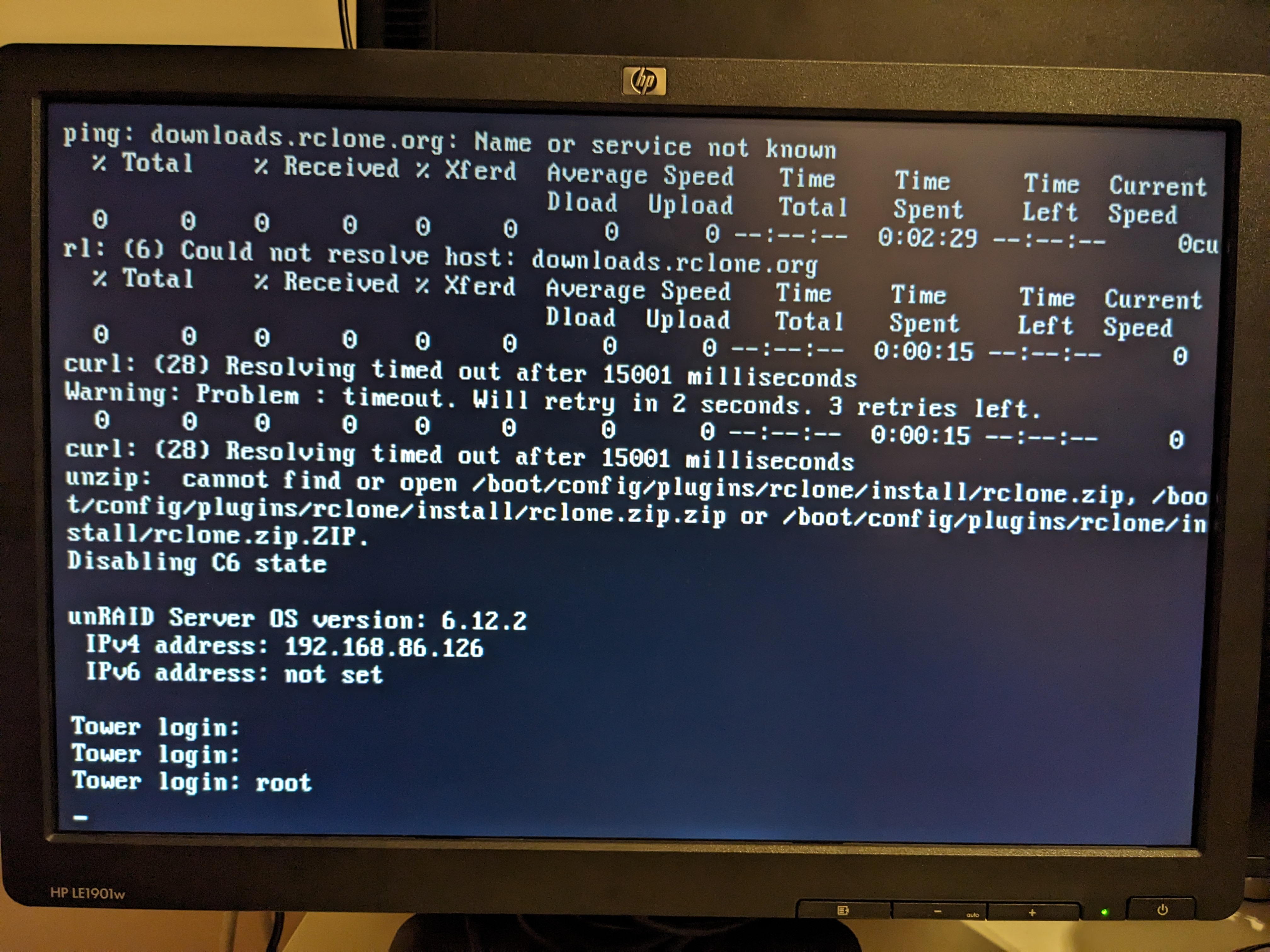

Would retrying downloading rclone help with transient network glitches?
Can confirm this issue is also happening to me. stuck on trying to download the zip file i believe..
removing the plugin from my flash drive solves this issue and allows me to get into the unraid GUI
Oddly enough.. if i reboot and get into the GUI and then try to re-install the rclone plugin, it will install perfectly fine.. but won't let me access the settings -> rclone page. it just hangs. and locks my GUI up. so i have to reboot the system.
Not sure whats causing this. i was on 6.12.0 and thought it was a version issue so updated to 6.12.4, but still the same problems.
I've also tried slightly older backups i've had but still no dice.
Not sure whats causing this issue.. with the restore AND the clean install..

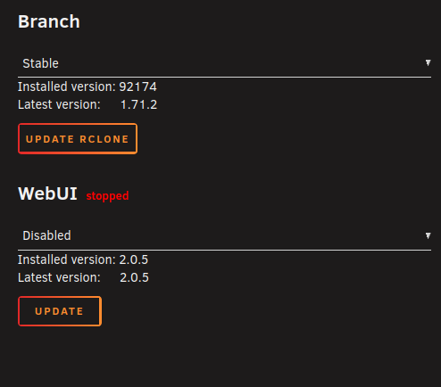

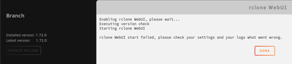

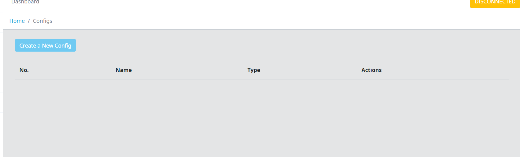

It might be a dumb question, but it seems that the webUI version does not work for me.
I've just installed the Rclone via Apps (plugin, Installed Version2024.08.22) with WebUI option
2024.08.22
Add rclone WebUI (optional) - by ich777
Using CLI i configured it to backup a folder from my unraid, to a google disk. When I try to open a GUI it looks like working, but no option actually works.

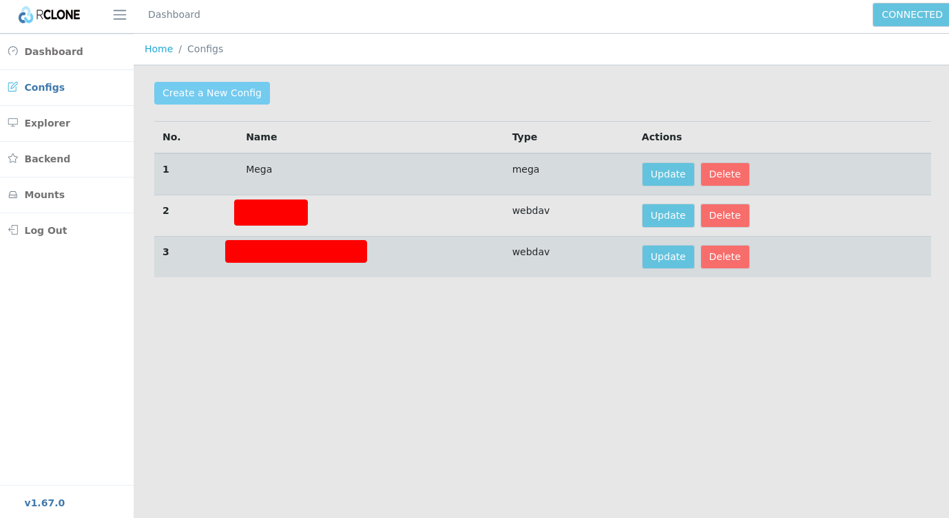

"Configs" shows nothing:
Hitting "create new config" makes it crash. Choosing "explorer" too.
Should I install some additional modules to make it work?
log.txt

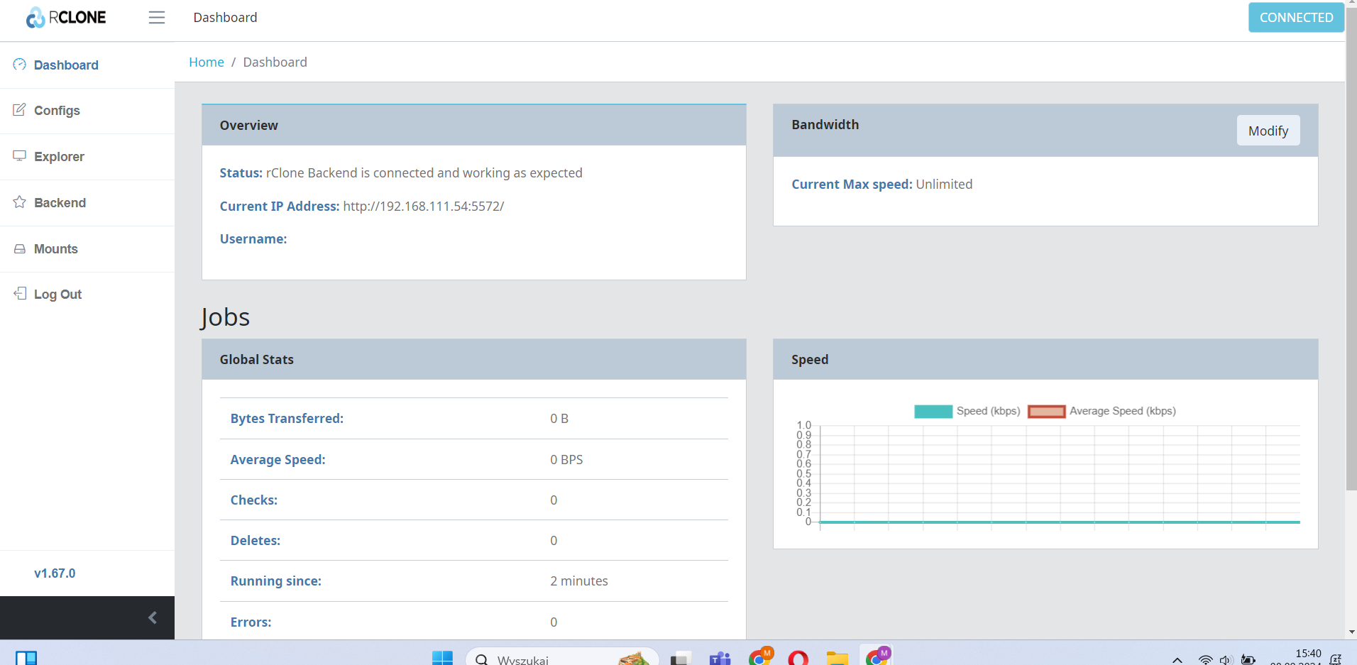

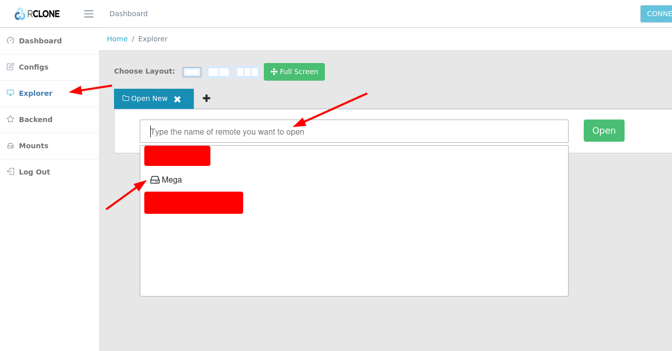

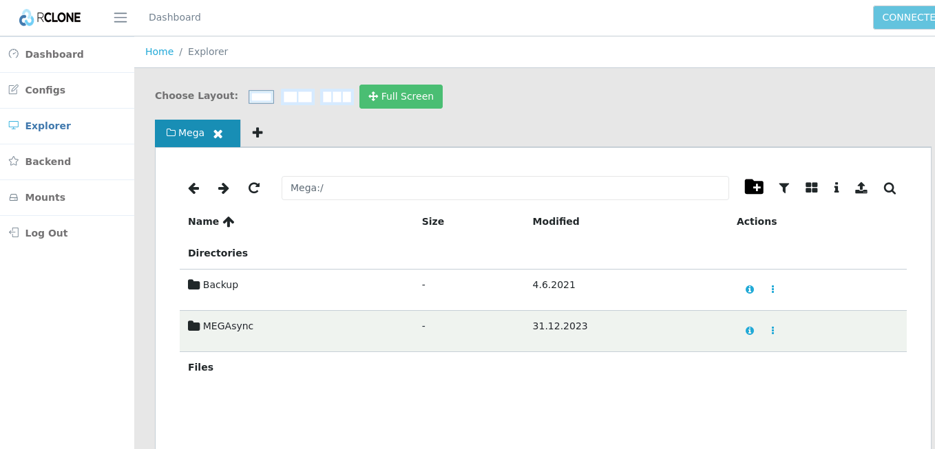

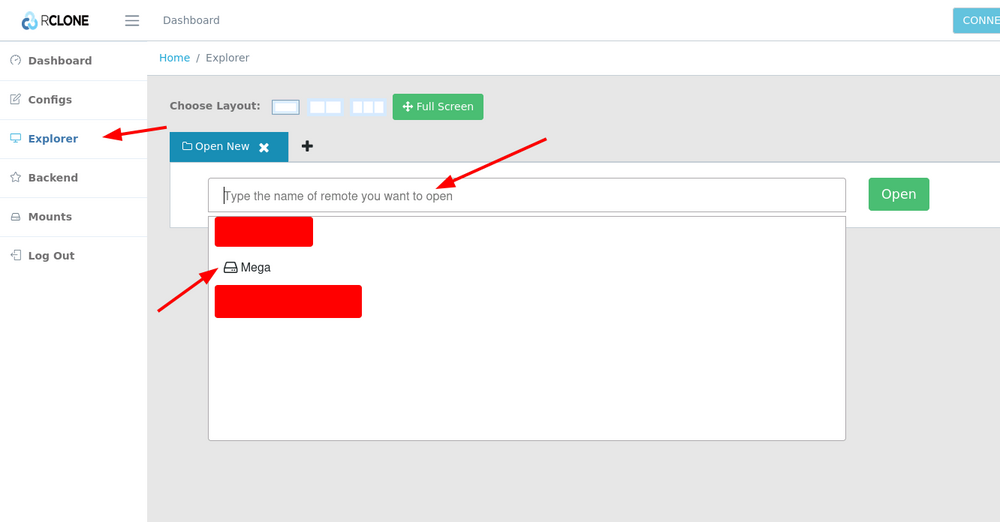

Usually not, it is working right OOB for me here:
You should be also be able to browse the shares:

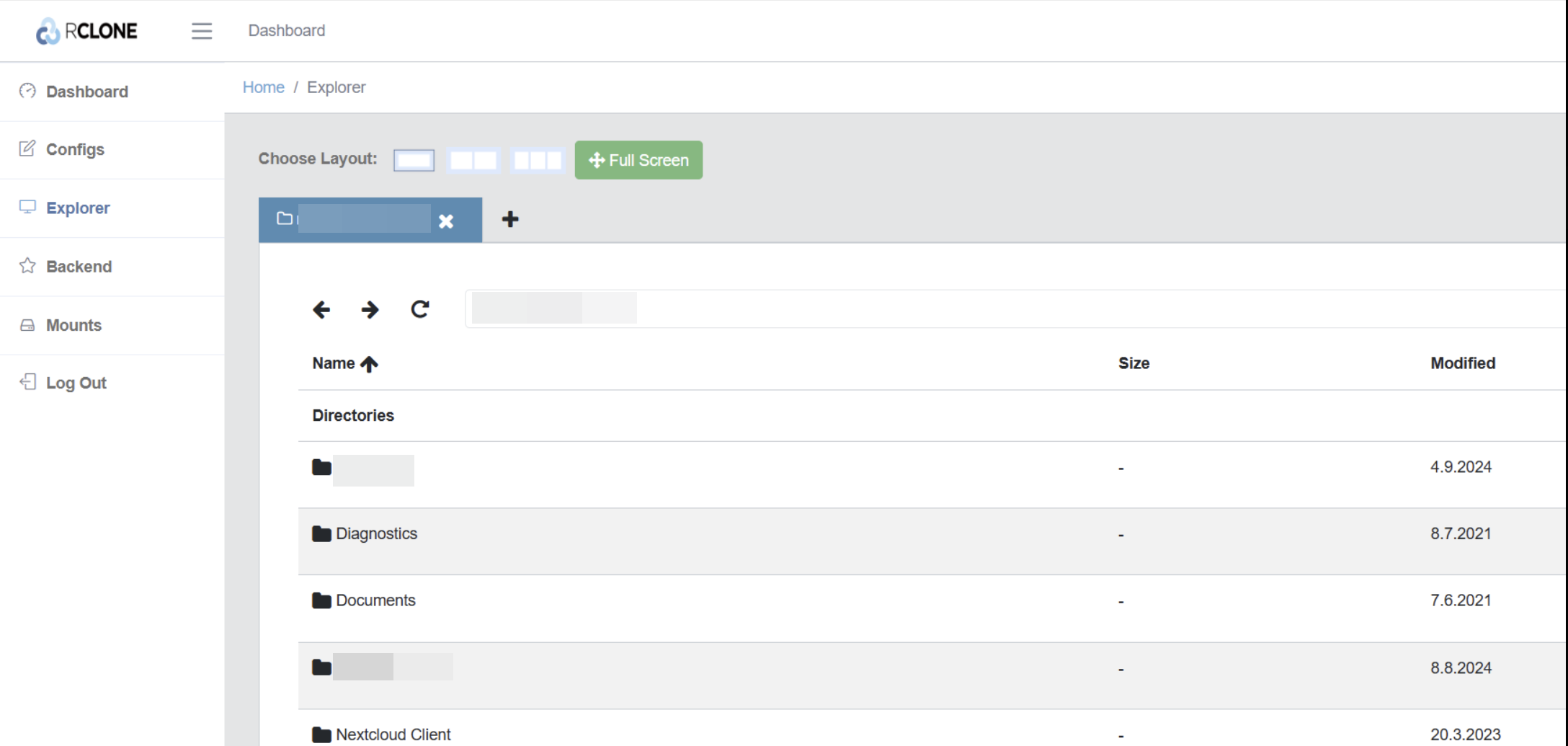

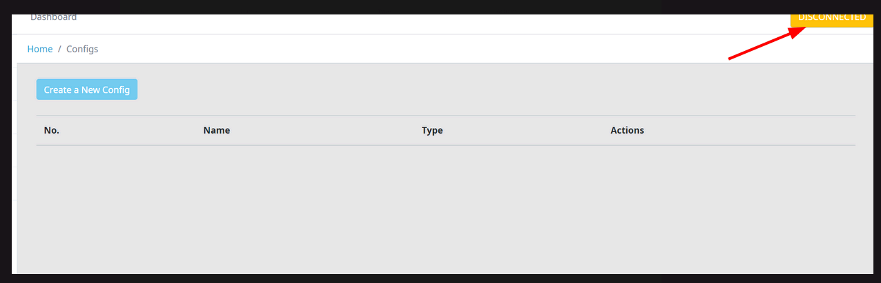

EDIT: @b00 something really strange is going on, I see that you are Disconnected from your screenshot that means that you basically have no connection to the rcone WebUI service that is running in the background, are you sure that you didn't stop the process in the meantime:
hm, from my side it is working fine:
