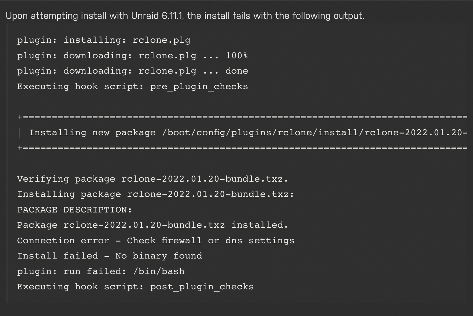

Upon attempting install with Unraid 6.11.1, the install fails with the following output.
plugin: installing: rclone.plg
plugin: downloading: rclone.plg ... 100%
plugin: downloading: rclone.plg ... done
Executing hook script: pre_plugin_checks
| Installing new package /boot/config/plugins/rclone/install/rclone-2022.01.20-bundle.txz
Verifying package rclone-2022.01.20-bundle.txz.
Installing package rclone-2022.01.20-bundle.txz:
PACKAGE DESCRIPTION:
Package rclone-2022.01.20-bundle.txz installed.
Connection error - Check firewall or dns settings
Install failed - No binary found
plugin: run failed: /bin/bash
Executing hook script: post_plugin_checks
So did you try checking your firewall or DNS settings like it says? It can't download the binary from the rclone server.

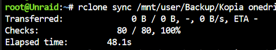

I have this script
#!/bin/bash
/usr/local/emhttp/webGui/scripts/notify -e "Unraid Server Notice" -s "OneDrive backup started" -d "Synchronizing Kopia backup to OneDrive" -i "normal"
echo 'OneDrive backup started'
rclone sync /mnt/user/Backup/Kopia onedrive:"/Backup/Kopia"
/usr/local/emhttp/webGui/scripts/notify -e "Unraid Server Notice" -s "OneDrive backup finished" -d "Synchronization completed" -i "normal"
echo 'One Drive backup completed'
I would like to get aditional info via echo so I get it into unraid notification system and them to telegram bot.
If I add a -P in console it look like this
Is there a way to send this info via echo? to have some input about if it was successful or not.
Maybe creating a log, reading it echo the last lines, and deleting the log?
How all this could look like in a bash script, I don't know how to code it.

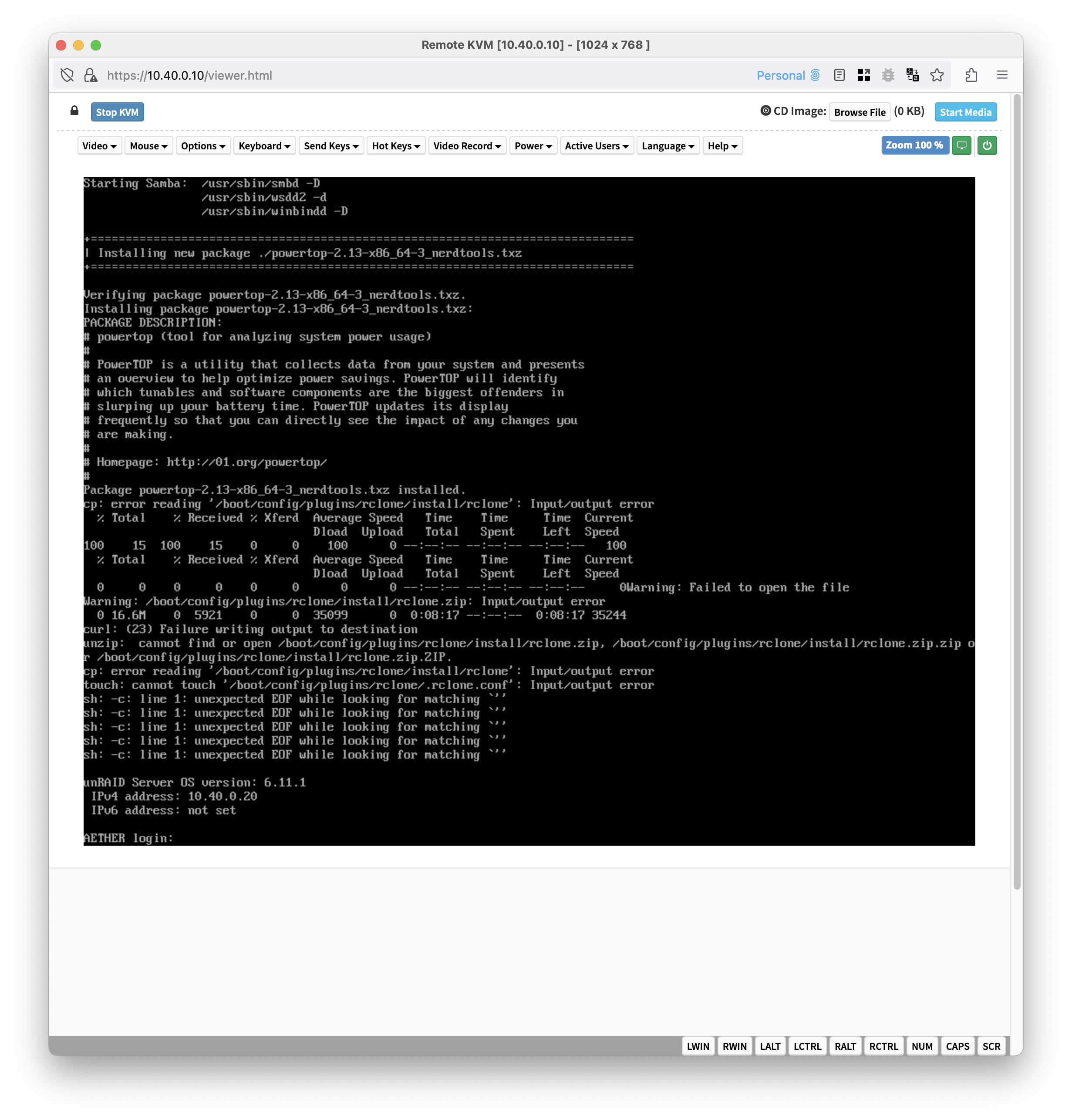

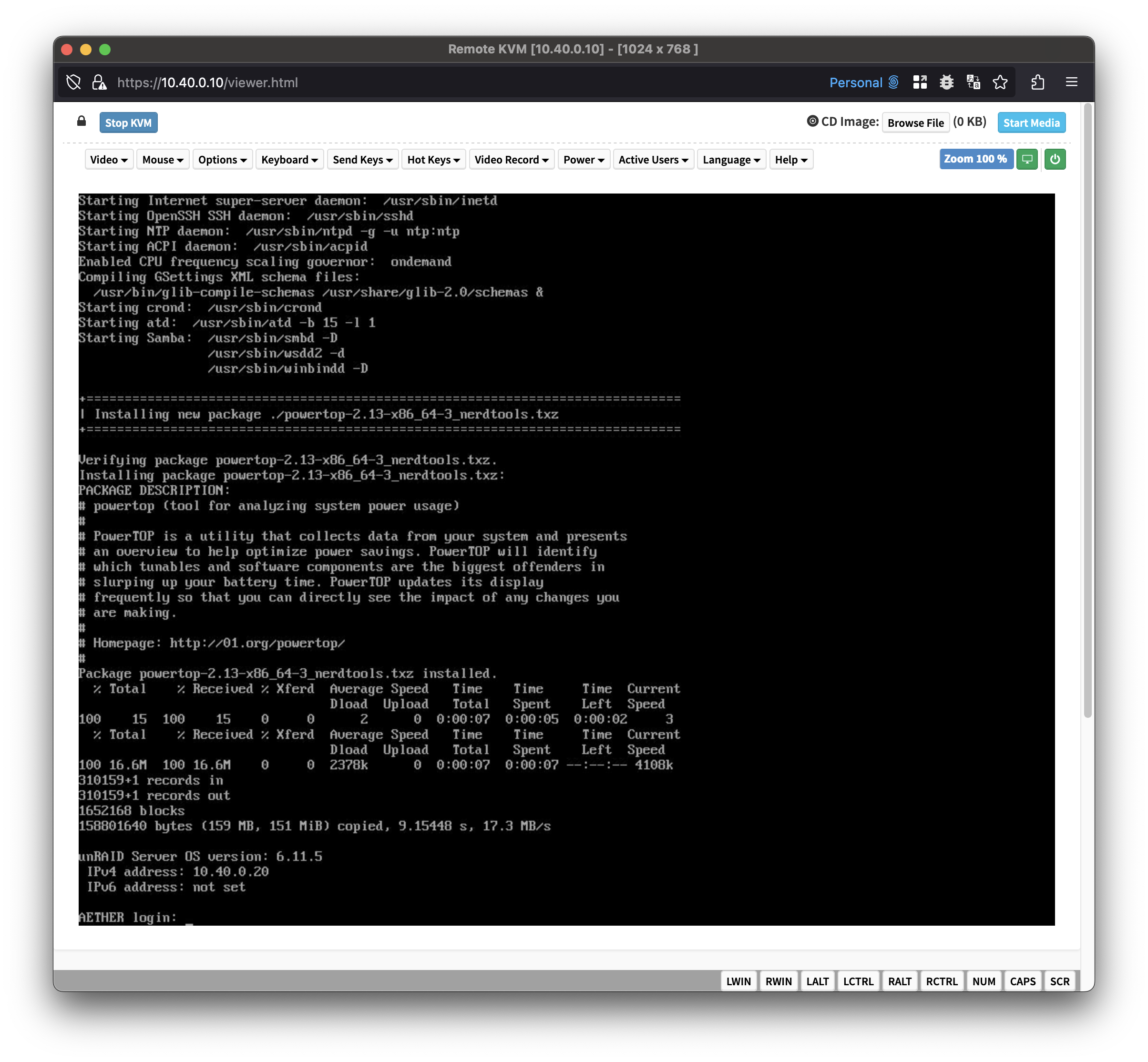

I'm having an issue that is breaking Unraid boot, for some reason it fails each boot. In order to fix it, I have to put the USB drive into my main machine and delete/move the rclone directory to allow it to rebuild from scratch on boot;
mv /boot/config/plugins/rclone /boot/config/plugins/rclone.old
(or something to the same effect)
Unraid 6.11.5 and 6.11.1.
I've just re-installed the plugin and will report if that has fixed it as I have a reboot tomorrow to install a new USB PCI-e card.
This screenshot is the broken boot:
This screenshot is after moving/deleting the `/boot/config/plugins/rclone` directory:

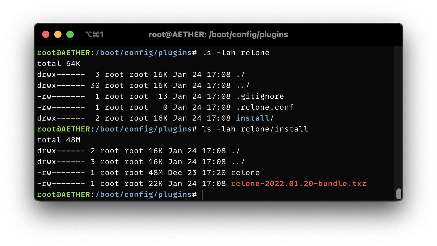

Permissions of `/boot/config/plugins/rclone`:
Edited by unraidyn
Nope, it appears its still broken. Not sure what to do, but this is currently making the server unbootable in its fresh-installed state.
You're having I/O errors on your flash drive. I'd be surprised if this was related to the rclone plugin. Could be a corrupt filesystem or dying flash drive or any other number of things.
But again I don't think this is related to this plugin specifically.
Ah right okay, I could swap to a different flash drive, but its behaving absolutely fine otherwise.
What's super weird is no other plugins have this issue, this is the only plugin.
And what makes it weirder, it also doesn't occur if the rclone plugin doesn't already exist on the drive. It downloads and installs just fine.
Is there any file system integrity test or something I can perform on the USB drive?
Running an 'fsck' said the drive was normal and healthy.
Edited by unraidyn
If you want to know something really weird, if I modify the plugin to delete the plugin directory as the first action in the installation script:
if [ -d /boot/config/plugins/rclone ]; then
  rm -rf /boot/config/plugins/rclone
fi;
It works fine. There is something about that specific '/boot/config/plugins/rclone/install/rclone' file that my install really doesn't like.
