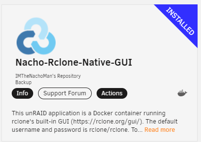

No. I created a Docker container for the GUI. It has some bugs/issues with creating new configs but it works for browsing existing ones.
Thanks for the work on the GUI Docker. How do I connect it to the Rclone in this plugins and connect it to the already existing configs?
You are welcome.
Right now you can't. You have to create a new one using the command line interface from the Docker shell. But I like the idea of mapping the config file to the OS one. I'll add that feature.

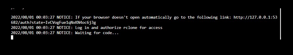

any tips?, 127.0.0.1 of course can't go anywhere
