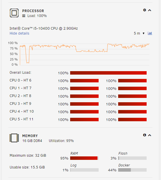

I use rclone with Google Drive to sync my files but I transferred to OneDrive for Business (my account for work). It's the same config and settings but when it start to sync (on schedule), my CPU usage is 100% and RAM is about 94-96%. I've been monitoring this for the past days and I turned the sync schedule off and the server is stable for 4 straight days. Why is it eating my RAM and CPU?
The sync script. It run's every 01:00.
#!/bin/bash
#Google Drive
#rclone sync /mnt/user/Media/Videos /mnt/disks/"Google Drive"/Videos --exclude *.ini
#rclone sync /mnt/user/Pictures/Album /mnt/disks/"Google Drive"/Pictures --exclude *.ini
#rclone sync /mnt/user/Backup /mnt/disks/"Google Drive"/Backup --exclude *.ini
#rclone sync /mnt/user/Documents /mnt/disks/"Google Drive"/Documents --exclude *.ini
#OneDrive
rclone sync /mnt/user/Media/Videos /mnt/disks/OneDrive/Backup/Videos --exclude *.ini
rclone sync /mnt/user/Pictures/Album /mnt/disks/OneDrive/Backup/Pictures --exclude *.ini
rclone sync /mnt/user/Backup /mnt/disks/OneDrive/Backup/Backup --exclude *.ini
rclone sync /mnt/user/Documents /mnt/disks/OneDrive/Backup/Documents --exclude *.ini
I will turn on the sync again today and update you if my CPU and RAM will get 100% later at 01:00
UPDATE: @1:30
Now I can't access the dashboard anymore. How can I prevent this?
Edited by HHUBS

I don't have diagnostics because the server was hung (couldn't do anything), but any idea why this might be happening?
