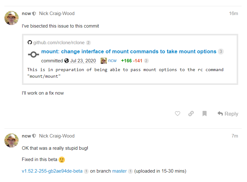

It basically looks on my install like --allow-other is not functioning correctly all of a sudden - i can even do backup/restore backups to google drive no issue - but all my containers have lost their ability to read the files
Edit: https://forum.rclone.org/t/issue-with-allow-other-in-beta/18133

26 minutes ago, mcrommert said:
Thanks for sharing this here. Rclone is working for me again. For anyone else that comes here looking for a solution, you just need to reboot unraid and the rclone plugin will be updated with the fix.
it won't show without the reboot?

There is no new version, there was a fix applied to that version. Restarting unraid pulls the fix. If you restarted you should be good.

I am using the same version. 2019.11.01 by waseh. I had the same problem as you and it was fixed upon restart after mcrommert's comment. I'm not sure why your setup is different but keep working at it.

got it working. thanks for the fix. that was a hassle.  I should have left my initial scripts apparently. they worked without a hitch. odd.
