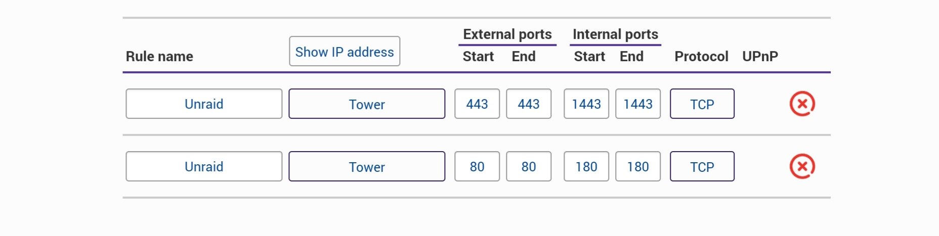

For the life of me I can't figure out what I'm doing wrong.
I have 3 duckdns subdomains setup, one for the server, nextcloud, and sonarr, they ping fine and point to my external IP.
I use google domains and have 3 CNAME records, server, sonarr, and nextcloud pointed at the server duckdns subdomain. These records seem to be working as well, I can ping them and they resolve to the external IP.
I have forwards setup to send the ports 443 and 80 on to 1443 and 180.
Hopefully someone can figure out what's wrong, I've gone around in circles and am at wit's end, thank you!
Why get duckdns involved if you have your own domain?

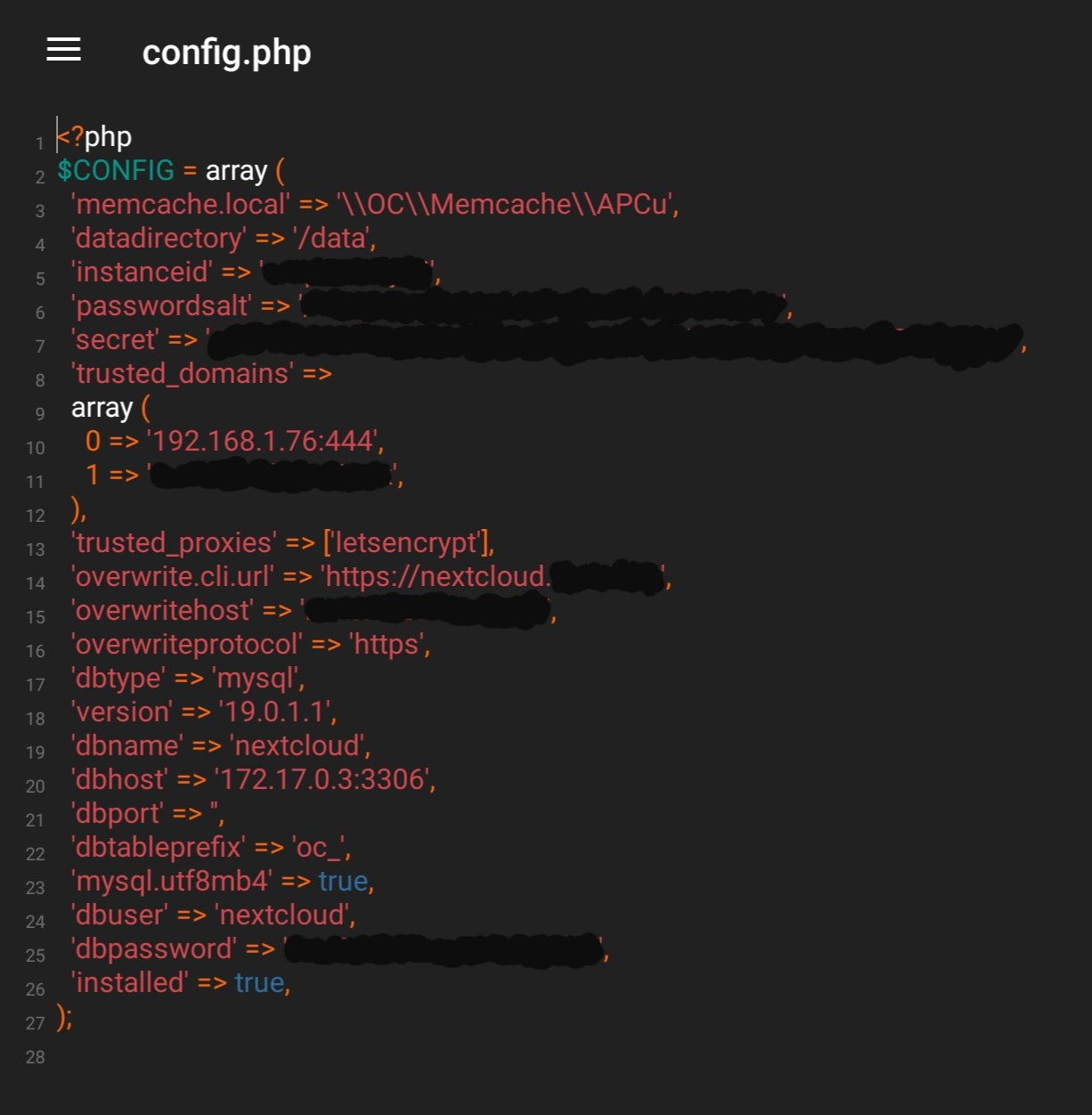

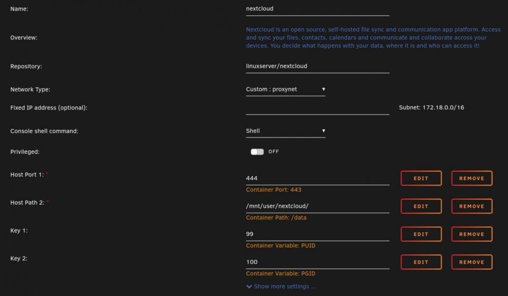

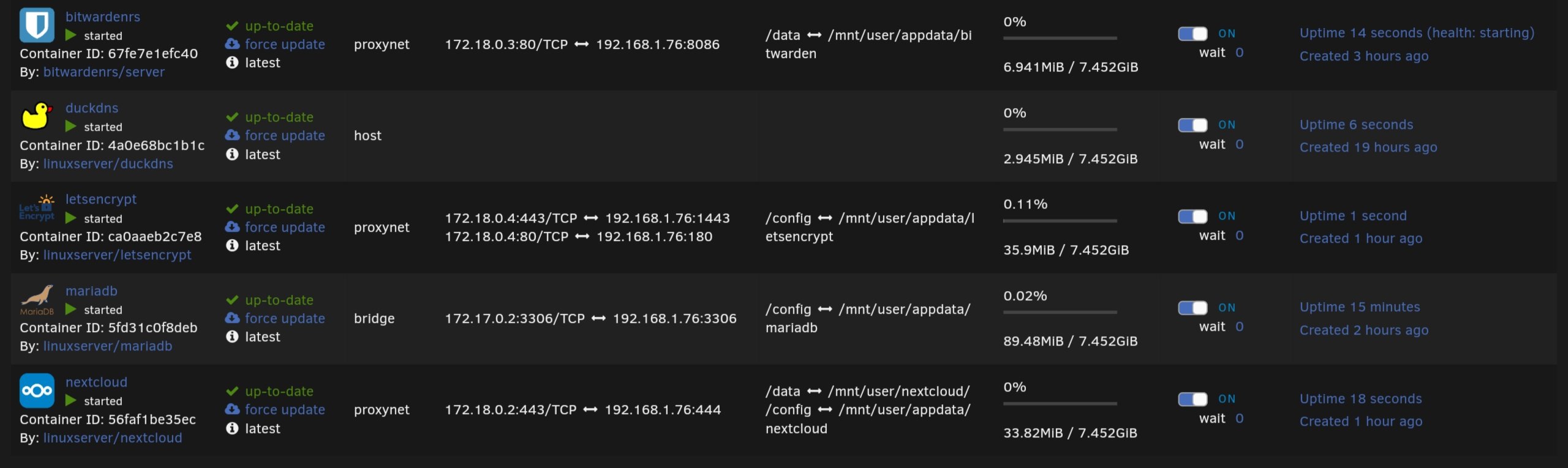

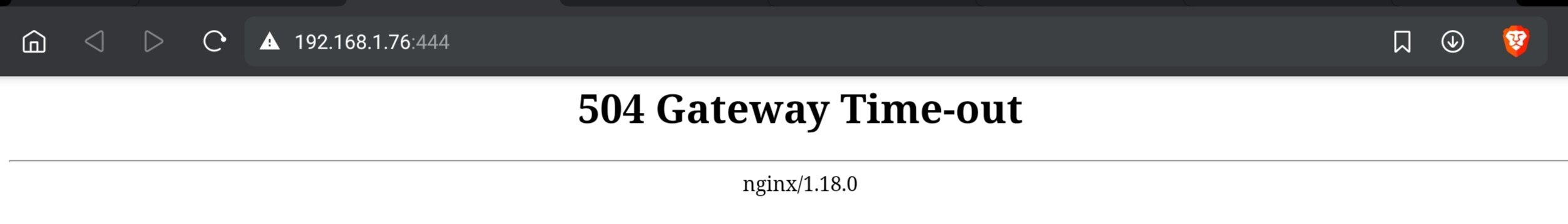

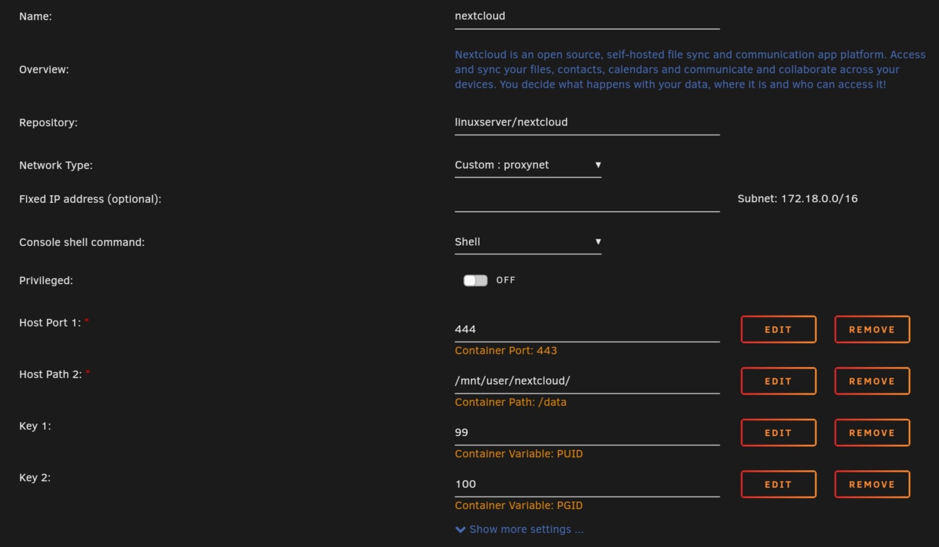

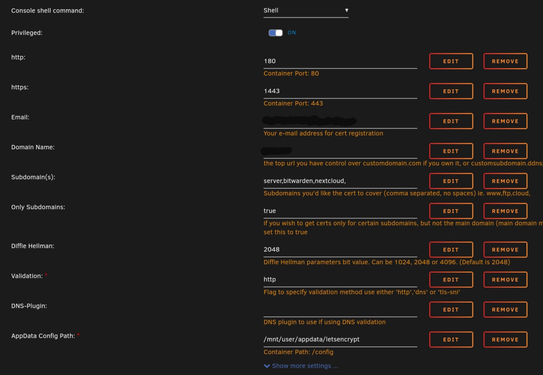

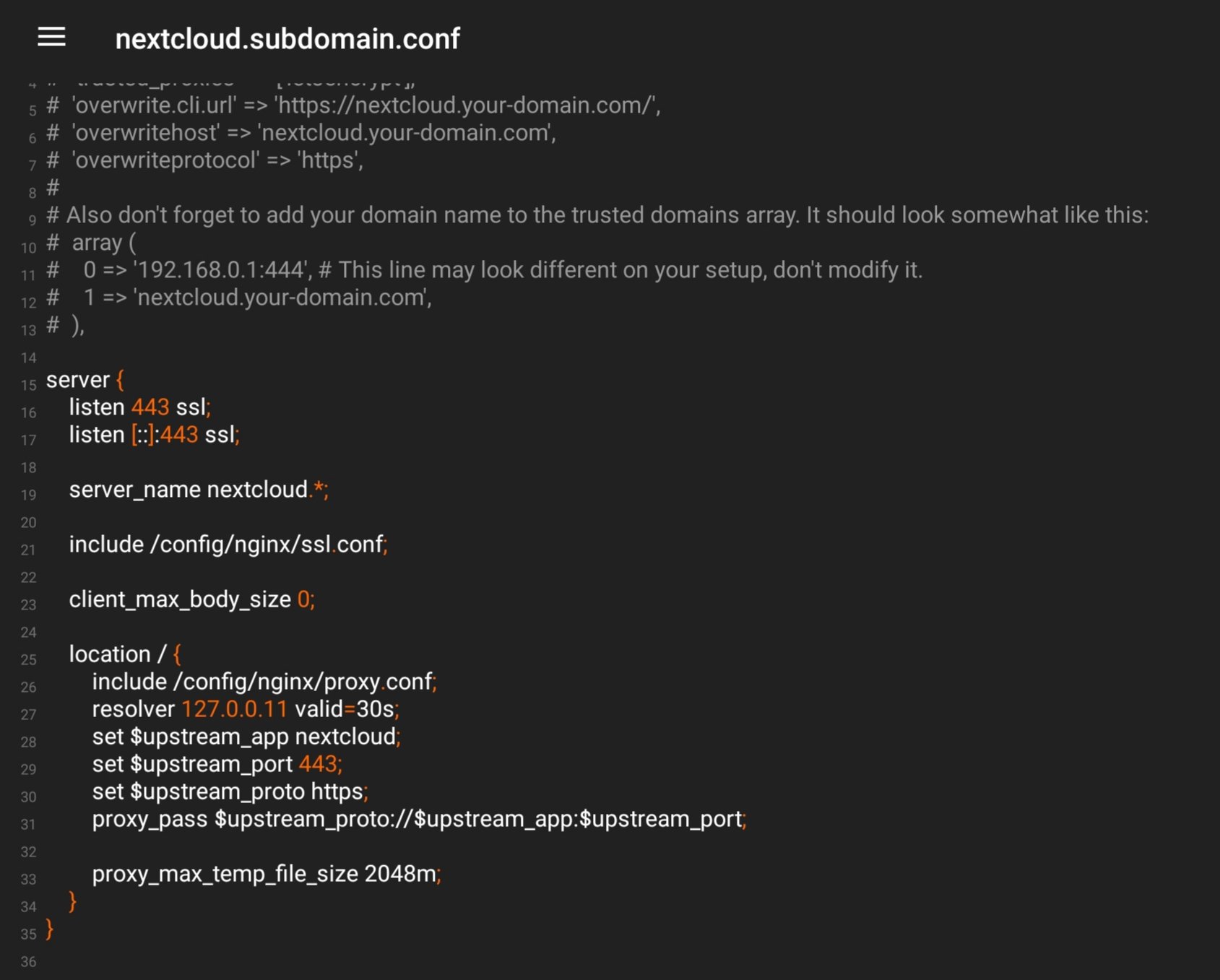

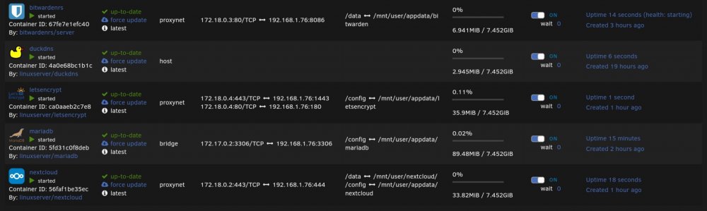

Hello,
Can I start by saying that I have only moved over to unRaid from Synology during the past 48hrs and the support both tech and community have been first class. Things are so much smoother and easier, I should have made the transition a long time ago.
I've followed several of Spaceinvader One's excellent YouTube videos and have successfully setup Sonarr, Radarr, Sabnzbd, DuckDNS, MariaDB, Bitwarden, Letsencrypt, NextCloud, server wide encryption, cache drive and several plugins, and I'm very happy. The Linuxserver containers are first class.
One issue I have been stuck on for the past few hours though is getting NextCloud to work with Letsencrypt. I managed to set it up and had it working locally however when I moved it into the reverse-proxy fold like I did with Bitwarden, I am getting timeout errors.
I have looked through the forums of similar issues however none of the potential solutions have fixed the issue.
The CNAME entries have been checked and double checked. These were entered only today however the Bitwarden one took effect instantly. I have double checked the Letsencrypt and NextCloud config files, however they appear correct also. I've ran out of ideas.
Thanks in advance.
I have attached several screenshots below which I hope will be enough for someone to point me in the right direction, however if any further information is needed, please let me know.

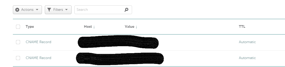

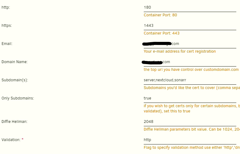

I think this letsencrypt thing is hardest in unraid

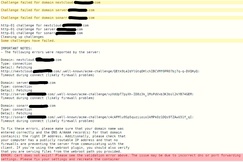

I tried multiple things, cannot make it working
I bought a domain in name cheap
I placed CNAME records. in host i put server and sonarr, in value i put my duckdns url
In my Asus router with merlin firmware i setup port forwarding
When i am trying to listen ports 180 is showing as opened, and 1443 no response. As i checked my IPS not blocking ports 443 and 80
When i am installing Letsencrypt following Spaceinvader guide in log files i see that errors

ERROR: Cert does not exist! Please see the validation error above. The issue may be due to incorrect dns or port forwarding settings. Please fix your settings and recreate the container
Router has DDNS enabled, i don;t know if this is affecting. I a dumb in all this network and domains things
What i am doing wrong? How i can make this letsencrypt working? Can be issue with duckdns?
I'm finding my way also, however I believe you have your internal and external ports the wrong way round on your routers firewall.
1 hour ago, saarg said:
I would advice you to use a VPN if you need to access the unraid GUI. If you have letsencrypt on a custom bridge, it will not be able to talk to one of the servers either.
Thank you for your reply 🙂
1) You have your own domain, 2) you are using duckdns, and 3) your router has DDNS.
You should only need one of these 3. Since your router has DDNS why get the other things involved at all?
I think because of my knowledge.  Now i managed to make it working with duckdns and domain name. Duckdns only for my cnames, as i dont have static IP
@LoneTraveler U were right, i setup wrong port forwarding, I tried before and nothing has been working, but i think this is was because of cnames so i messed up port forwarding.

22 hours ago, LoneTraveler said:
Hello,
Thanks in advance.
Hello,
I've managed to resolve my issue. For anyone whom is having similar difficulty, I'll explain here.
After creating the NextCloud database in MariaDB, I had to edit the 'custom.cnf' file in;
"...mnt/cache/.appdata/mariadb"
Specifically, I edited line 124, changing '#bind-address=0.0.0.0' to 'bind-address=0.0.0.0' without quotations.
This allowed me to progress through the initial admin setup page of NextCloud without the 504 error.
One last point though, when I placed NextCloud behind the Letsencrypt reverse-proxy, I had to restore the above edit to default, ie had to place back the # before I could connect.
Hope this helps.
