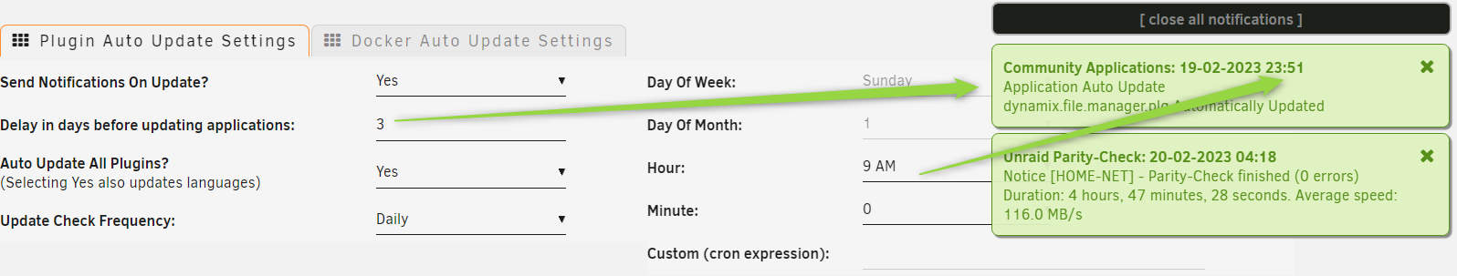

If I have set a delay of 3 days and a daily check, pending updates should not be installed directly but only in 3 days, right? I ask because an update was installed without delay despite these settings.  Also the defined time of 9 o'clock in the morning was not taken into account, see screenshot.
Thanks for your help

But, I did find a bug in the calculation which *may* have resulted in it ignoring the difference in days
Your notification showing up at a completely wrong time implies that something else (AppData Backup?) updated the plugins
Am just setting up UnRaid and have not yet set up a backup. I don't think Unraid has an active default setting for a plugin installation, does it?
