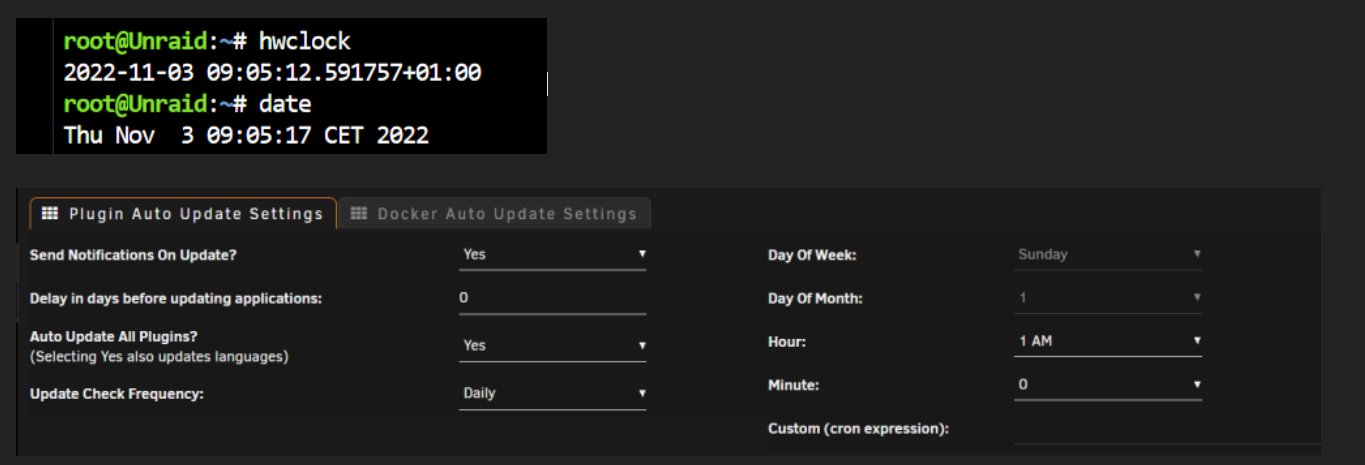

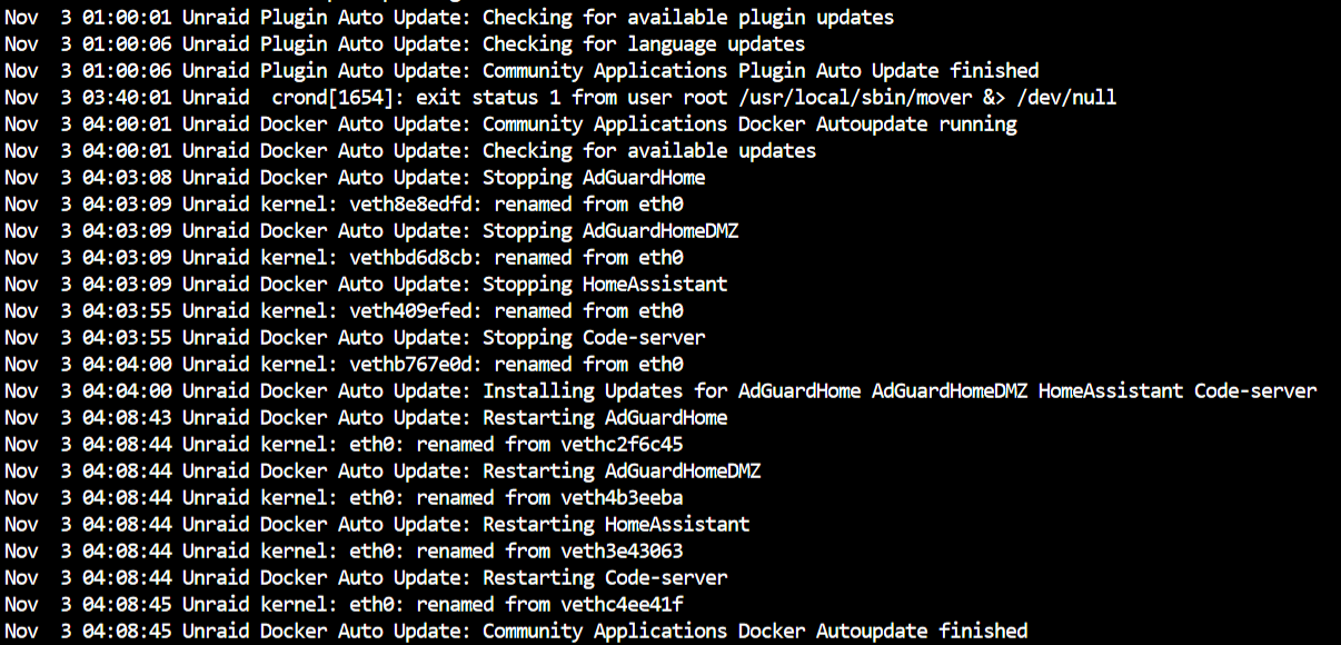

This is how my time is synced
But the updates happens at 4am and not at 1 am
Any idea why?
Plugin updates are happening at 1AM according to that snip.  Docker updates are happening at 4am.  There's a separate setting for them under Docker Auto Update Setting.
What causes this?

That was a bug from years ago.  Make a change to to plugin update settings and reapply.
