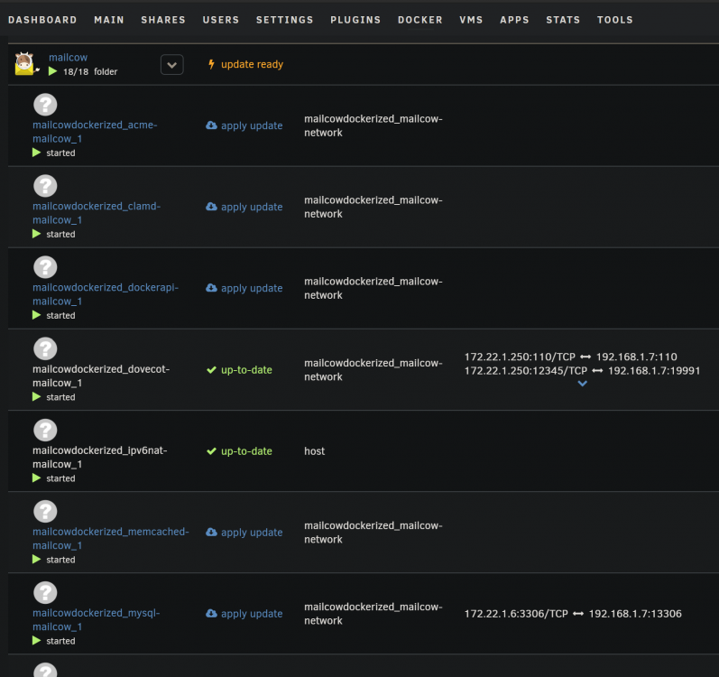

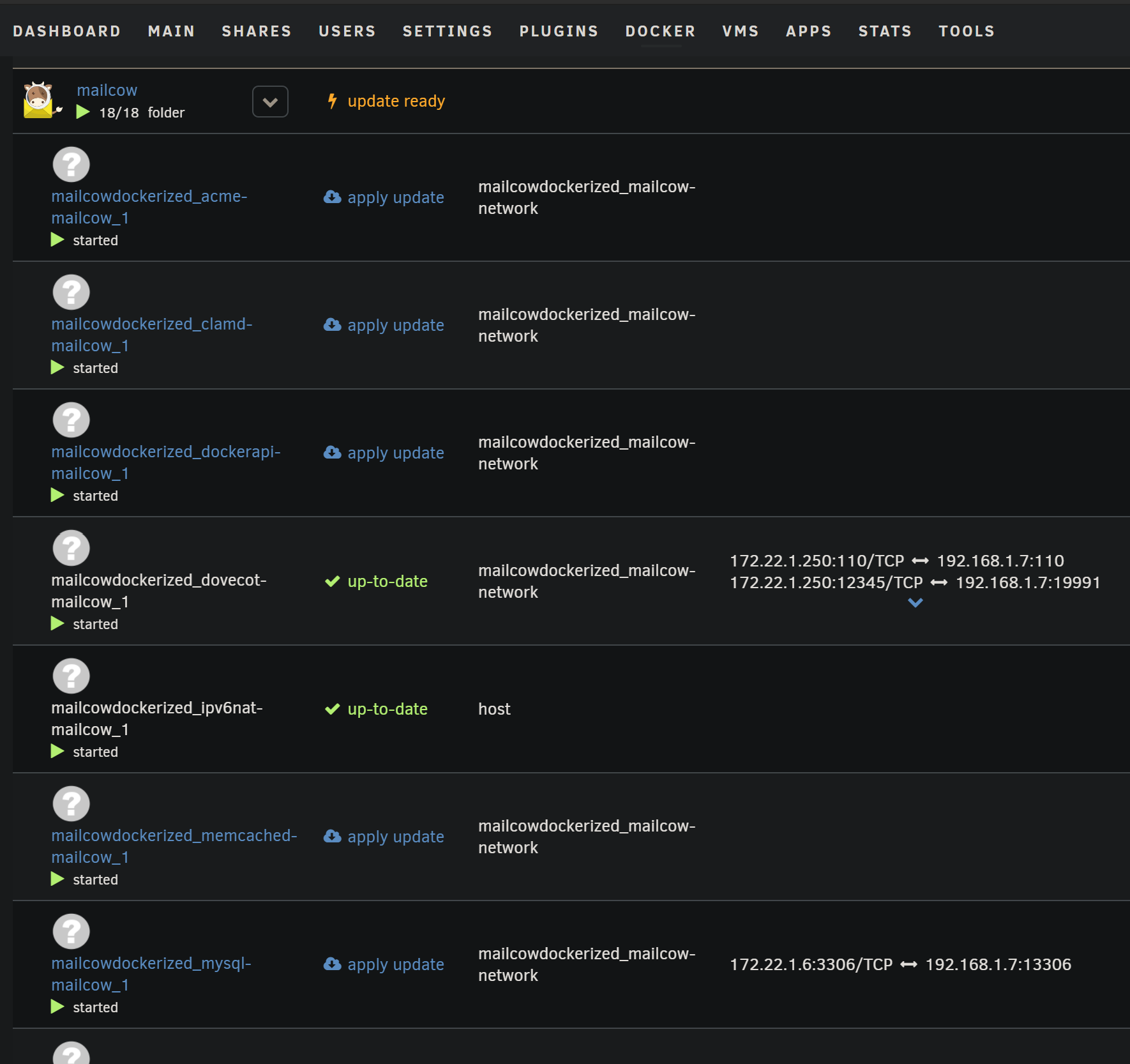

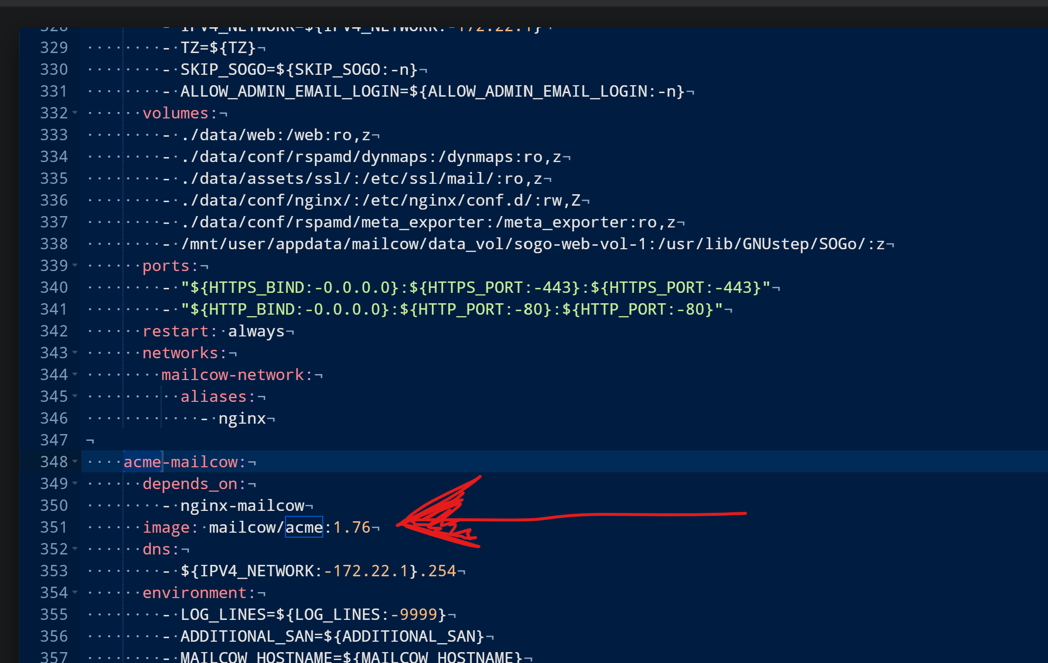

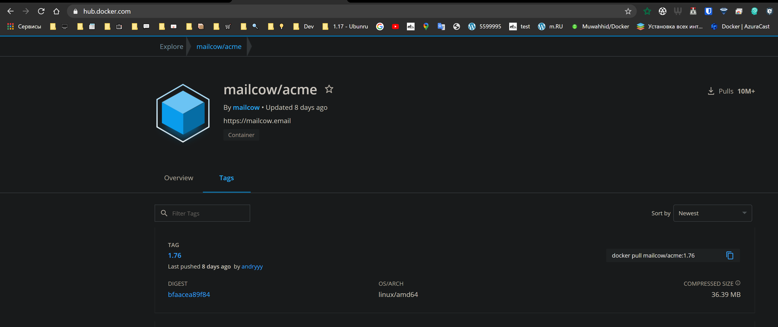

I have a Compose of 18 Mailcow containers.

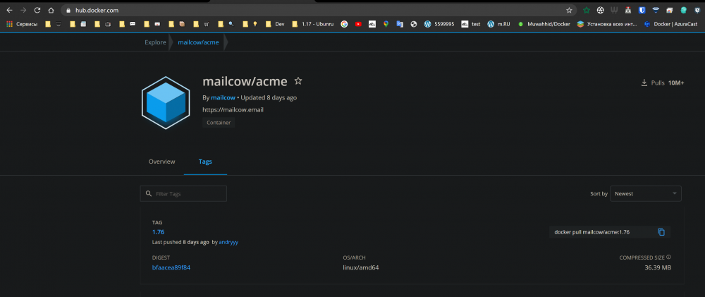

So, in the yml file, all the latest versions, but the plugin shows that you need an update.
How to get rid of it?

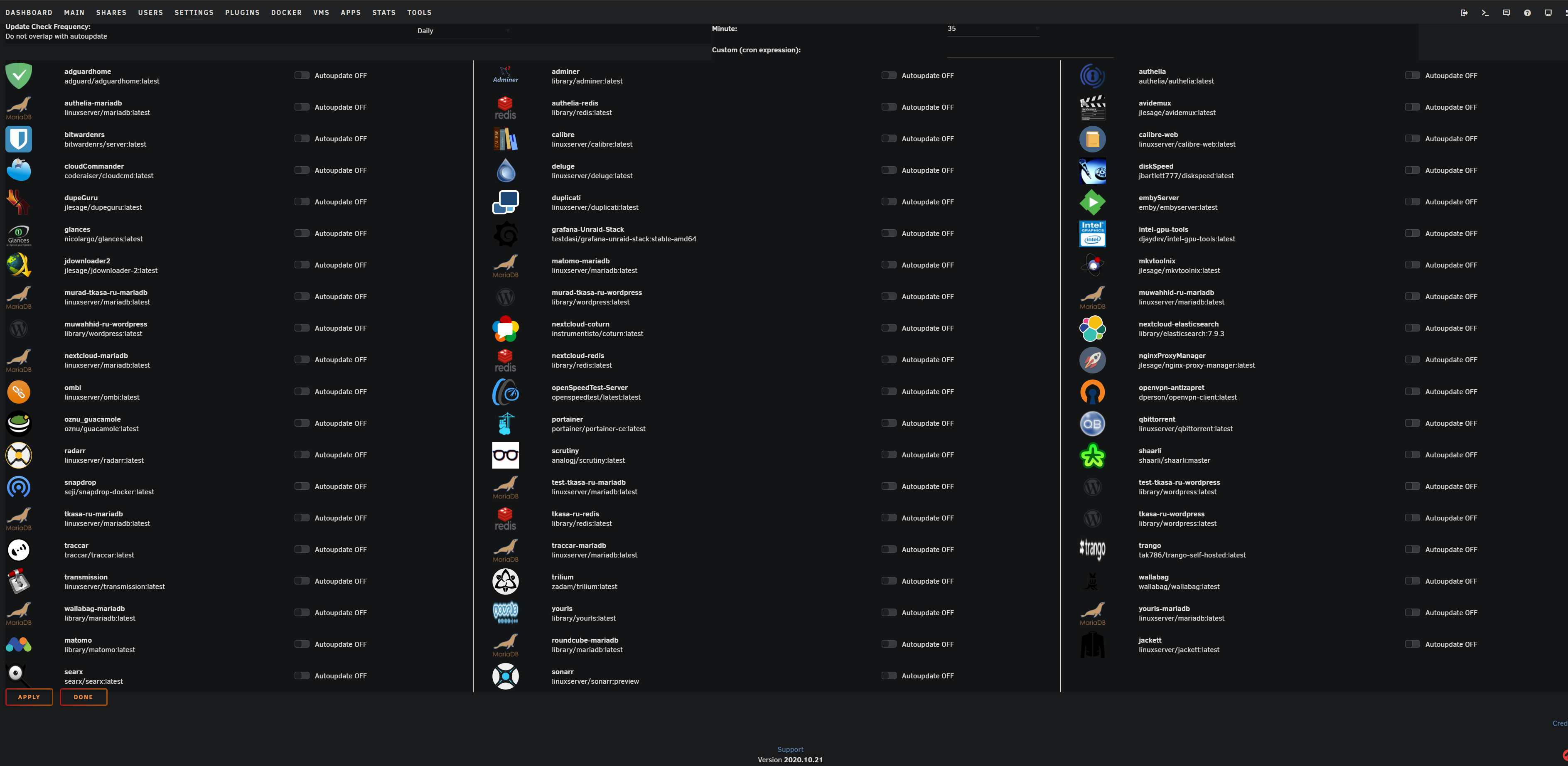

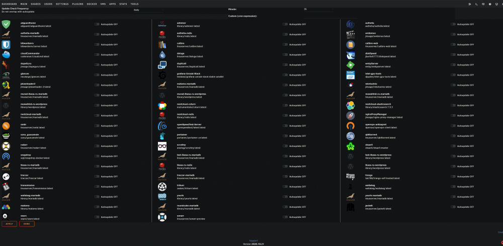

I've tried to disable the update check in the plug-in settings, but not all containers come out there.

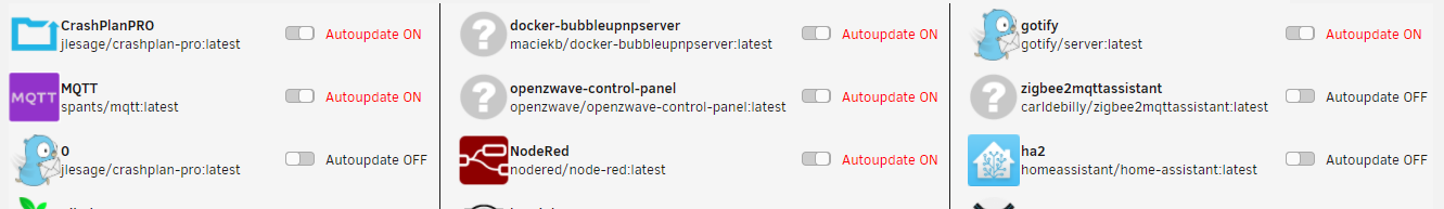

I'm getting a wierd double up Crashplan Docker. It names it "0" too. I definitely don't have two dockers and there's no old containers. Also strangely it's supplying the gotify icon for the image. I do have the gotify docker running too. Any ideas?

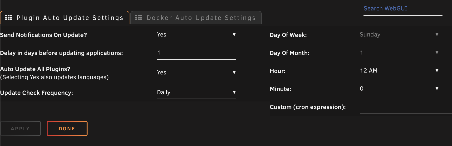

When this app runs, plugins aren't updated and I only get this in my log:
May 26 00:00:01 unraiden Plugin Auto Update: Checking for available plugin updates
May 26 00:00:07 unraiden crond[1933]: exit status 255 from user root /usr/local/emhttp/plugins/ca.update.applications/scripts/updateApplications.php >/dev/null 2>&1
What's the output if you enter this in:
echo $?
echo $?
bash-5.0# /usr/local/emhttp/plugins/ca.update.applications/scripts/updateApplications.php
Warning: date_diff() expects parameter 2 to be DateTimeInterface, bool given in /usr/local/emhttp/plugins/ca.update.applications/scripts/updateApplications.php on line 85
Fatal error: Uncaught Error: Call to a member function format() on bool in /usr/local/emhttp/plugins/ca.update.applications/scripts/updateApplications.php:86
Stack trace:
#0 {main}
  thrown in /usr/local/emhttp/plugins/ca.update.applications/scripts/updateApplications.php on line 86
bash-5.0# echo $?
255
I manually updated the My Servers plugin then ran auto update again and now it's working. I guess it doesn't handle version numbers like "2021.05.14.1336".
What are the settings you've got for the plugin updates?
