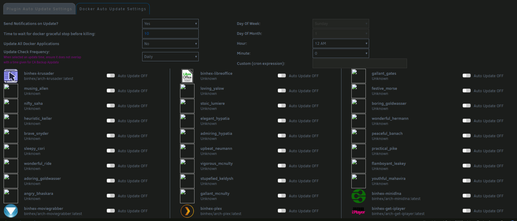

hi guys, i havent used this plugin in a while, and noticed that when i re-enabled it  and selected "no" to "update all docker applications" that its showing all dynamically named containers from waaaay back (no longer exist), so my update screen looks like this (its actually larger than this but you get the idea):-
any ideas what i can do to reset the list of containers. running version 2019.01.31 of the plugin on unraid stable 6.6.6
I have of course tried an uninstall and re-install of the plugin with the same result as above.
Edited by binhex
You sure you don't have any orphans images?  (Docker - Advanced view)  The plugin doesn't "Remember" anything, but gathers the list of what the docker system says is installed.
Edited by Squid
100% sure, no unnamed containers or orphaned images, confirmed via cli.
Sent from my EML-L29 using Tapatalk
unRaid *thinks* they are there.  I'm grabbing the info from it.   Not quite sure why it thinks that, but a nuke of the image will certainly fix you up.
Yeah I realise a nuke of the image would of course get me back to a nice clean state but I thought it may be of interest to you as to why is happening, I'm assuming that the plugin is not issuing a docker ps -a otherwise it wouldn't be happening, so whatever mechanism is used is reporting different results to what the docker engine is reporting.
Edited by binhex
You would have to post the output of running this script to see what unRaid thinks is happening
