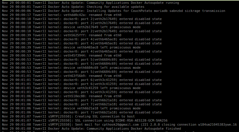

Guys, I was on the right track with 6.2.x and the docker update.  But, I had the wrong syntax.  28b disables the docker update routine on 6.2.  But quick tests with my modified syntax works.  Just have to wait again til I can get an updated container on my 6.2 system
Hi Squid..  Thanks again for all of your efforts!
Just wanted to give you the heads up, some of my Docker's were uninstalled this morning shortly after the auto-update. Of course all it took was to reinstall them, but i wanted to let you know.  See the attachment from my log file for more details.
I had a docker uninstall after an auto update.  It was  the official phpadmin docker from dockerhub.
I know....  Why I pumped out an update (2016.11.28b) to prevent the docker updates from running on 6.2.4.  The issue has been identified and fixed.  Just needs to be tested with the co-operation of lsio.
Issue was a very minor difference in the operation of dockerMan on 6.2.4 vs 6.3 (Actually, a bug fix that was implemented on 6.2.0, but the fix didn't make it into dockerMan on the 6.2 series, but was subsequently added to 6.3.x)

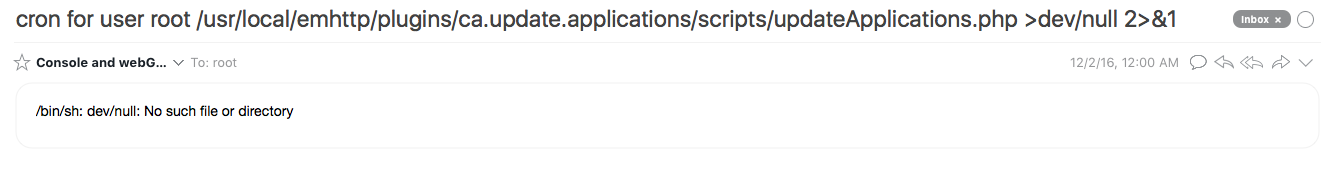

I'm getting emails from what looks like the CA Application  Auto Update:
Subject: cron for user root /usr/local/emhttp/plugins/ca.update.applications/scripts/updateApplications.php >dev/null 2>&1
Body: /bin/sh: dev/null: No such file or directory
I've never ... done anything to this plugin, not sure what I should do with this?
Has anyone come across this?
I think everyone was hoping you would think to look back a few days!  ;)  You know you really should read a little bit before posting.
Thanks for the hint! Hope that solves it.

Community Applications Auto Update, Plugin Section.  Make a change to the schedule, any change and apply it.  Problem will disappear
