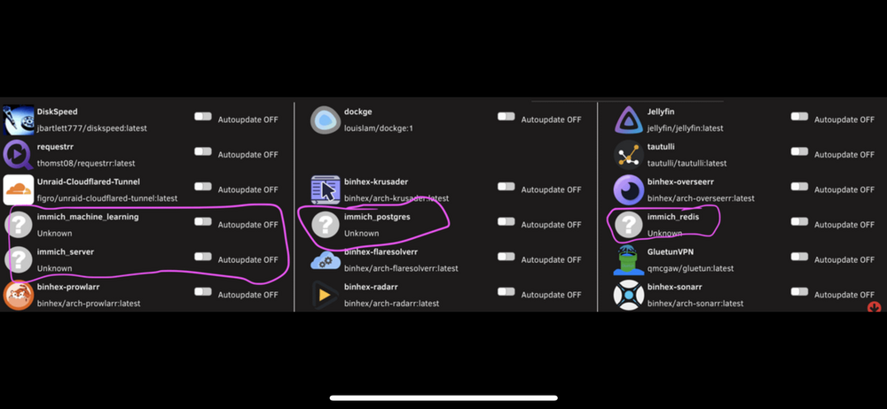

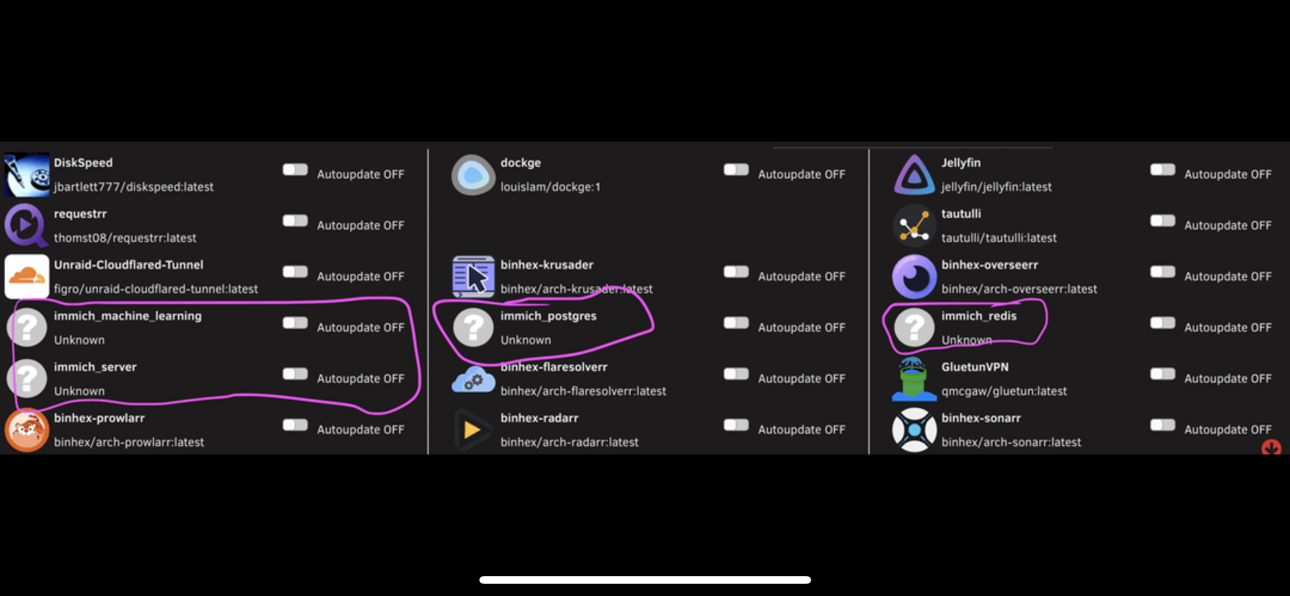

I have a bit of an issue going on. I’m not sure if it’s this plugin, or just that the plugin is seeing a different problem.
I had immich installed via compose. It was a stack. I deleted the stack. I also cleared out the app data folders associated with it.
But every day when I get the discord notification from the auto update plugin, it has these immich containers needing to be updated. These containers have been deleted.
5 hours ago, Wonka88 said:
Any idea how to fix?
Have you deleted the dangling images after removing the stack? When you compose down it removes the containers but the images stay there until you remove them.
I have a weekly scheduled script to delete dangling images. I have also pruned unused volumes, and 20 other things suggested by Reddit and ChatGPT.

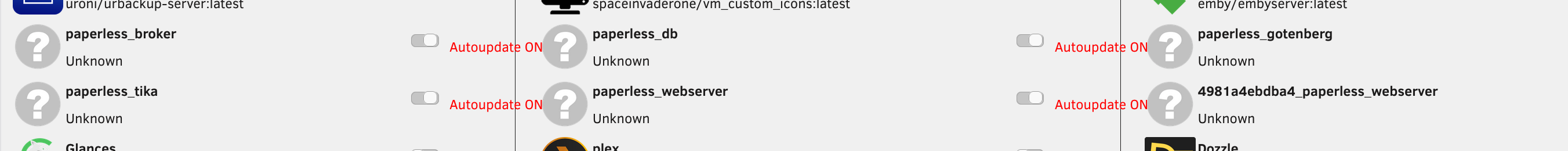

I had a stack in docker compose manager plugin but I deleted it a while ago.
No when I select to not update all docker containers in the Auto Update Applications plugin the docker apps I had previsously installed are shown as unknown. How can I remove them?
I already uninstalled and reinstalled the plugin.
Do those containers show up on the Docker page? If so you probably didn't down the stack before deleting it so the containers are still actually there and need to be removed manually.
Edited by Kilrah
No. None shown. They were deleted and then the stack was deleted. There is no trace of them anywhere (normal places) and they show up as unknown in the plugin.
I've read the plugins code and if I'm reading it correctly the problem is not the plugin it self, it is how the docker caching works.
The page is build on a foreach loop with the contents from the "getAllInfo();" function which is included by
/usr/local/emhttp/plugins/dynamix.docker.manager/include/DockerClient.php
The Function "getAllInfo" uses "getDockerContainers" which lastly returns the docker cache with this line:
if (is_array($this::$containersCache)) return $this::$containersCache;
To fix the wrong display on previously deleted containers you can just reboot your system to clear the cache
an untested alternative might be the the usage of following command:docker builder prune
Edited by purplehexagon
Rebooted and it fixed the issue. Thx for coming back on this

I had an issue with the plugin: updating non existing containers (cached),
Fixed the issue with Cursor, here is the gist of it hope it will help.
Issue Summary
The CA Update Applications plugin continues to track and report updates for Docker containers/images that no longer exist in Docker.
Root Cause
The issue is in the Dynamix Docker Manager plugin's cache system, which the CA Update Applications plugin relies on.
Cache File Location
text
/usr/local/emhttp/state/plugins/dynamix.docker.manager/docker.json
Problem
  1. When containers are removed from Docker, the cache file (docker.json) is not automatically cleaned
  2. The DockerTemplates->getAllInfo() function reads from this cached JSON file
  3. CA Update Applications plugin calls getAllInfo() and displays all entries, including orphaned ones
  4. This causes the plugin to show update notifications for containers that don't exist
Code Flow
  1. CA Update Applications plugin calls: DockerTemplates->getAllInfo()
  2. getAllInfo() function (in /usr/local/emhttp/plugins/dynamix.docker.manager/include/DockerClient.php) reads from the cached JSON file
  3. The cache file is populated by DockerClient->getDockerContainers() but never validated against actual Docker containers
  4. When containers are removed, the cache entries remain
Affected Containers (Example)
In this case, 10 GitLab Runner containers were affected:
  • runner-ray-8hamr-project-1-concurrent-0-75caaa08324d5ae3-build
  • runner-ray-8hamr-project-1-concurrent-0-75caaa08324d5ae3-docker-0
  • runner-ray-8hamr-project-1-concurrent-0-75caaa08324d5ae3-predefined
  • vibrant_chatterjee
  • runner-ray-8hamr-project-1-concurrent-0-ba175883e44aa7ce-postgres-0
  • bold_goodall
  • runner-ray-8hamr-project-1-concurrent-0-18cf7434f7c65279-build
  • runner-ray-8hamr-project-1-concurrent-0-18cf7434f7c65279-docker-0
  • runner-ray-8hamr-project-1-concurrent-0-18cf7434f7c65279-predefined
  • sharp_galileo
Suggested Fix
The getAllInfo() function should:
  1. Validate cached entries - Check that each cached container entry still exists in Docker before returning it
  2. Auto-cleanup - Remove entries from cache when containers no longer exist
  3. Cache invalidation - Implement a mechanism to detect when containers are removed and invalidate/update the cache accordingly
Implementation Suggestion
In DockerClient.php, the getAllInfo() function should:
  • After loading from cache, cross-reference with getDockerContainers()
  • Remove any cached entries that don't exist in the current Docker container list
  • Save the cleaned cache back to disk
Workaround
Manually remove orphaned entries from the cache file:
bash
# Backup first
cp /usr/local/emhttp/state/plugins/dynamix.docker.manager/docker.json /usr/local/emhttp/state/plugins/dynamix.docker.manager/docker.json.backup
# Remove orphaned entries (using PHP)
php -r "\$data = json_decode(file_get_contents('/usr/local/emhttp/state/plugins/dynamix.docker.manager/docker.json'), true); \$current = []; exec('docker ps -a --format \"{{.Names}}\"', \$current); \$current = array_map('trim', \$current); foreach(\$data as \$key => \$value) { if(!in_array(\$key, \$current)) { unset(\$data[\$key]); } } file_put_contents('/usr/local/emhttp/state/plugins/dynamix.docker.manager/docker.json', json_encode(\$data, JSON_PRETTY_PRINT | JSON_UNESCAPED_SLASHES));"
Plugin Versions
  • CA Update Applications: 2024.03.17 (based on file timestamp)
  • Dynamix Docker Manager: (part of Unraid core)
Unraid Version
Linux 6.12.54-Unraid
