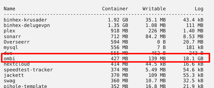

Anyone seeing very high disk IO with this container?  I have an issue with constant writes to the cache drive. In 13 days my cache drive has over 81 million writes..  I'm afraid my cache disk will die on me long before it's supposed to if this keeps going on. I used the file activity plugin to log whats happening and I've included the output in the txt file. Keep in mind this is just 1 hour worth. So Imagine this all day, every day, 24/7...
This started when I replaced my cache disk one month ago, at least that's when I started noticing the very high write count. Before I nuke my docker Image and try again I thought I ask here if anyone else is seeing this?
ombi.txt
Looking at your log the container is messed up and the scheduler cannot properly create the db file.  that's me trying to say it plainly. I personally would nuke the container and rebuild it.
Yeah,I thought so. Thanks for confirming :)

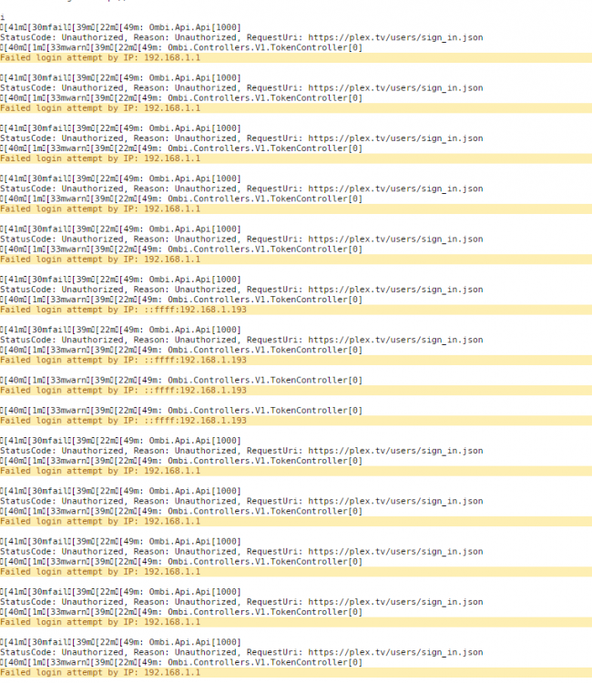

Just a quick question. I have recently changed my plex password and with that the plex authorization token has changed. Now ive gone to ombi to try update this but for some reason it just wont work. When i go through the motion of changing it and then pressing the load servers and select my server it automatically put the old auth token back in. I have tried deleting the server in full and starting that from scratch but no joy. As a result i keep getting an error when trying to load the libraries and testing the connectivity.
I have found it best to input the username and password and press get token.  pasting the token and then trying anything tends to use a cached version from itself or the browser.
I dont see a get token option on my list for plex anyway. And no matter what i do it just always reverts to the cached token atm.

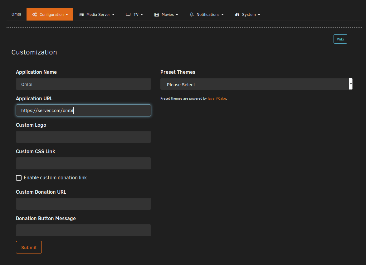

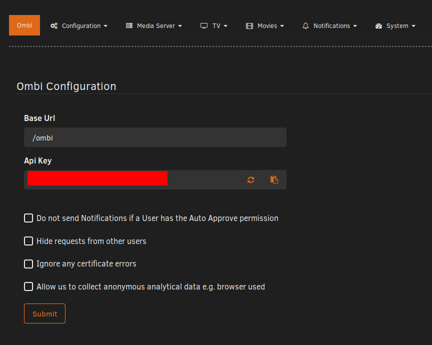

And you've changed the root URL in the webui?   Other thing to try is a different browser, or a browser cache/cookie clear.
oh you little beauty!
i thought i just had to put it in your 2nd screenshot, and that it just had to be /ombi
i didn't even see the ombi tab (1st screenshot)
thank you again for your time and patience ?
There doesn't seem to be any standardisation between apps! very confusing for my old brain...
