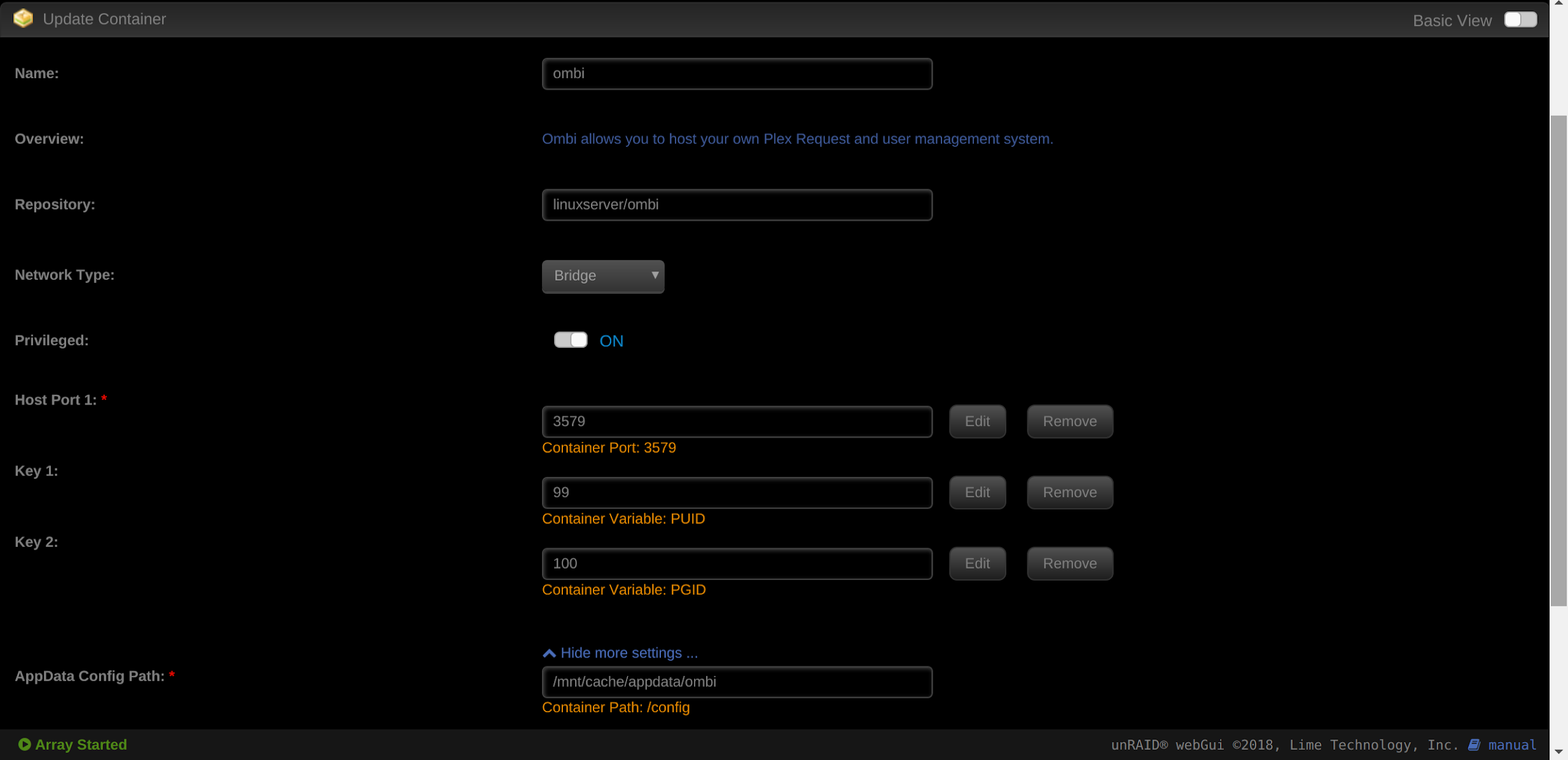

The issue is still apparent when using bridge for me as well. I've tried updating, restarting and reinstalling. I also deleted my entire docker.img file, and re-downloaded and setup all of my docker applications and this issue is still occurring. Here is my current configuration:
Edited by texasrngrnorris
