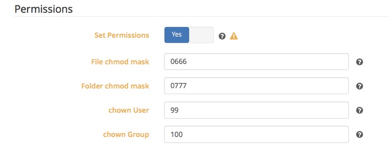

Think I've finally figured out why my permissions keep getting screwed up. Every time radarr imports a movie it changes the perms for the folder. Not sure what setting to use?
This is the current setting. Also tried chown User = nobody chown Group = users (that worked sometimes) and Set Permissions = No (that was a total failure). Does this look correct?
this is more a question about radarr than the docker container, so you probably would be best asking on the radarr forum/github, but i guess you could simply switch set permissions to no?, the umask settings i apply should then not be stamped over, having said that permissions of 666, should give you read and write for user, group, and other so that should be ok, change file permissions to 0777 if you want to allow execute as well.
Thanks. Tried setting the switch to NO and wound up with no access at all to all the folders that radarr had written for each movie. Right now I am using-
File chmod mask = 0666
Folder chmod mask = 0777
chown User = nobody
chown Group = users
These settings seem to work best, but something keeps changing permissions on my cache drive.
I'm still testing <fingers crossed> but it appears this is all caused by the way I was connecting to the share on my Mac. The SMB settings for the share were originally "Private" and I was connecting with user credentials. I've still got more reading to do, but it looks like this sets special permissions. I changed the SMB shares to public (they're just a bunch of videos anyway :)) with OS X support enabled and connect as guest and now have default (nobody/users) permissions.
