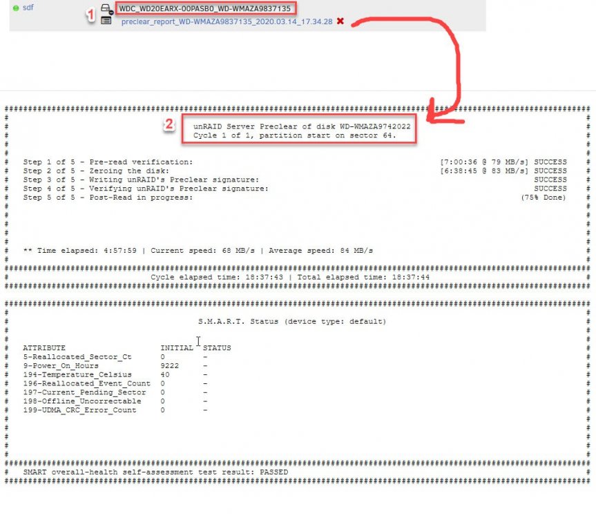

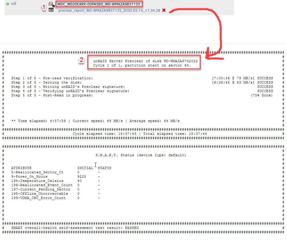

My hard disk, WD green serial No. WMAZA 9837135 indicated it has finished preclear successfully.
But if I click on the link for seeing the report, it shows another WD green HDD.
It shows WMAZA 9742022? Why this happening?
It is bug within preclear?
Actually  WD green serial No. WMAZA 9742022 is still hasn't finished preclear.
See the bottom last picture attached.

2 hours ago, gfjardim said:
@wepee, please close all your browser windows and tabs and try it again. Let's try to replicate it.
I have closed my firefox browser and restarted again, log into my unraid server,
click on the preclear icon, and then click the same hard disk,
WD green serial No. WMAZA 9837135, no luck, no change, same issue.
Next step, I am going to restart my unraid server and see, before
that I need to wait for the preclear operation to finish the last HDD,
up till 90% at Post-read phase.
Edited by wepee

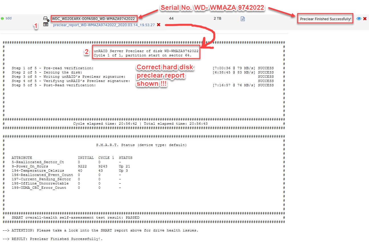

After a few hours, WD green serial No. WMAZA 9742022 has finished preclear.
Its preclear report shown the correct hdd with correct serial no. that is WMAZA 9742022
I've looked the code and I see no obvious way this is happening. It filters the report from /boot/preclear_reports using disk short serial number, and that value you see in the link it's the file base name without the extension. I've tried and couldn't replicate it too....
