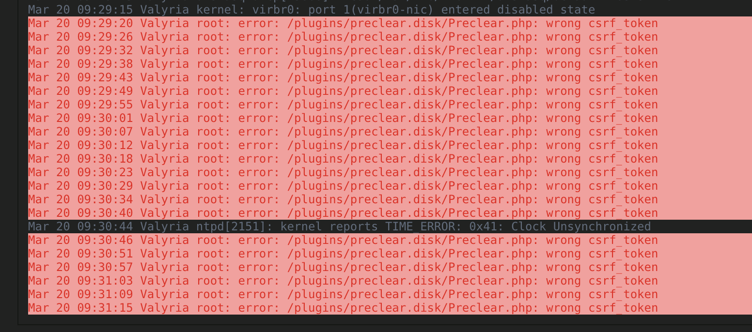

@gfjardim I am currently on the 2020.03.14a version of the plug in. And my log it littered with this error every 6 seconds. I am not actually using the Pre-Clear at the moment.
1408086543_ScreenShot2020-03-20at9_33_02AM.thumb.png.2ba486e2d325d8cc6a902972b0d1c339.png
