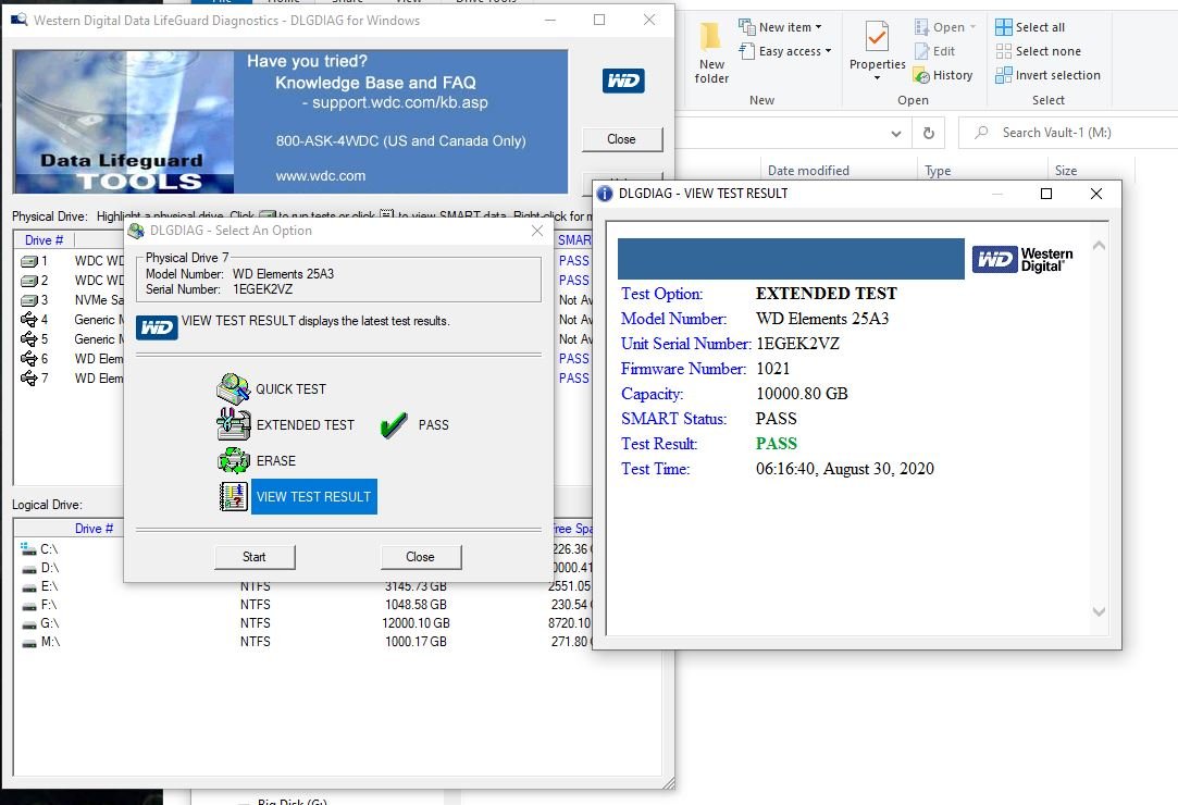

Shucked a 10 TB WD100EMAZ from a WD Easystore from Best Buy.  I tried to run pre-clear and it failed 50% in.  I put the drive back into the case attached it to my PC and ran the WD Lifeguard extended diagnostics test (13 hours) and it passed.  So I tried again and this time pre-read failed at 30% in.  The log shows that the dd command failed to open the drive. (log attached).
I used pre-clear on an identical disk 6 months ago and it worked fine.  Can someone tell me if this disk is bad or is my system starting to get flaky?  It has been rock solid for over 9 years (with new disks and Unraid updates).
Thanks.
preclear_log.txt

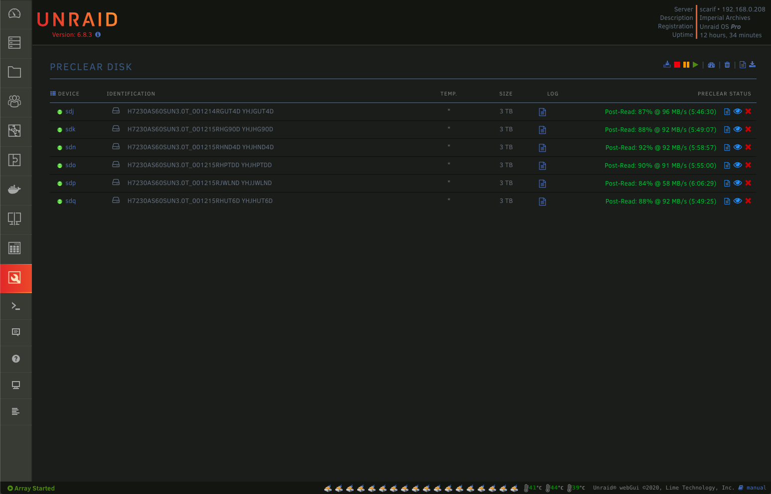

I am currently preclearing 4 x 18tb WD Gold hdds.
I have noticed that one drive is 52 minutes slower on the preclear stage than all of the other drives. Is there anything to worry about?

On 7/25/2020 at 3:49 PM, amiskell said:
Is anyone seeing an issue with the preclear plugin were it repeatedly puts the preclear icons on the footer of the page?
Whenever I run a preclear on a drive, it just keeps adding the icons at the bottom of the footer over and over.
2037316661_ScreenShot2020-07-25at1_48_26PM.thumb.png.0bff612554dac4c422db13be17065770.png
Thanks for reporting, I'll investigate and submit a fix soon.
Thanks.
Your drive seems ok, there is a script error somewhere I need to patch.
On 9/11/2020 at 4:17 AM, JorgeB said:
It's likely checking for trim support, WD SMR drives report they do, if that's true plugin could check if the drive is non rotational instead.
Yep, that's it. It will check for the rotational status instead of discard availability in the next version.

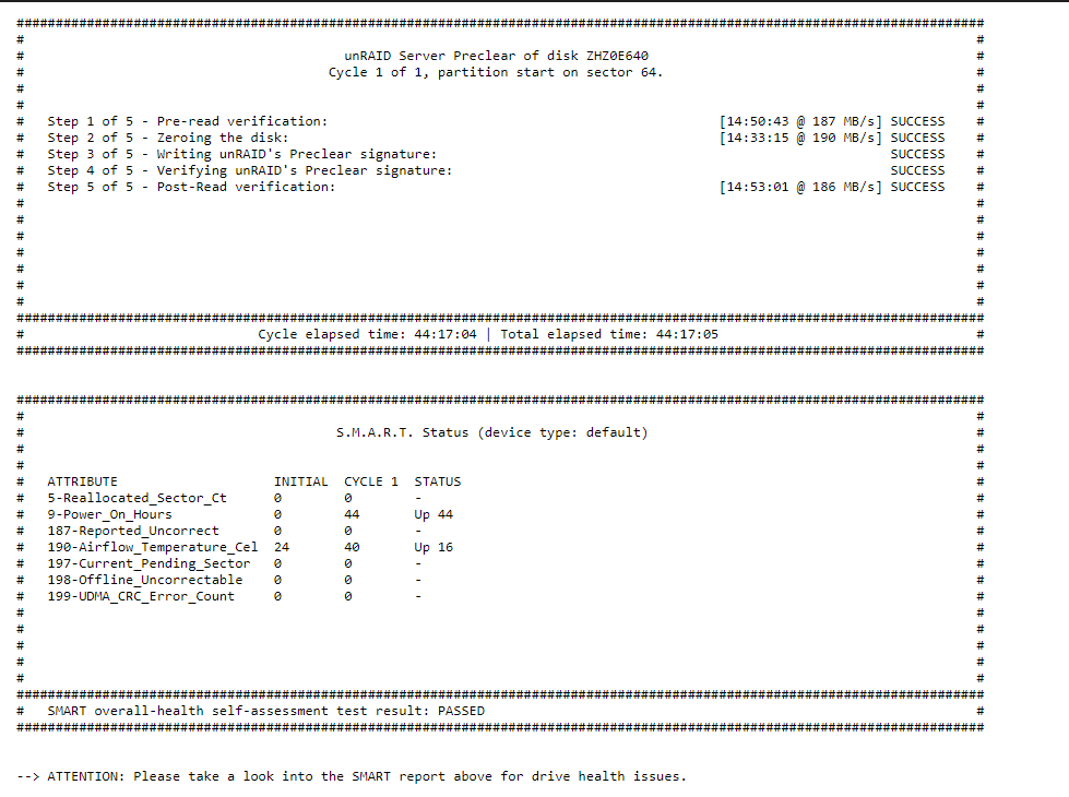

Hello everyone,
I just preclear one of my HDD ( Seagate IronWolf 10TB ST10000VN0008 ) and I got some errors:

But the SMART is telling me that there are no errors:
This HDD is good or not ?
Looks more like a connection problem, but the full SMART report might give a better idea.

SMART overall-health self-assessment test result: PASSED
General SMART Values:
Offline data collection status:  (0x82) Offline data collection activity
                                        was completed without error.
                                        Auto Offline Data Collection: Enabled.
Self-test execution status:      (   0) The previous self-test routine completed
                                        without error or no self-test has ever
                                        been run.
Total time to complete Offline
data collection:                (  567) seconds.
capabilities:                    (0x7b) SMART execute Offline immediate.
                                        Auto Offline data collection on/off support.
                                        Suspend Offline collection upon new
                                        command.
                                        Offline surface scan supported.
                                        Self-test supported.
                                        Conveyance Self-test supported.
                                        Selective Self-test supported.
SMART capabilities:            (0x0003) Saves SMART data before entering
                                        power-saving mode.
                                        Supports SMART auto save timer.
Error logging capability:        (0x01) Error logging supported.
                                        General Purpose Logging supported.
Short self-test routine
recommended polling time:        (   1) minutes.
Extended self-test routine
recommended polling time:        ( 976) minutes.
Conveyance self-test routine
recommended polling time:        (   2) minutes.
SCT capabilities:              (0x50bd) SCT Status supported.
                                        SCT Error Recovery Control supported.
                                        SCT Feature Control supported.
                                        SCT Data Table supported.
SMART Attributes Data Structure revision number: 10
Vendor Specific SMART Attributes with Thresholds:
ID# ATTRIBUTE_NAME          FLAG     VALUE WORST THRESH TYPE      UPDATED  WHEN_FAILED RAW_VALUE
  1 Raw_Read_Error_Rate     0x000f   083   066   044    Pre-fail  Always       -       181010104
  3 Spin_Up_Time            0x0003   097   097   000    Pre-fail  Always       -       0
  4 Start_Stop_Count        0x0032   100   100   020    Old_age   Always       -       2
  5 Reallocated_Sector_Ct   0x0033   100   100   010    Pre-fail  Always       -       0
  7 Seek_Error_Rate         0x000f   073   060   045    Pre-fail  Always       -       17920743
  9 Power_On_Hours          0x0032   100   100   000    Old_age   Always       -       45
 10 Spin_Retry_Count        0x0013   100   100   097    Pre-fail  Always       -       0
 12 Power_Cycle_Count       0x0032   100   100   020    Old_age   Always       -       2
 18 Unknown_Attribute       0x000b   100   100   050    Pre-fail  Always       -       0
187 Reported_Uncorrect      0x0032   100   100   000    Old_age   Always       -       0
188 Command_Timeout         0x0032   100   100   000    Old_age   Always       -       0
190 Airflow_Temperature_Cel 0x0022   067   049   040    Old_age   Always       -       33 (Min/Max 23/48)
192 Power-Off_Retract_Count 0x0032   100   100   000    Old_age   Always       -       1
193 Load_Cycle_Count        0x0032   100   100   000    Old_age   Always       -       8
194 Temperature_Celsius     0x0022   033   048   000    Old_age   Always       -       33 (0 23 0 0 0)
195 Hardware_ECC_Recovered  0x001a   083   066   000    Old_age   Always       -       181010104
197 Current_Pending_Sector  0x0012   100   100   000    Old_age   Always       -       0
198 Offline_Uncorrectable   0x0010   100   100   000    Old_age   Offline      -       0
199 UDMA_CRC_Error_Count    0x003e   200   200   000    Old_age   Always       -       0
200 Multi_Zone_Error_Rate   0x0023   100   100   001    Pre-fail  Always       -       0
240 Head_Flying_Hours       0x0000   100   253   000    Old_age   Offline      -       44 (73 169 0)
241 Total_LBAs_Written      0x0000   100   253   000    Old_age   Offline      -       19532873744
242 Total_LBAs_Read         0x0000   100   253   000    Old_age   Offline      -       39066002256
SMART Error Log Version: 1
No Errors Logged
SMART Self-test log structure revision number 1
Num  Test_Description    Status                  Remaining  LifeTime(hours)  LBA_of_first_error
# 1  Short offline       Completed without error       00%        44         -
SMART Selective self-test log data structure revision number 1
 SPAN  MIN_LBA  MAX_LBA  CURRENT_TEST_STATUS
    1        0        0  Not_testing
    2        0        0  Not_testing
    3        0        0  Not_testing
    4        0        0  Not_testing
    5        0        0  Not_testing
Selective self-test flags (0x0):
  After scanning selected spans, do NOT read-scan remainder of disk.
If Selective self-test is pending on power-up, resume after 0 minute delay.
That's probably the cause, no media errors and no SMART errors shown. Take a look into your SATA and power cable connectors.
Thank you for your replies. At the moment I have a second HDD in preclearing, but after that I will change the cables and I post again if I have issues or not.
You don't need to wait, just stop the running preclean, change cables and resume the running instance.
