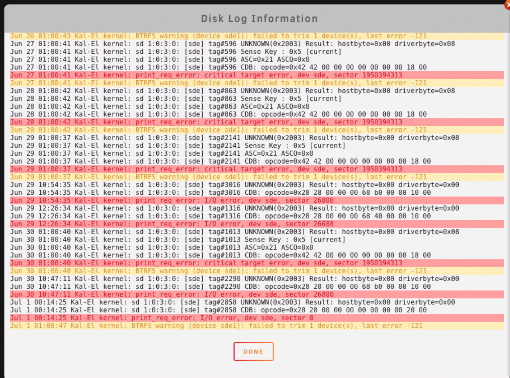

well it looks like i won't be alone in posting a question about what my error logs mean here, haha!
On a dell R720, i added an unassigned SSD a while back that was showing this error here1898999316_ScreenShot2020-07-01at1_26_25PM.thumb.png.62d7051fcc00ba084e9a5b4f6f29ed3d.png
I posted about it in the UAD forum, and somebody advised that it looked like maybe a bad cable since the disk SMART report came back good. However, yesterday i went to preclear a 10tb SAS drive, low hours, clean SMART report, and started getting errors trying to clear it. it would run for about 3 minutes, then stop and actually say completed successfully, but definitely not. i've attached the preclear log txt for that disk. I left the disk in the server, but not mounted or anything - with nothing in process on the disk, and my syslog is completely full today. Disk log looks like this:

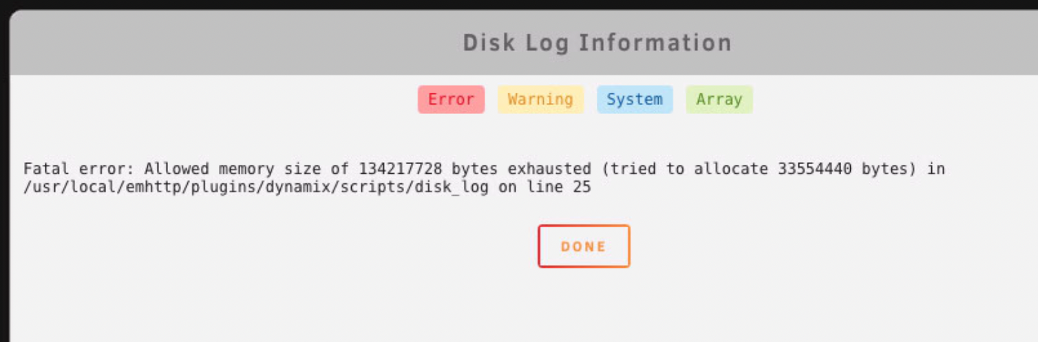

910239210_ScreenShot2020-07-01at1_19_17PM.thumb.png.8e6d66d03373a6df5c0dc431ff748f6c.png
Preclear log was showing i/o errors on the new SAS disk too, which has me wondering if this is in fact either a problem with my backplane, sas cables, or both. These two disks are on the same column of the backplane, using the same sas cable connection, so it seems likely to me, but sure would love to have a 2nd or 3rd opinion before i start replacing more hardware. (syslog diagnostics also posted just in case)
