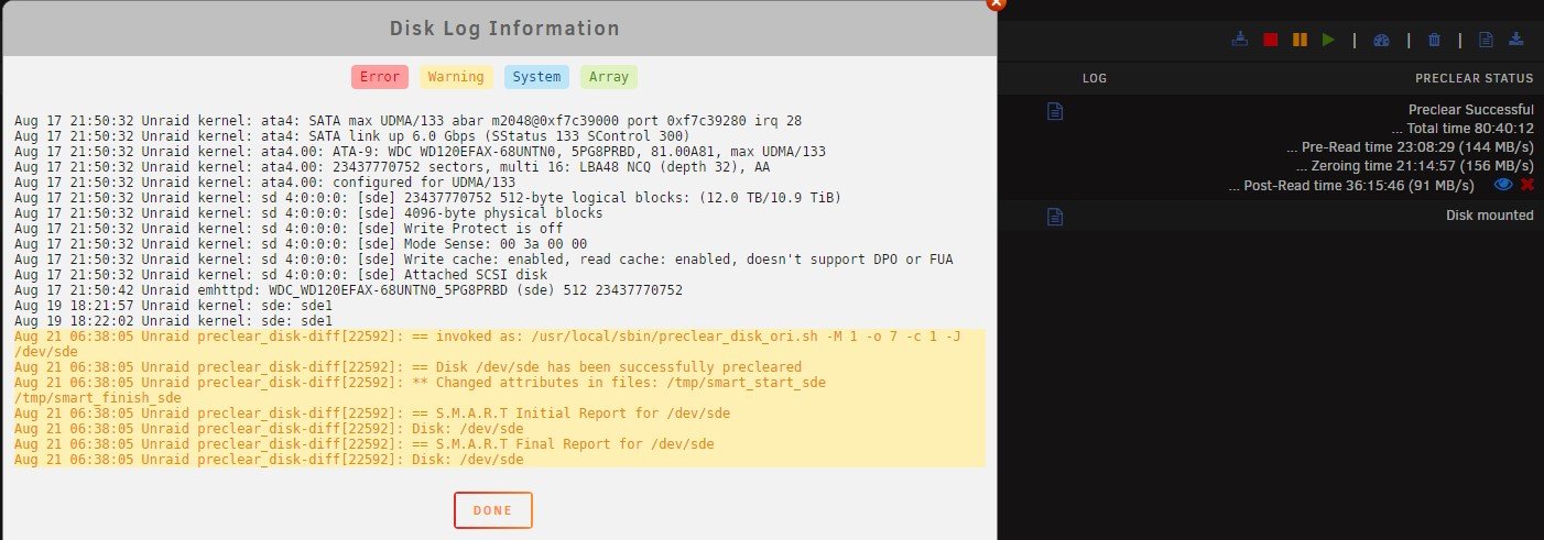

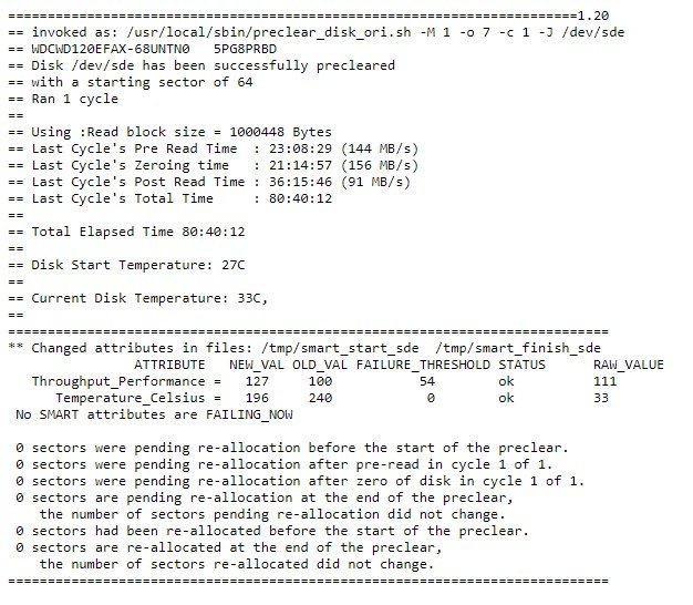

I have a question in regards to a Preclear using the Joe. L 1.20 script on my WD Red 12tb hard drive.
It took 80hrs 40mins 12 secs to complete 1 cycle.
Is this normal?
Is there something wrong with my drive, since I see the Post-Read average was only 91 MB/s.
When I precleared a WD Red Pro 12tb hard drive using the gfjardim 1.0.16 script, it only took just over 36hrs.
I understand that the Pro drive is a 7200rpm drive, but it precleared in half the time of the 5400rpm Red drive.
I'm currently running Unraid 6.8.3 Stable and Preclear Plugin - gfjardim version 2020.05.07

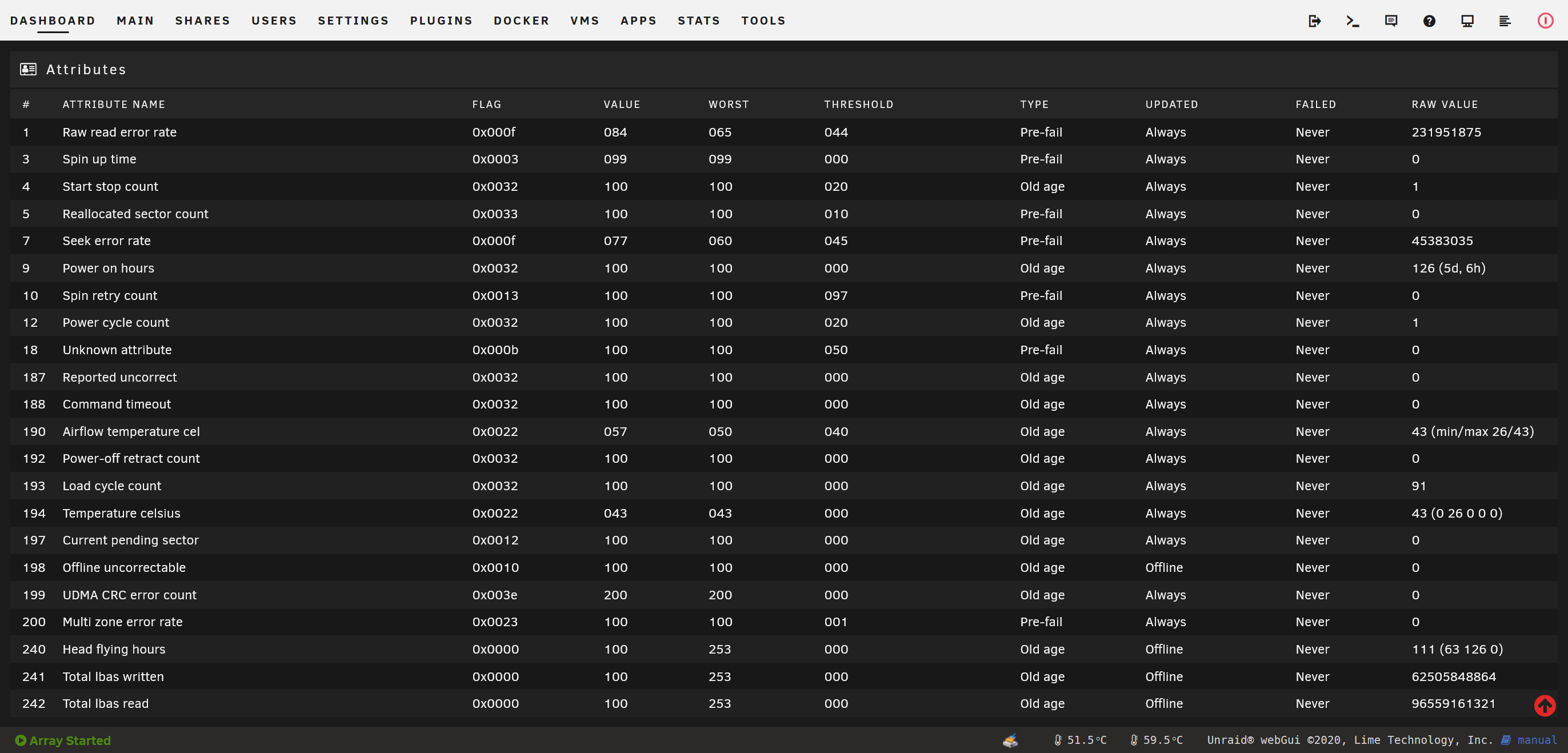

hi all ran pre clear on new 3TB ironwolf drive.
Pre clear finished without errors but it said some attributes near thresh. For some reason the log was not saved but below is SMART attributes. Can someone please let me know if I should return the drive?
#	ATTRIBUTE NAME	FLAG	VALUE	WORST	THRESHOLD	TYPE	UPDATED	FAILED	RAW VALUE
1	Raw read error rate	0x000f	100	064	044	Pre-fail	Always	Never	0
3	Spin up time	0x0003	100	100	000	Pre-fail	Always	Never	0
4	Start stop count	0x0032	100	100	020	Old age	Always	Never	1
5	Reallocated sector count	0x0033	100	100	010	Pre-fail	Always	Never	0
7	Seek error rate	0x000f	070	060	045	Pre-fail	Always	Never	9331060
9	Power on hours	0x0032	100	100	000	Old age	Always	Never	28 (237 241 0)
10	Spin retry count	0x0013	100	100	097	Pre-fail	Always	Never	0
12	Power cycle count	0x0032	100	100	020	Old age	Always	Never	1
184	End-to-end error	0x0032	100	100	099	Old age	Always	Never	0
187	Reported uncorrect	0x0032	100	100	000	Old age	Always	Never	0
188	Command timeout	0x0032	100	100	000	Old age	Always	Never	0
189	High fly writes	0x003a	100	100	000	Old age	Always	Never	0
190	Airflow temperature cel	0x0022	063	062	040	Old age	Always	Never	37 (min/max 24/38)
191	G-sense error rate	0x0032	100	100	000	Old age	Always	Never	0
192	Power-off retract count	0x0032	100	100	000	Old age	Always	Never	1
193	Load cycle count	0x0032	100	100	000	Old age	Always	Never	4
194	Temperature celsius	0x0022	037	040	000	Old age	Always	Never	37 (0 24 0 0 0)
197	Current pending sector	0x0012	100	100	000	Old age	Always	Never	0
198	Offline uncorrectable	0x0010	100	100	000	Old age	Offline	Never	0
199	UDMA CRC error count	0x003e	200	200	000	Old age	Always	Never	0
240	Head flying hours	0x0000	100	253	000	Old age	Offline	Never	27 (194 154 0)
241	Total lbas written	0x0000	100	253	000	Old age	Offline	Never	10077912400
242	Total lbas read	0x0000	100	253	000	Old age	Offline	Never	17919685090
