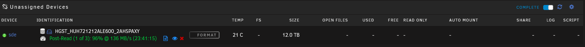

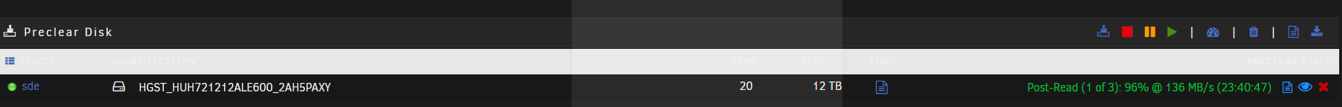

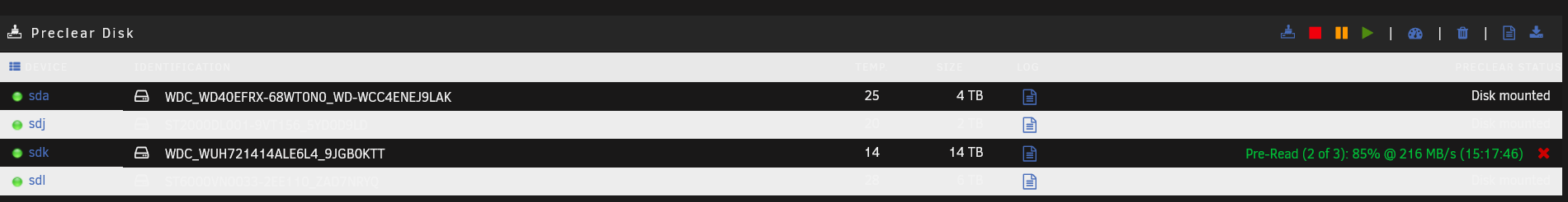

I'm preclearing a brand new drive 8TB WD drive and only getting 70MB/s in Step 1:
However, same Drive model (different physical drive) I did a few weeks ago (pre-6.8.0/1 upgrade), I was getting 150MB/s.
I was getting division by zero error and other problems today but upgraded to latest plugin and restarted.
I don't think drive speed calculation is right though.

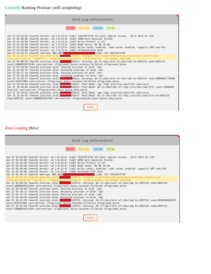

I have put 2 10TB SAS drives for Preclear. They both reach 99% and then restart the zeroing process.
They finish the pre-read part but never get to the post read part, because they keep restarting the zeroing process.
What could be the problem?

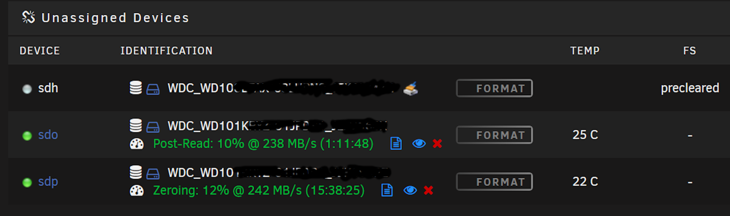

Hello -
Having same issue of continuous "Zeroing" while pre-clearing a drive(s) - see attached logs.
Notes:
- had to pause process and sping down array for network issue. started array and preclear resumed as expected.
- two - 10Tb WD sata drives (internal, not USB)
- both drive preclear operations started at the same time
- watched first drive switch from Zeroing to Post-read (NOTE: first drive initially showed it was starting the Zeroing process again, but then flipped to Post-read and continues to run correctly. Also, noted the following message "unraids signature on the master boot record is valid" when the first Zeroing finished and it started teh Post-read)
- watched second drive finish first Zeroing process and start Zeroing all over again - stopped the process on this drive for now and pending feedback
Any further thoughts on this? @gfjardim?
Thanks!

I dunno if you guys resolved it but I mentioned it before but no fix  and last few unraid builds still doesn't work..  how do you fix  preclear  to PREVIEW
it works for a while  but then  after a while  it looses the option to PREVIEW and only offers a X      if you goto the preclear  it also doesn't  show  it
you can see in pic 3-4  on my other server   its still able to preview.. but not on the 14tb drive
is there something I need to fix alter edit??
so not sure when ill loose the preview of 12TB  on the other server

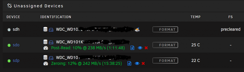

Good Day everyone,
I just built my first unraid system, trying to learn as much as i can, on forums, manual and youtube and especially this group when other post their problems.
I am tryin to preclear two 10tb HDD that i schucked from amazon. However, one of the drives is stuck at 99% Zero. Can someone assist?
I have two 10TB connected and a 860 1TB SSD attached. On the first HDD i started the preclear (JEK6GG5N) and two hrs after i started the preclear on the second disk (2YKB4R2D).
The second disk (2YKB4R2D) finished zeroing and post read before the first disk with preclear report. The first disk (JEK6GG5N) is stuck at zeroing 99% @101mb/s. I looked at the log, and saw that there is no line for exit "code" like the line for the second disk eg "Jan 31 11:49:53 preclear_disk_2YKB4R2D_1202: Zeroing: dd exit code - 0"
The last line i have for the first disk is "Jan 31 10:28:04 preclear_disk_JEK6GG5N_17552: Zeroing: dd - wrote 10000831348736 of 10000831348736."
I tried pausing the pausing all sessions and resuming but nothing changed.
What should i do?
Thanks again in advance to who ever responds :)
