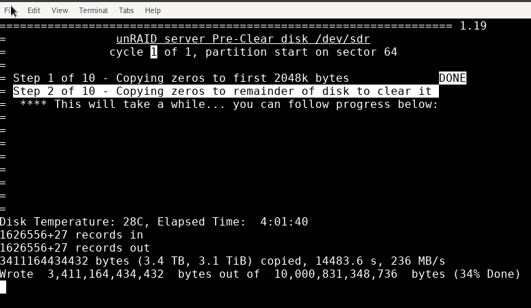

I'm 10hrs into the Pre-Read with the Docker version on my drive so in about 18 hours I'll let you know 🙂
1 hour ago, BRiT said:
So just have to wait another 40 or so hours to see reports from the first pass? 😎
I am also running the docker now.  10TB will take a while :D

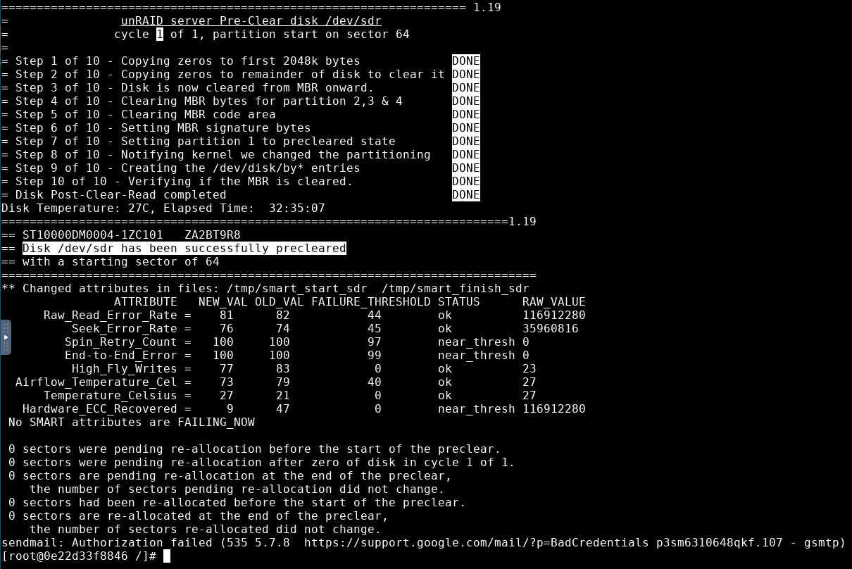

my 3TB just finished and succeeded!
Although when i added it to my array its now clearing it again?
My 10TB cleared successfully using the Docker plugin.
I also just ran the Enable Testing (just for debugging) option with the latest Plugin (2019.11.27) and it finished fine.
Thanks @gfjardim !
