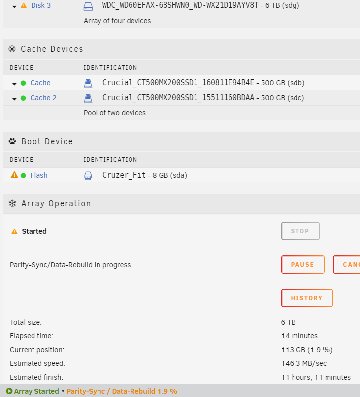

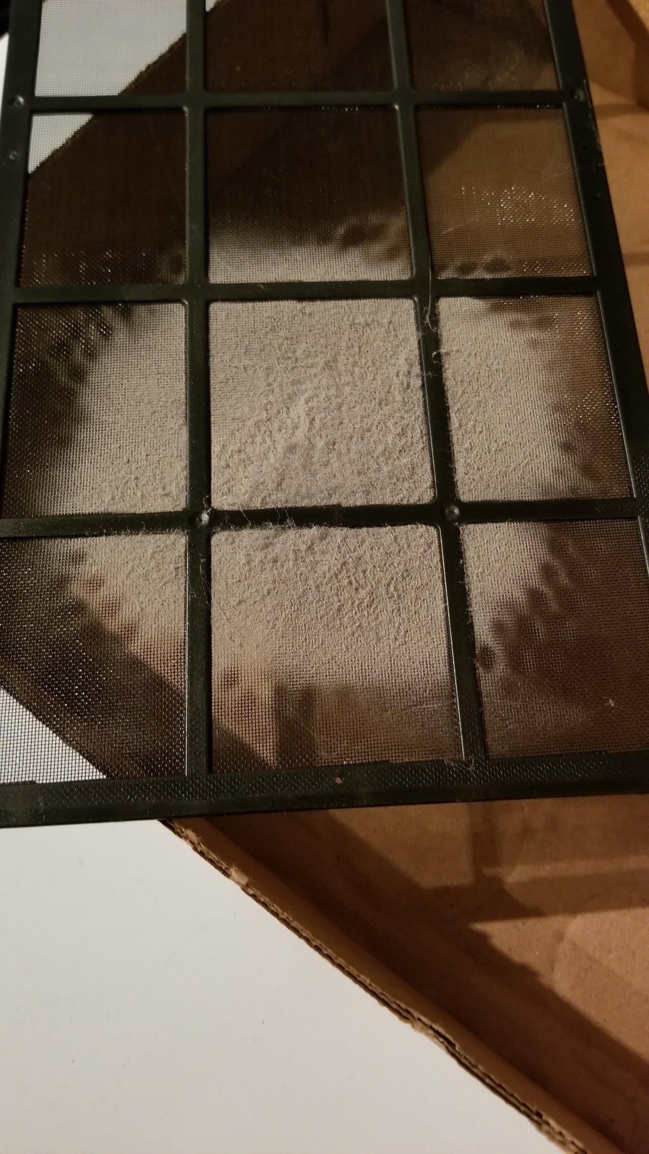

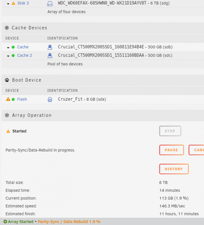

Swapped the drive, changed the SATA cable just incase.  Oh that orange triangle on the Flash Drive, I fixed that, must of shared at one time, now no share.
Some dust on the bottom intake filter.
