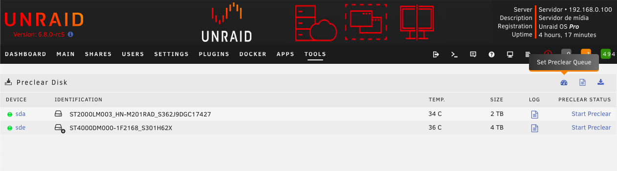

On 11/14/2019 at 6:04 PM, Nortrek said:
Hi, great app.
I plan to sell my server, so to clear the disk for the next user i plan to zero them out.
Am i correct if the fastest way is to use the "Erase All disk" option, then enable the "Skip Pre-Read" and Skip Post-Read" ?
Is that the fastest way to erase them so nothing can be recovered ?
Edit: my server has 8gb of ram, how many disk can i clear at the same time ?
Thank you in advance for the help.
It's the fastest way, yes.
You can start as many as you like and let the Preclear Queue handle it for you. Go to Server>Tools>Preclear and set the Queue Limit by pressing the correlated icon:
