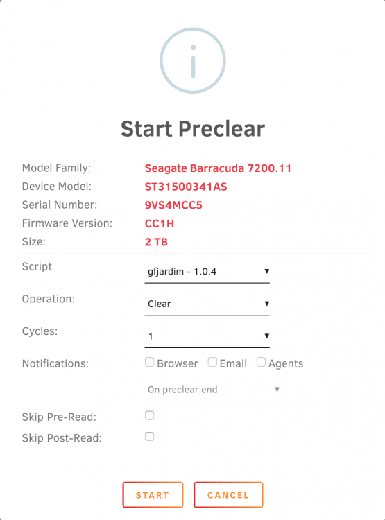

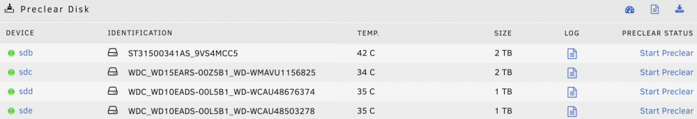

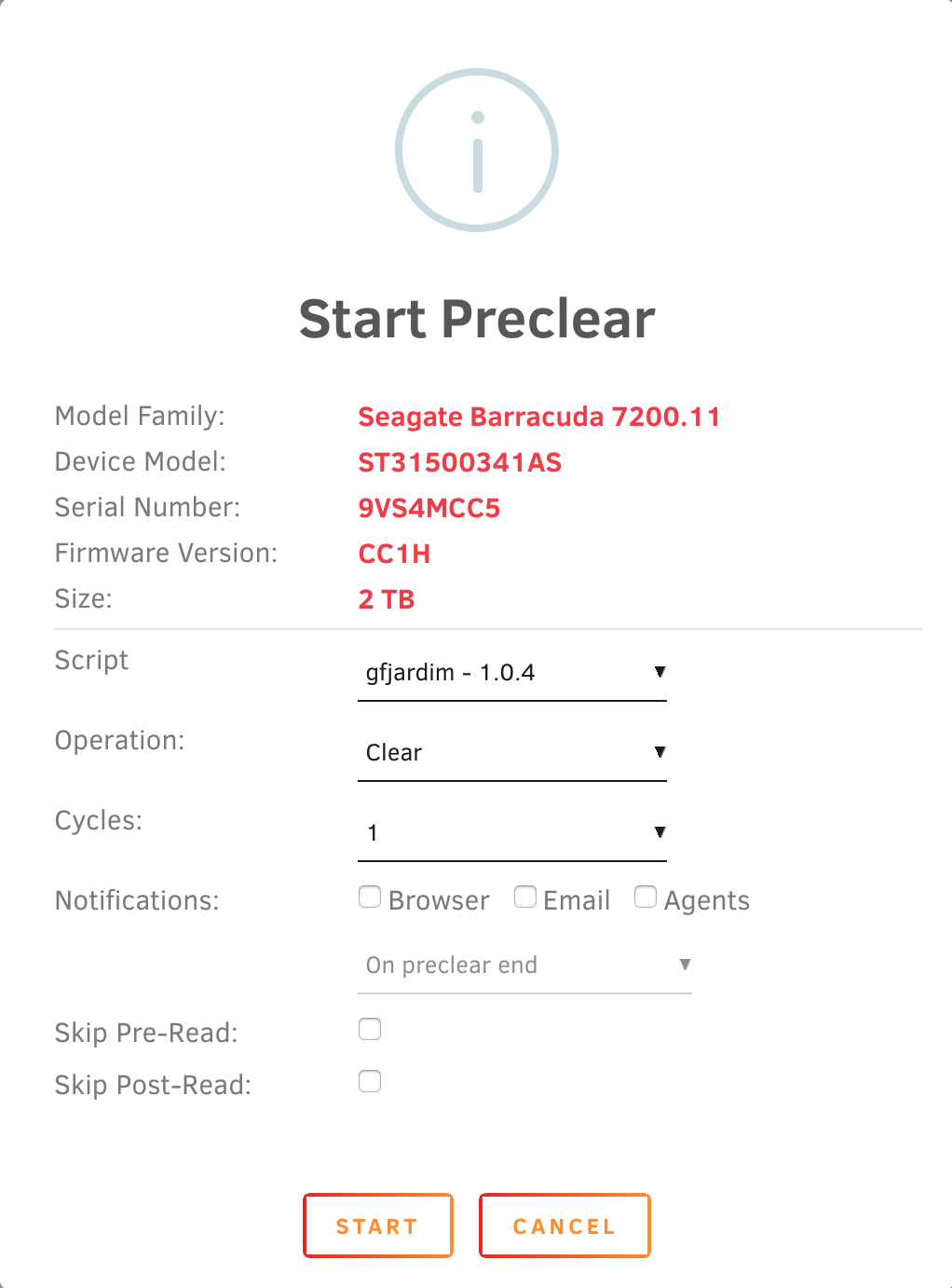

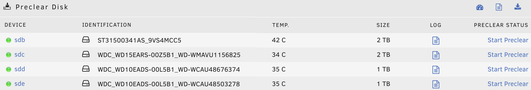

Hey!
I've set up a test unraid server with some older disk I want to preclear. Two 1.5 TB disks and two 1 TB disk. The preclear plugin recognizes the two 1.5 TB disks as 2 TB disks O.o
705508494_Bildschirmfoto2019-08-13um16_40_16.thumb.png.7c4805b051e61eceb1ba712738cff272.png
962267783_Bildschirmfoto2019-08-13um16_41_13.thumb.png.ff9188c056d608ab4b92b66a3ad9baeb.png
Any ideas? It is a bug? Diagnostics attached.
