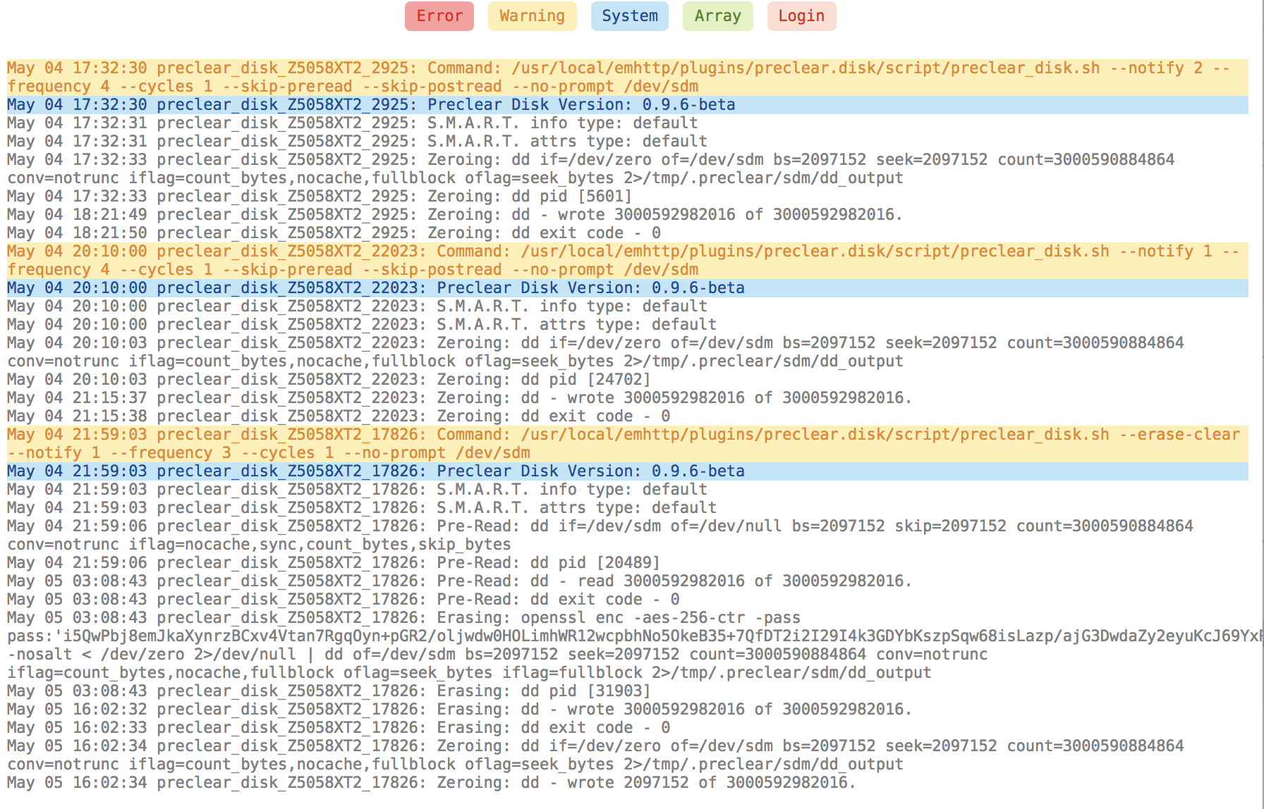

I have updated to the latest version of the plugin and I have had the same thing happen on a brand new drive 3 times.  The first two I skipped the extra parts and the last one I let it run through the whole thing.  It keeps disconnecting the drive, only accessible after I pull the drive and reseat.  Then it tells me that a signature was not valid.  At what point do I determine if this was a DOA drive or something up with the script or plugin?
Thanks
Thanks
JK
Some thoughts:
- You do not mention, but I am guessing that the disconnection happens  after preclear is completed. Otherwise the signature not being valid is expected since it is the last think that happens when preclearing. If the disconnection happens earlier, you will naturally not have a valid signature.
- Did you check the smart stats on the drive?
- The only solution I can think of, until someone more knowledgable chimes in, is to try another drive, if you have one.

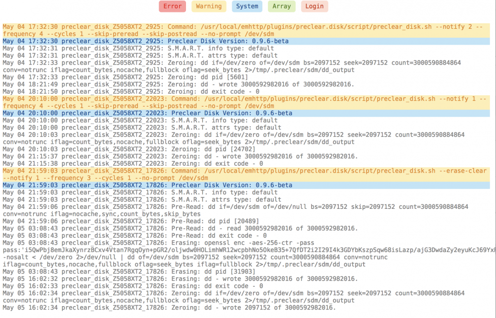

Thanks
JK
720225074_Screenshot2018-05-0520_39_10.thumb.png.d9836f56191835d2eb4b0228fce9198c.png
Please send me the whole previews plugin log, please.
