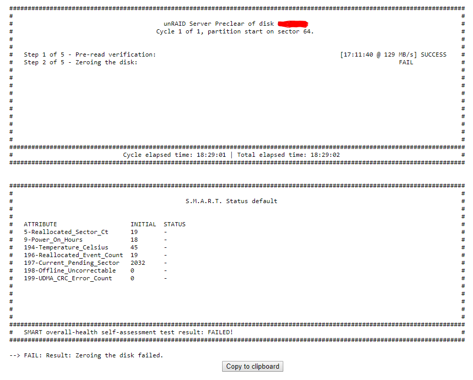

Hello All, this is the first time that I have tried to preclear a disk before adding it to my array. I'm assuming that I have a bad drive? I just bought it, 8TB WD Red Pro.
Take a look into the OP and send me both diagnostics file and preclear log.

2 minutes ago, trajpar said:
Should I try to run preclear again? Attached is my SMART report.
WDC_WD8001FFWX-68J1UN0_R6GGTG4Y-20180821-1832.txt
Nope, drive is certified bad:
=== START OF READ SMART DATA SECTION ===
SMART overall-health self-assessment test result: FAILED!
Drive failure expected in less than 24 hours. SAVE ALL DATA.
See vendor-specific Attribute list for failed Attributes.
ID# ATTRIBUTE_NAME          FLAGS    VALUE WORST THRESH FAIL RAW_VALUE
  1 Raw_Read_Error_Rate     PO-R--   097   097   016    -    7
  5 Reallocated_Sector_Ct   PO--CK   100   100   005    -    156
196 Reallocated_Event_Count -O--CK   100   100   000    -    156
197 Current_Pending_Sector  -O---K   100   100   000    -    7360
Crap. Thank you for the help!
