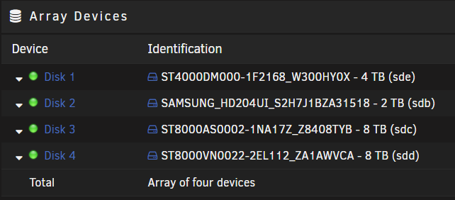

Hi, as im feeling i have alot more disk spinnups lately i try to figure what is the reason and may here someone has a hint cause im out of options ...
so i hoped i could figure something out about this plugin but may i missunderstand ...
as sample from the last ~ 3 hours
here from the logs when i started the plugin, as u see i get some spindownds (the disks where up between)

in Fileactivity all i see are the real done accesses (unassigned device, cache drive, ...)
File Activity
** Unassigned Devices
Oct 24 08:36:40 OPEN => /mnt/disks/Samsung_SSD_950_PRO_512GB_S2GMNCAGB16552X/kodi-18.0-Leia_beta4-x64.exe
Oct 24 08:36:41 OPEN => /mnt/disks/Samsung_SSD_950_PRO_512GB_S2GMNCAGB16552X/kodi-18.0-Leia_beta4-x64.exe
Oct 24 08:36:43 OPEN => /mnt/disks/Samsung_SSD_950_PRO_512GB_S2GMNCAGB16552X/kodi-18.0-Leia_beta4-x64.exe
** Cache
Oct 24 08:58:00 OPEN => /mnt/cache/Media/TVRIPS/Arrow/Season 06/Arrow (2012) - S06E12 - Pyrrhussieg.mkv
so to me its all good ... there shouldnt be any spinups for disk1 - 4
now when i take a look parallel in the open files plugin, i see i have some smbd listed
smbd    877 KILL    1    0    /mnt/cache
smbd    2032 KILL    1    0    /mnt/user/Media
smbd    15476 KILL    1    0    /mnt/user/Daten
smbd    19816 KILL    1    0    /mnt/disk1
smbd    22894 KILL    1    0    /mnt/user/isos
there are 0 /mnt/disk... or other /mnt/user... accesses wich could show a real access.
may possible to figure where the smbd accesses are exactly from ?
if thats the case my whole intense from cache drive is senseless, to me i keep actual "working" files or media in cache as long as possible
to keep the storage down (best only for move), but as all actual endpoints (Laptop, tv, kodi clients, ...) are using the mounts ... they pretty much are always
mounted, but then there should be 0 spindowns ? ;)
example, shield tv with kodi, needs the mount for accessing media.
so may i can get some light what im doing wrong or if thats by design ;)
thanks ahead and sorry if should be clear ...
current state from my disks
as u see (and i hear ;) ) all disks are spinning ...
Edited by alturismo
