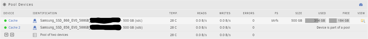

Well that's a quick turnaround!  Thanks!  I can confirm that it now skips over the missing disk2 and works fine unless I try to enable cache drives, in which case I'm getting the same error for `/mnt/cache2` now.  I do have two cache disks, but they're in a pool so there isn't a second mount point (assuming I haven't set this up weird (see screenshot below)).  I guess I should have looked more thoroughly at disks.ini and I might have seen that coming too.
Update and try again.
Perfect, it works great now; thanks for the quick fixes!🙂
